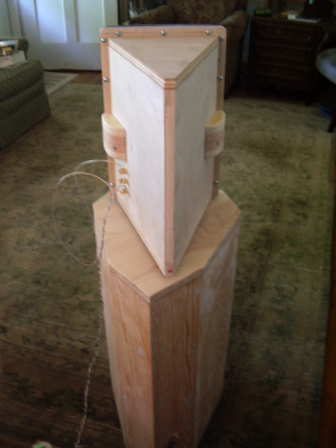

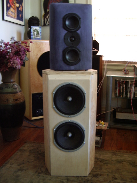

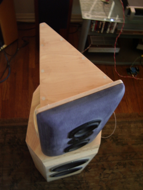

After two years of design and build, my speakers are mostly finished, using active xover between mids/highs and bass, with passive between mids and highs. I am using the ESP 24db/octave boards, populated with quality parts, including LM4562.
Although I'm quite happy with the dynamics and detail this arrangement affords, I don't entirely like how things have turned out. When run full-range, the mid/high speakers are open and clear, with delicate, extended, spacious highs and tonally truthful mids. With the same amps and xovers in the circuit, there is plenty of detail (almost too much), but the midrange seems fake, with kind of a shallow or hollow tonality. Some of that may be due to xover point/slope issues, and I think I can fix that. But the highs seem "flat" and somehow truncated, with no sign of life or openness, and that is NOT a slope or xover point problem.
In addition to the designed bypass caps, I have added ceramic caps soldered right across the power pins of each opamp. I don't think that's an issue.
I have read all the threads, here and elsewhere (spending many hours), that discuss opamp sonic characteristics, and I know there are lots of different opinions with no clear consensus. I wonder if anyone has found an ideal combination of opamps in this or a similar application. I am on a limited budget, so I can't just buy 8 OPA627's or discrete opamps, unless that is absolutely the only alternative to achieve good sound.
If I were to try a couple 627's, would they yield the best results as input buffer, output buffer, or in the filter section?
Any other opinions or suggestions? I'm more than a little frustrated after all this work and expense, and I would appreciate your help.
