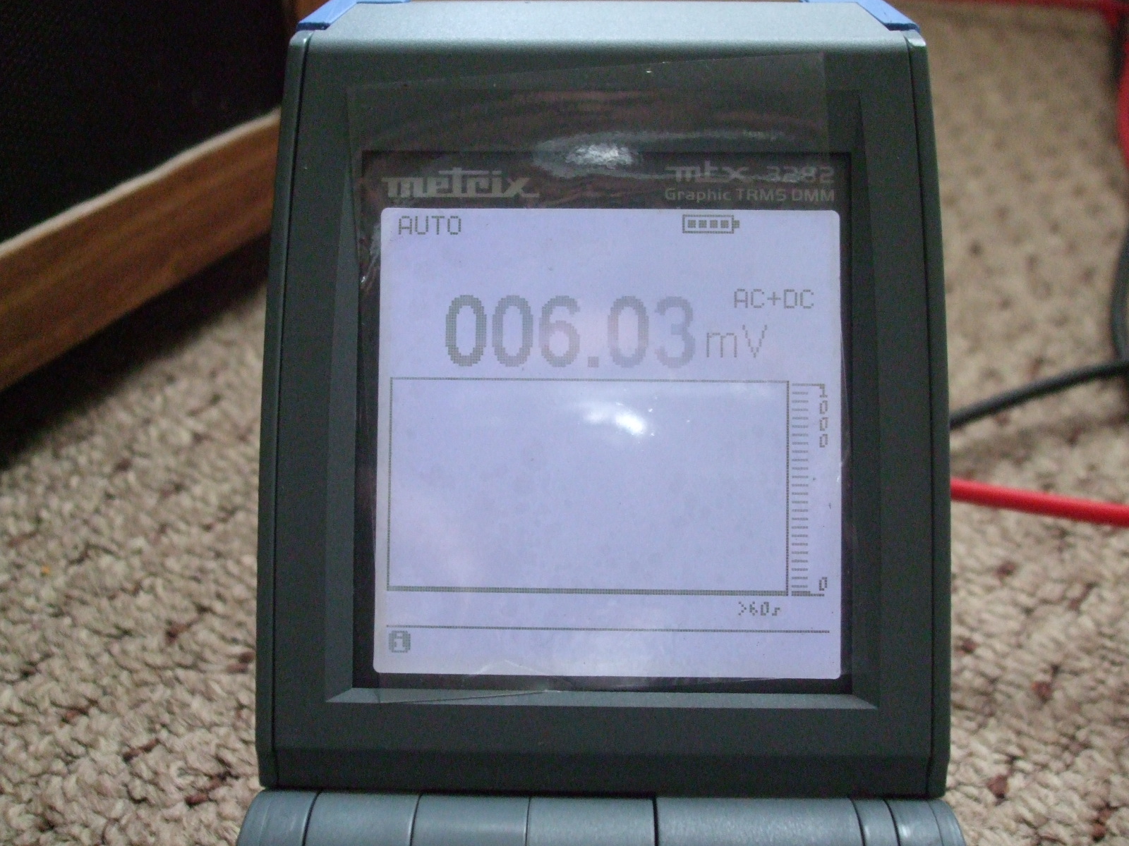

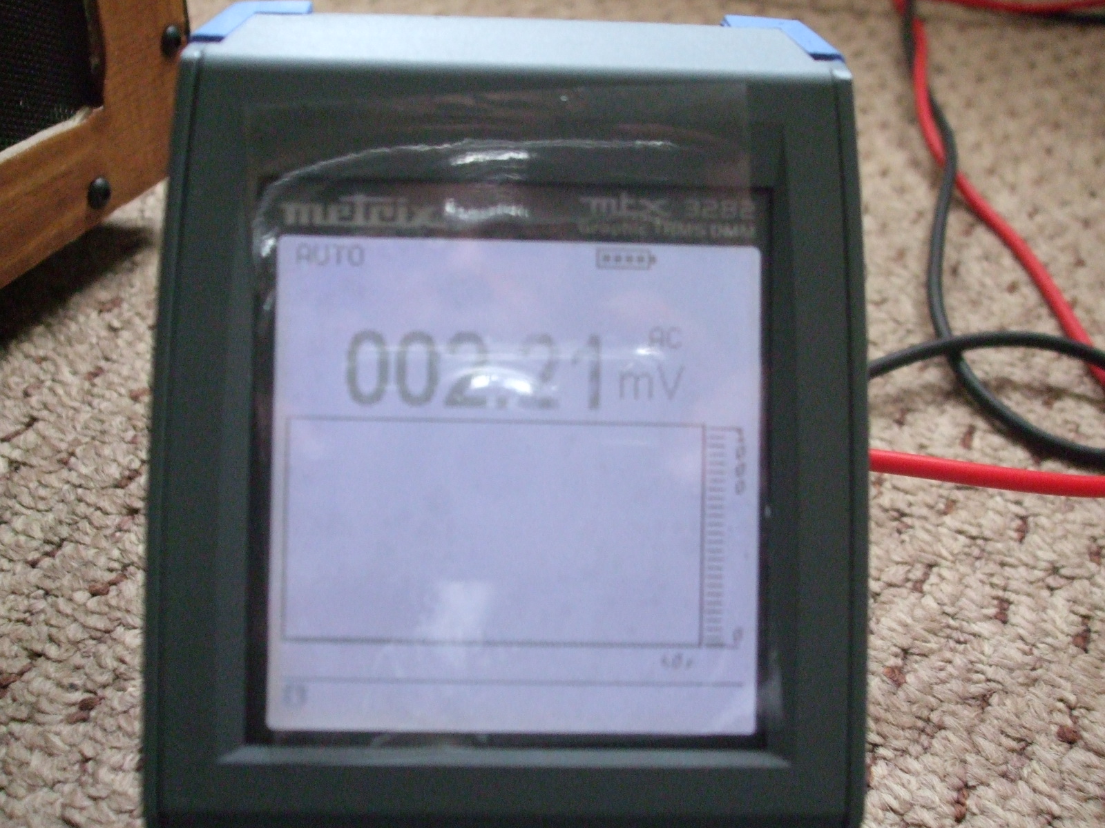

The case is pretty open and measurement fluctuate a bit maybe I could put the meter in survey mode and post a graph
7.14 mV DC it get down to about 2 when warm and it stays there this does not make any noise just shift the woofers a bit forward
2.21 mV AC this is noise but does not make really any noise the other amp I have brought from the shop is much worst.
And is still connected to the preamp that I still have at the moment (hint)
So really what noise?
Papa design don't make any
And I am pulling 3.5 A rail at 26 V on each channel.
All I can hear is the traffo buzzing away but is in hand and eventually it will go in it's own box till I turn the tap on a bit
