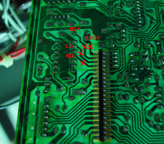

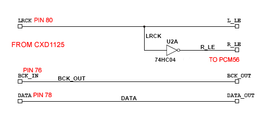

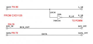

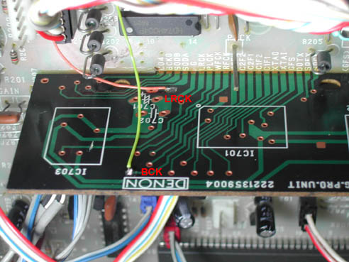

I made it!
It was easier than I thought: the CXD1125 output format is a 2's complement which will fit the PCM56 input, in fact the PCM56 doesn't work with i2s input format.
The connection is very simple:
CXD1125 PCM56
pin76 BCK pin5 CLK
pin80 LRCK pin6 LE
(should invert the LCRK for the other
channel)
pin78 DATA pin7 DATA
If anyone of you want to try, why not!!

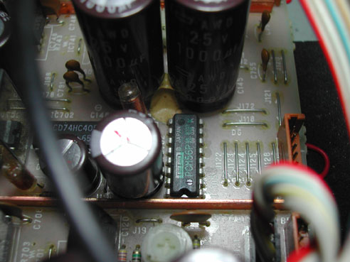

hi acid_k2,
since there are two identical PCM56Ks on the circuit board i just took picture of one.

hi wmincy , does your 1700 as a provision for MSB adjust from datasheet ?(on PCM56) . It seems not , that would be a way for upgrading the sound
hi guytou,
i own some Denon CD players including DCD1100, DCD1300, DCD1400, DCD1500, DCD1500MK2, DCD1700, only three of these models have PCM56 DAC: 1400, 1500MK2 and 1700. And all of them are MSB adjustable, you can see the white round trimmer in one of the photos i have taken.
Adjusting that trimmer will reduce the MSB linearity error, but will this make it sounds better i think it's not the main factor, what is for sure is the "K" type which is found inside the 1700 boasted of a lower harmonic distortion comparing with the other models.
However a clean power supply, good quality caps, re-clocking circuit, tube output will indeed raise the sound level to a higher standard.
