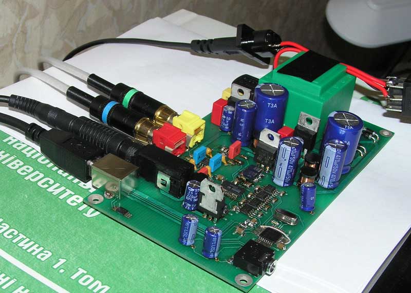

Maybe you'll be interested in my device. It is USB1.1 soud card with the following features:
- separate AC sypply 210 - 250VAC;
- galvanic isolation from computer;
- USB ESD protection with suppressor;
- high quality DAC (BB PCM1793);
- good output op-amp (BB OPA2132 or OPA2134);
- bi-polar analog supply(+ and - 12V, 24V totaly) for high linerity;
- 4 voltage regulators;
- shottky rectifier diodes;
It sounds signigigaly better then Terratec Aureon 7.1 Space and all DVD players a heard.
I already made a second generation PCBs of qood quality and bug fixed. If you interested please contact me personaly.

Looks like an option s_volkovoy. I like the high speed diodes in the power supply, shows a good design philosophy, the mains power supply is something I would rather avoid but it doesn't rule your product out. Through hole electrolytics in the audio path means they can easily be replaced with better capacitors too. Do you have a website?
