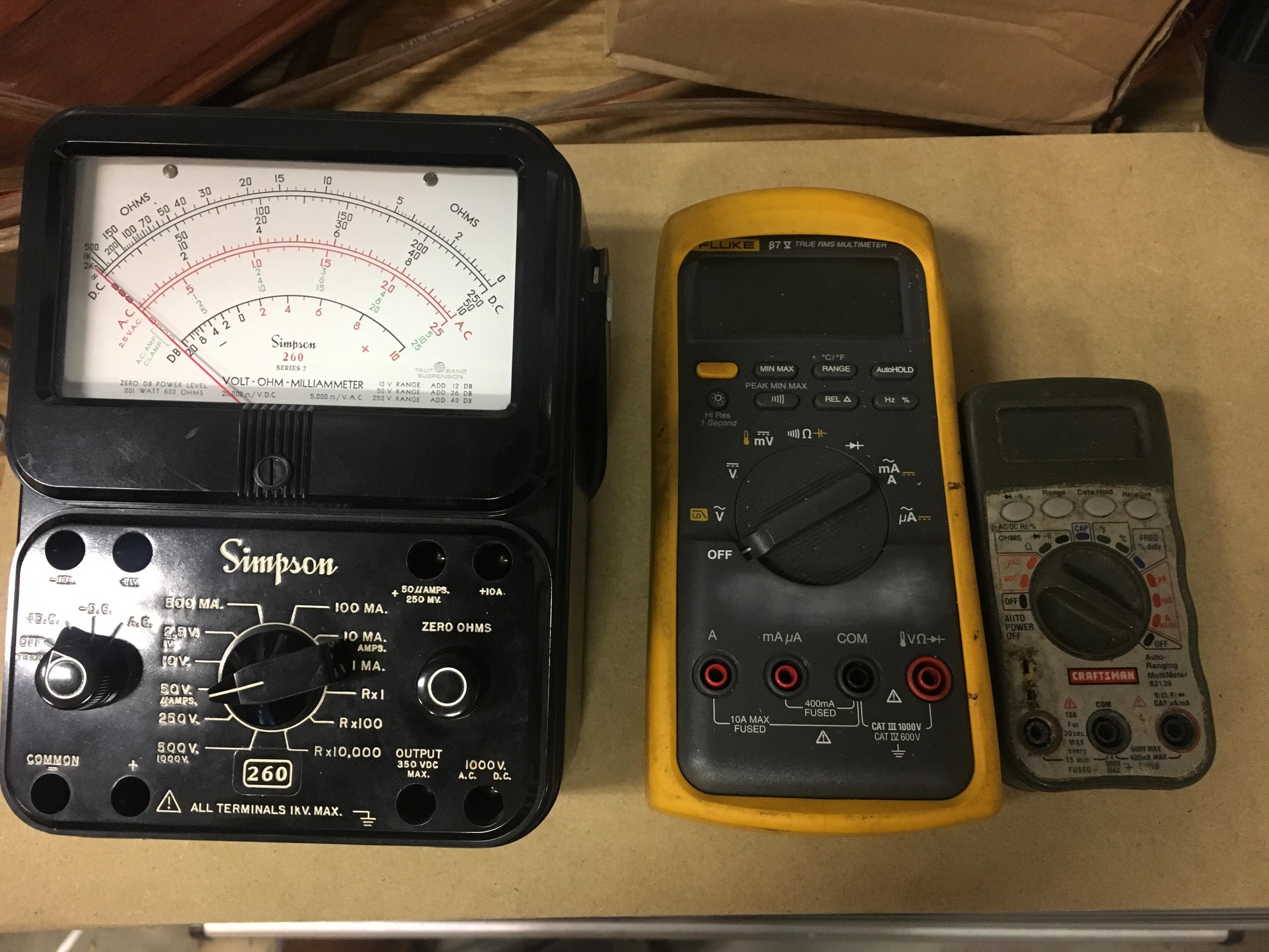

You'll need to buy a decent meter, then we can help you measure the step-down ratio.2. I've heard the output transformers are the first things that should be improved on these amps. How do I figure out what model Edcor output transformers and power transformer I should get to replace the Chinese ones?

Thank you very much for your fast response - I really appreciate it. As you suggested, I'll leave the tubes alone for now. And thank you for telling me about using small inefficient speakers to hear the distortion. I'll try that.
Regarding your second comment about getting a meter, I assume you're referring to a multi-meter? I have a Fluke 87, a craftsman multi-meter, and a Simpson 260. If these aren't sufficient, please let me know what I need. To be clear, I'm a mechanical engineer - my knowledge of electronics is very weak. Any help you can offer is greatly appreciated!

Your Fluke is a good meter with a high enough frequency response. Forget the other meters exist for now. The 260 isn't as accurate and it's HF response is poor. The Craftsman meter isn't very reliable and will not have a decent HF rating at all. So it's best if you just use them for basic, low accuracy type work.

Thank you very much for your response. I'll use the Fluke as you suggested. My speakers are 8 ohm impedance (I should have listed that in my first post - sorry). I won't ever be using this amp for 4 ohm speakers.
Would you be willing to clue me in on how to measure the output transformers? Also, do I need to replace the power transformer as well? I didn't mention this earlier, but the thing gets REALLY hot. Is this normal for tube amps?

Your fluke meter will be acceptable for the job at hand. You'll want to open the amp up and look at the wires leaving the output transformer that don't go to the speaker terminals. There will either be one wire going to the 8 pin socket or 2, then another wire that connects to the power supply.
What you need to do (with the amp off and unplugged) is to put a small AC voltage across the speaker terminals (a 100Hz test tone off your phone at half volume will do), measure that voltage, then measure the voltage between pin 3 on the 8 pin socket and the wire connecting to the power supply. This voltage will be a lot higher and will give you your transformer ratio.

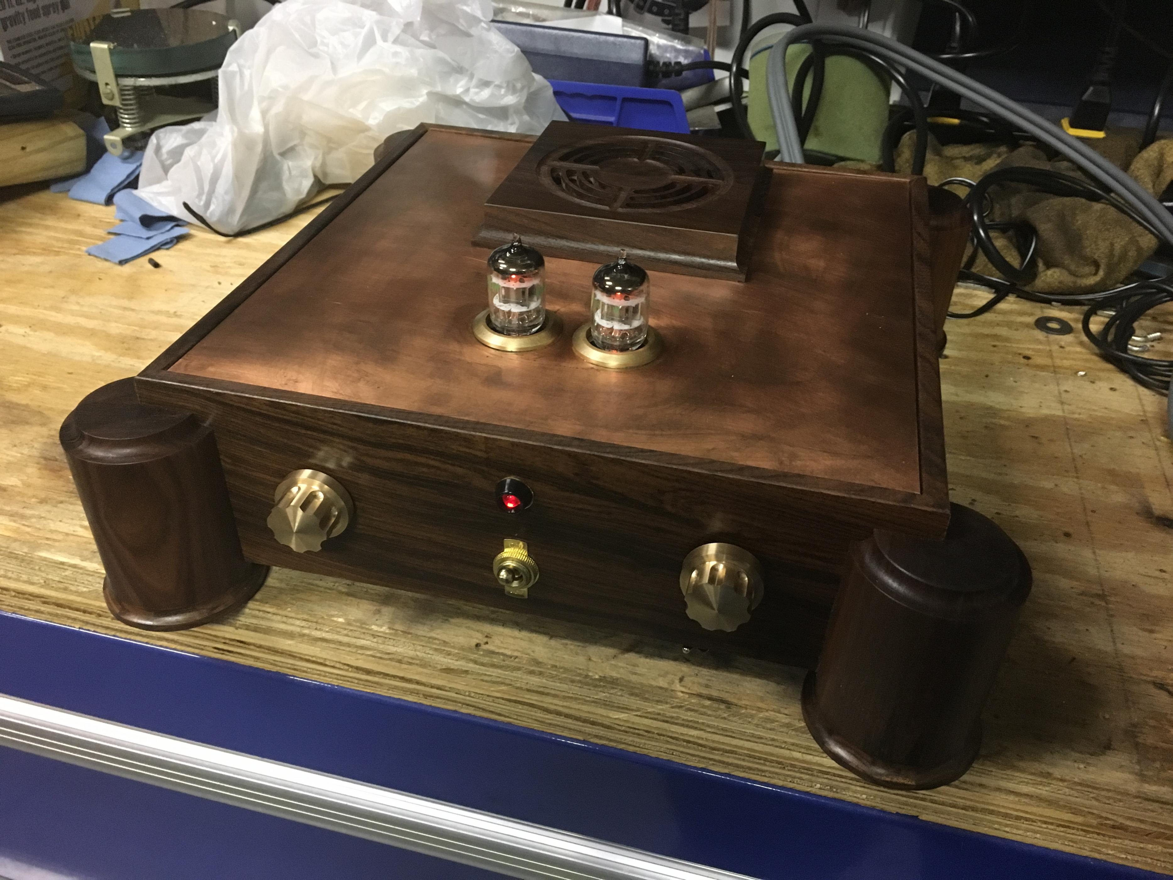

I enjoyed hearing about your woodworking modifications to the amp - I had planned on doing the same things to mine!
I previously bought a cheap tube pre-amp buffer off Amazon and built an enclosure for it using left over flooring (Bolivian rosewood). I also machined the knobs and tube rings out of brass. The fan cover is also machined Bolivian rosewood. If you look closely at the feet, you'll see segmented rings (12 segments).
Dave
Thanks for sending me that link. I enjoyed reading through that list of posts, though I must admit I didn't understand a lot of the electronic bits. I copied the picture of the schematic and will compare it to my amp.
