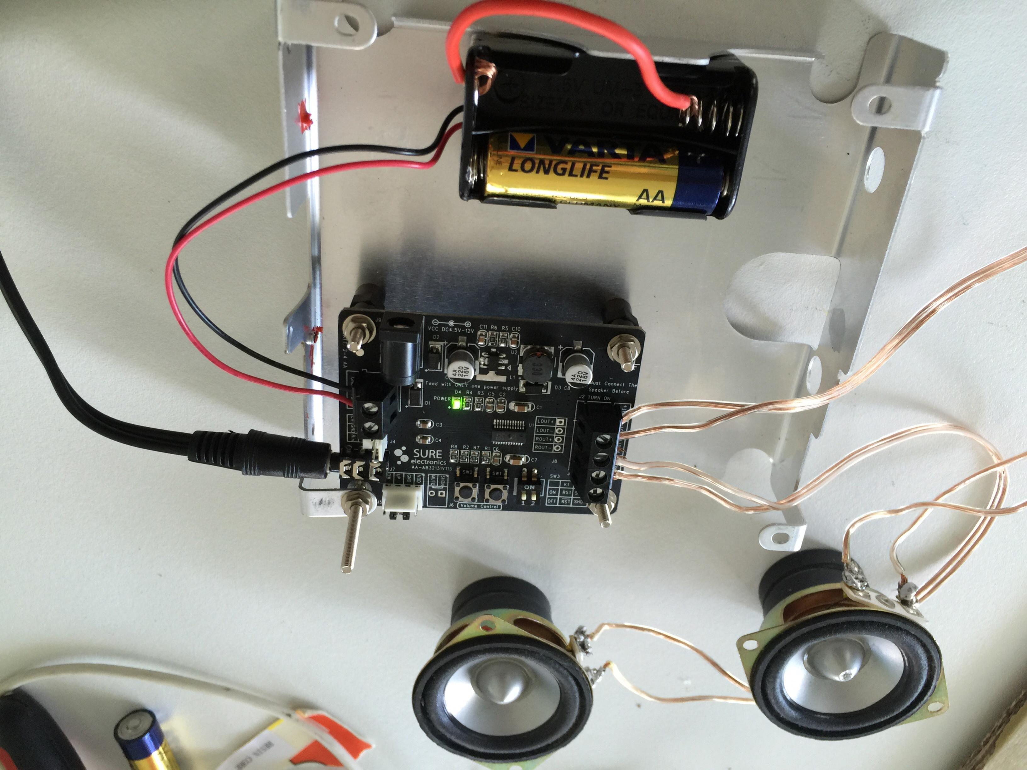

Hello All,
I am just starting my 1st audio DIY Project. I have very very limited knowledge so please bare with me.
I purchased a 2 X 2 Watt 4 Ohm Class D Audio Amplifier Board - PAM8803 2W Stereo Power Mini From ebay. Picture attached.
I am hoping to run it on a battery i have at home. 12 V 34.0w/cell HR 1234WF2
i am using some old logitec speakers .
I have wired it all up and I cannot get any sound.... the power led comes on. Green. Now i am using the terminal blocks for power and i have just found out that they are only good for 4v not 12 so i will stop by jaycar today and buy a plug for the 12v socket. ( not sure if this would effect it working or not )
Now i have no idea what im doing so not sure if im missing a key part ?
Also some other questions...
1.should i run a fuse in between the battery and amp ?
2. it says i should earth each mounting point on the amp... how is this achieved ? should it go to the negative on the battery or ? i only have experience with auto where i just earth it to the car body...
sorry for the noob questions... sorry for the long thread i just thought i would provide as much info as i can.

What source are you using to control the UP/DOWN volume control?

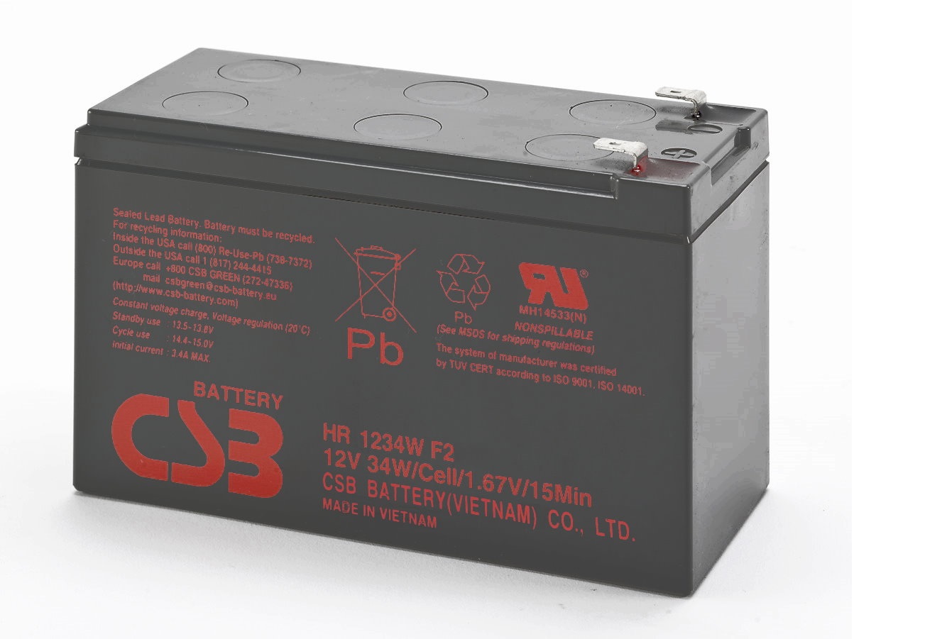

Board is labeled 4.5-12V...a "12V" battery is more than 12V when fully charged.
Yes, maybe the amp is shutting down because of a too high supply voltage.
Measure the battery. If it's over 12V, draw it down with a load resistor until it's just under 12V and see if the amp works.
It has on board volume control . I was planing to use that and leave it at a certain setting then control from iPod etc
So will the battery not be suitable ?
The green light is staying on the whole time could it still be the voltage? Even though the green light is on
I was planing on using the onboard volume control . Just leaving it at 70% then controlling from iPod etc .

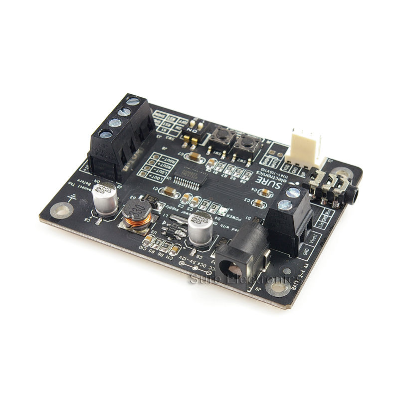

"This board can be either powered by wide DC voltage (DC4.5V to12V) via a power port or powered by 2 to 3 AA batteries or DC2.5V to 4.0V via a terminal block."
"I have wired it all up and I cannot get any sound.... the power led comes on. Green. Now i am using the terminal blocks for power and i have just found out that they are only good for 4v not 12.."
Maybe an OOoops..?
"Volume control is available via on-board buttons or an external rotary encoder daughter board."
Might need a jumper installed or changed somewhere to make the on board controls work..
Maybe an OOoops..?
Thanks i will give it a read. Can anyone help me out with the grounding / earth of this board? i have no idea what i should be doing here and if it will effect it working or not ?
You need to ground this thing, for sure. Since it is floating with the battery, the board wants a ref point, specifically something conductive for the mount points. A piece of sheet aluminum would work, but don't let it touch the underside or any solder points.
Also, those old speakers may not be high enough ohms - remember this thing wants 4 ohms, it cuts the output when you get up to 8 ohms by almost half. Also, get some proper speaker wire to the speaker - you don't want to confuse the impedance load of the chip. Also - some chips do not like it when you try to run it without load, so if it is 2 speakers, connect them both.

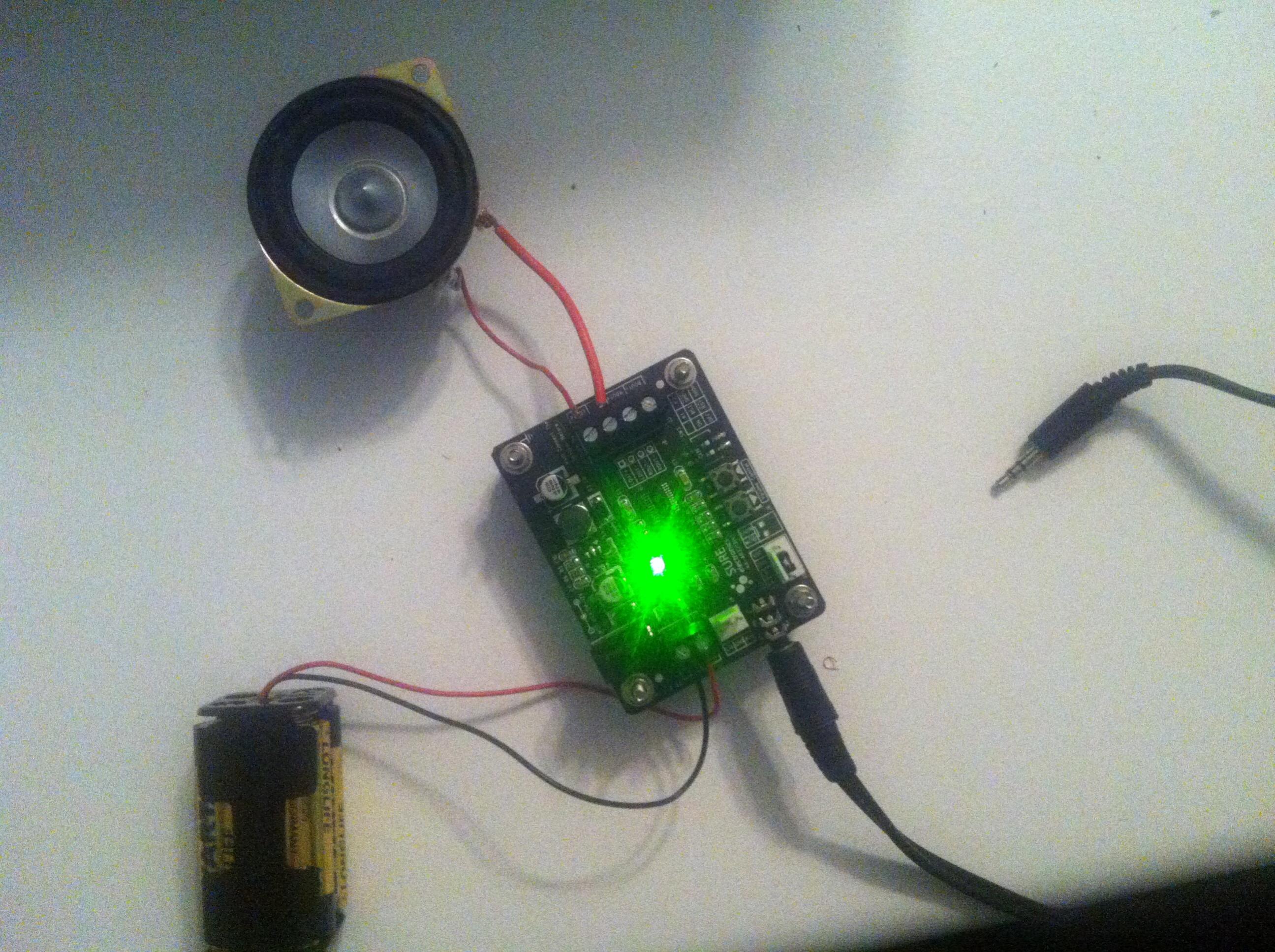

After further testing I can only get the speakers to make noise , very distorted , when I use positive from one terminal and negative from the other channel. Hope I haven't blown it.
4.5V-12V
I don't think 1.5V from a single AA battery is quite enough.
Try 3 or 4 of them.
"positive from one terminal and negative from the other channel"
Don't do that.
