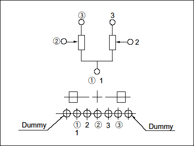

I have this Tc Electronic Konnekt 24d audio interface with a broken volume knob.
I don't need the knob at all, since I use 3 channels (2.1) and the knob will only change volume for 2 channels anyways.
So I would like to remove it, or bypass it, or whatever I can do to take the defective knob out of the equasion (100% volume).
I have no clue about electronics, but I used a soldering iron before.
what is the easiest way to do this?
the knob should be this:
EDIT: took the picture from this other thread: Changing a pot's value with parallel resistors
it actualy seams to be the pre-amp pot, not the volume pot which is stereo

4 contacts ?
GND, OUT, IN, ???
On a normal pot viewed from front, PCB on the underside You have GND OUT & IN.
So panned to left GND OUT - Muted & panned to the right OUT-IN - Max volume.
So You just have to short OUT & IN, leaving ground unconnected.
For stereo You usually have two rows, one for each channel, but there are pots with 6 contacts in one row or even 5, one of them the common ground.

thanks for trying to help.
according to this Discussion View - Music Tribe
it is an Alps RK14K1220D1W
but it can't be found on Alps page. acording to the topic this should be equivalent: https://www.mouser.com/ProductDetail/Alps-Alpine/RK14K1220A0F?qs=6EGMNY9ZYDSrLjw8e8h6ew==

So 5 pins plus 2 dummy pins.
You just have to connect pins 2 with 3. Leave 1 (ground) unconnected.
2 are Ins, 3 are Outs.
Connect 3rd with fifth & 4th with 6th
First & seventh will also be probably connected to the middle ground one (white 2) on the PCB.

Sorry No ! xxxx1220 is for tone, so right picture on page 362. 3rd pin with 4th & 4th with sixth. With one dummy pin.
RK14K12
Try both. You don't burn the circuits. The least problem You can have is no sound at all or crossed channels.
. So 15C.20 - Horizontal with bushing for tone
the document is confusing at that point.
good to know I can trail and error without breaking something. will try your experienced interprretation first.

Yes any isolated small wire.
I believe if You touch the pot output pads with Your fingers, You will hear something in the speakers. Hum perhaps. Then it's just a matter of finding the other two input pads.
