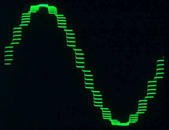

My old HP scope got a little trigger problem with this kind of signal
but it can be seen, no triangle: 8 x os dac / 20kHz sine after I/V & before filtering.
thanks, it is clear now and I think hardware os is out for me.
Actually, I think the scope is triggering just fine. What is happening is that the 20k is not a nice fractional subharmonic of the 44.1k sample rate, so each pass the waveform starts at a new point.

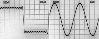

Here's an example of 8x digital filtering with some analog low pass. Waveform on the right is 20k sine (-6dBFS).
No problems triggering.
jh
