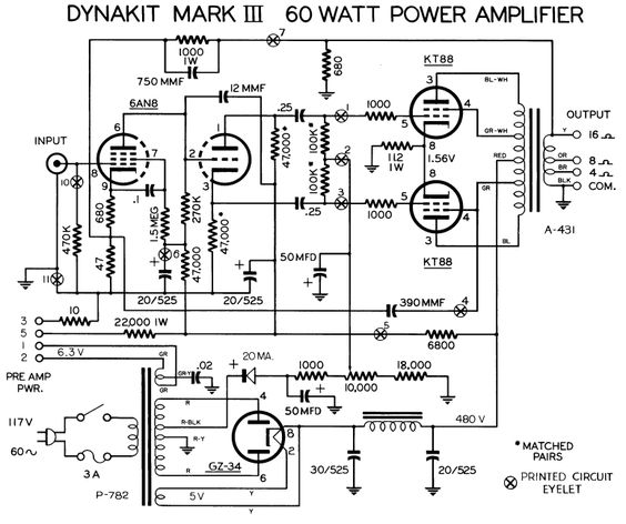

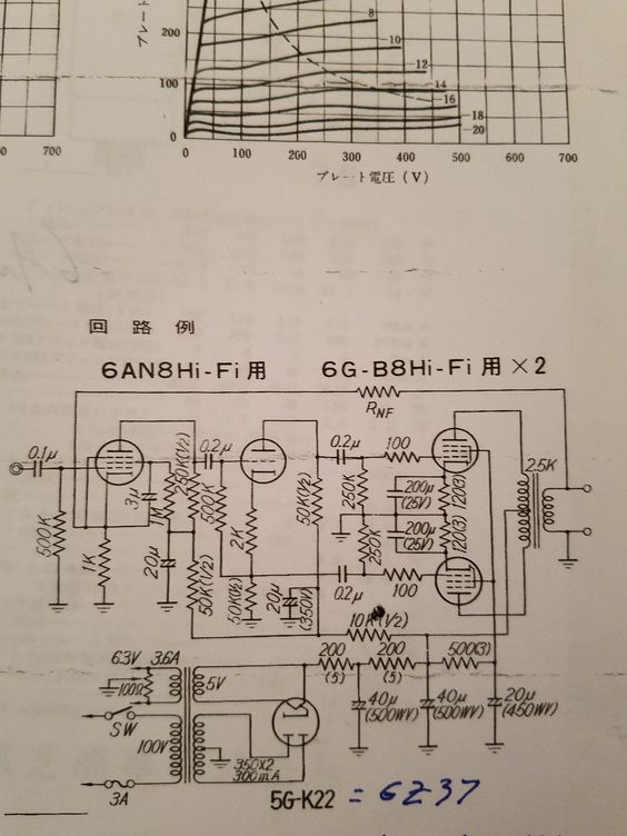

I ran across this Toshiba 6GB8 amplifier. 6GB8 is an esoteric tube I know. For this discussion just assume it's an 8417.
I noticed the circuit is pretty close to the Dynaco MKIII. But unlike the Dynaco, Toshiba didn't have it set up for Ultra Linear operation.
They feed the screens with a 500 ohm series resistor. Not sure that is worth much and may just raise the impedance of the screen circuit which is not good. It also does not have fixed bias like the Mark III so in general, I would expect it to be not quite as good... but who knows??

The is nothing wrong with full pentode mode. AAMOF, some genuine experts prefer(ed) full pentode to ultra-linear.
Open loop linearity of full pentode mode "finals" is maximized by regulating g2 B+ at a fraction of anode B+.
Both the self and "fixed" bias techniques have pluses and minuses. IMO, the debate will never end.

That 500 Ohm resistor that powers both screens is bypassed with a 20uF capacitor. 20uF at 20Hz has an Xc of 398 Ohms. The screens voltage comes from a 222 Ohm impedance at 20Hz, and the impedance goes down as the frequency goes up (less than 22 Ohms at 200 HZ). Also, it should be noted that with signal applied, as one screen current goes up, the other screen current goes down.
