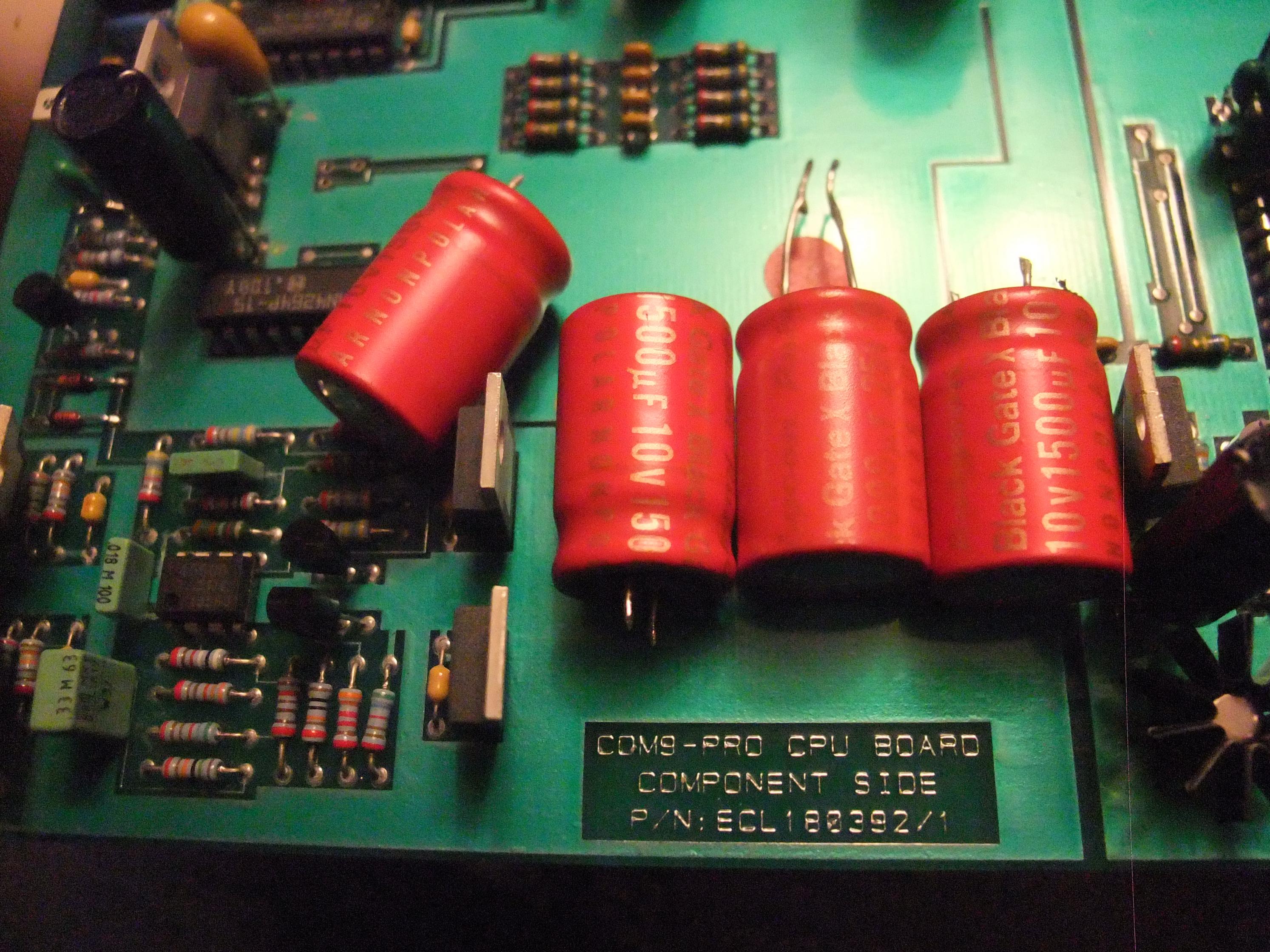

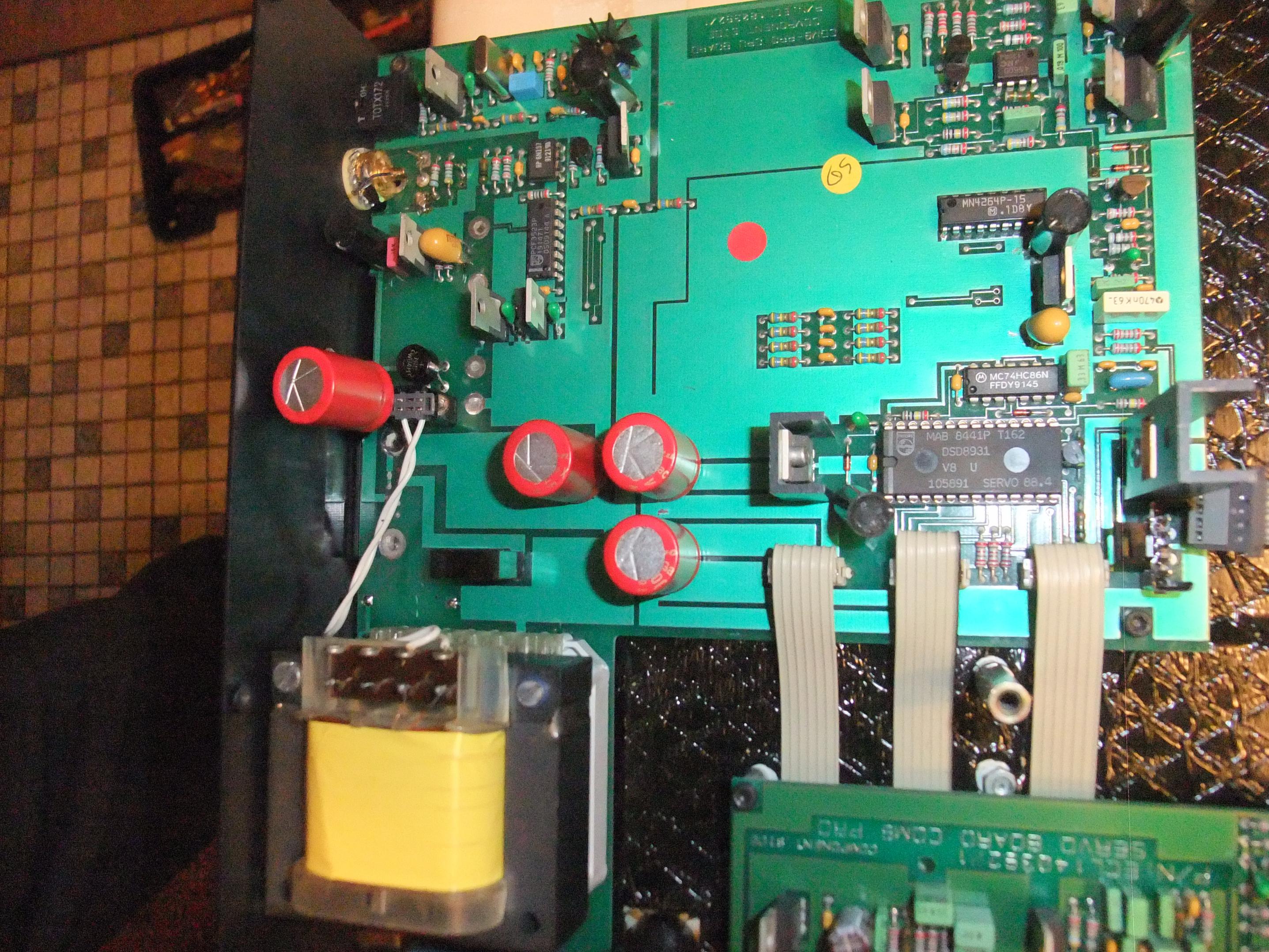

Concerning this caps I have a question:
After open a cd player from Micromega (Duo with CDM-9 mechanism) I note, that three capacitors between rectifier and 5V regulators was replaced by Rubycon Black Gate Nonpolar (1500uF/10V - have a look to the attachment).
Until now I always thought that this type of electrolytic capacitor was meant to be placed in the signal path and not after a rectifier.
Was my estimate wrong ?
No, you are right, someone must have run out of the proper caps or just been wayward, PSU caps should be polar and low ESR / high ripple. I don't think bipolars are optimized for low ESR or ripple current, why would they be?
