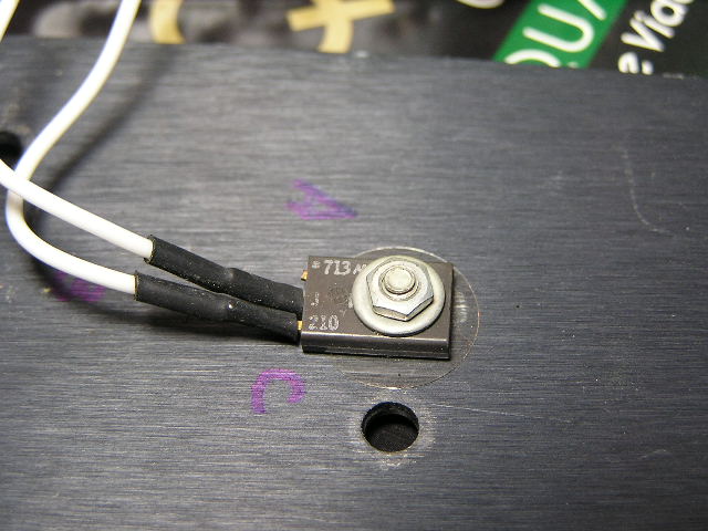

3. What is the device attached to the backplate that the three white wires are suppose to be attach to?

Hello, I have one of these scopes that I bought new in the mid 70's when in school. I still have it and still works. But the batters went tits up long ago and the unit DID FAIL to power up. What I believe I did was, scab in a linear DC Regulator inside the unit. It would have been a DC voltage close to the voltage of the batteries. And then probably disabled the charging circuit in front by just a trace cut. I still used the original 'wall wart' that came with it. Also the device on the back panel is Q21.
