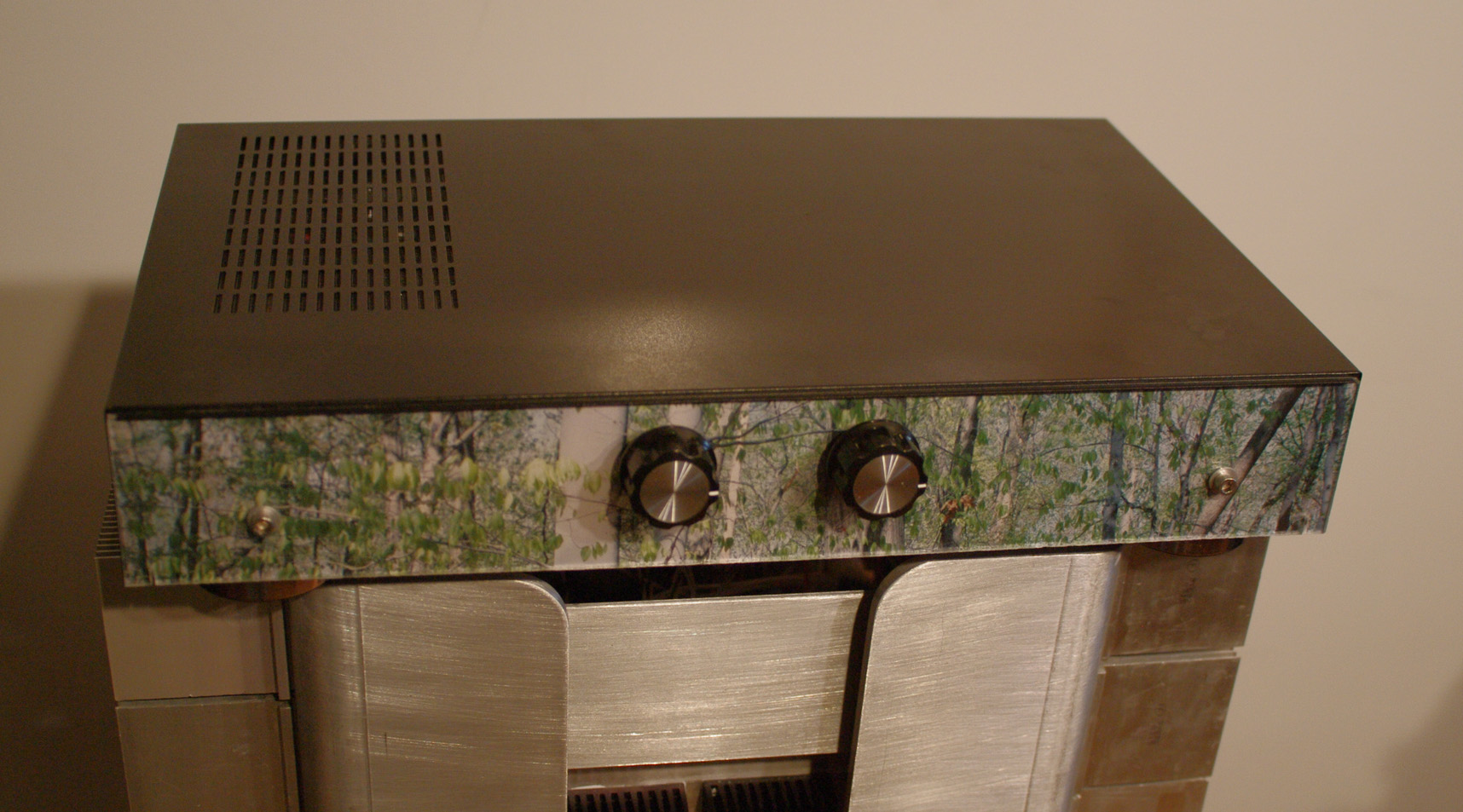

reuse DVD player case
It is not the little things that stop you from building, it's the expensive ones!
Casework has been known to stop a few otherwise avid solder slingers. For a preamp I curb picked a DVD player, gutted it and threw away the plastic front replacing it with a sheet of plastic with a photo stuck to the back side. Looking for some WAF? Let her pick the photo ;-)
The amp underneath was built from aluminium from the scrap yard which has huge boxes full of CPU coolers and larger pieces of angle aluminium and aluminium brackets!
jdg123, cool idea. I've saved a few chassis from expired electronics but was trying to figure out how to make the front useable. You may just have answered my question. And yes, I too am one who often hesitates on solder-slinging projects b/c of the case challenge.

Gosh yes there are so many cool gizmos I'd like to incorporate into some pieces I dream out while I take my morning coffee. Then I wake up.
I am dealt time and no money right now so my ideas are focused that way, toward what's free or nearly so. Solving the ugly nose problem on the ubiquitous DVD player carcass was a simple bit of inspiration, I had plexi and I have a lot of photographs. I hope this solution speaks to someone out there🙂
Now I am thinking about casework that can shed a lot of heat for a big class A amp. I wonder if they ever scrap power transformer cases? I think I'll put in a call to my electric co-op🙄
