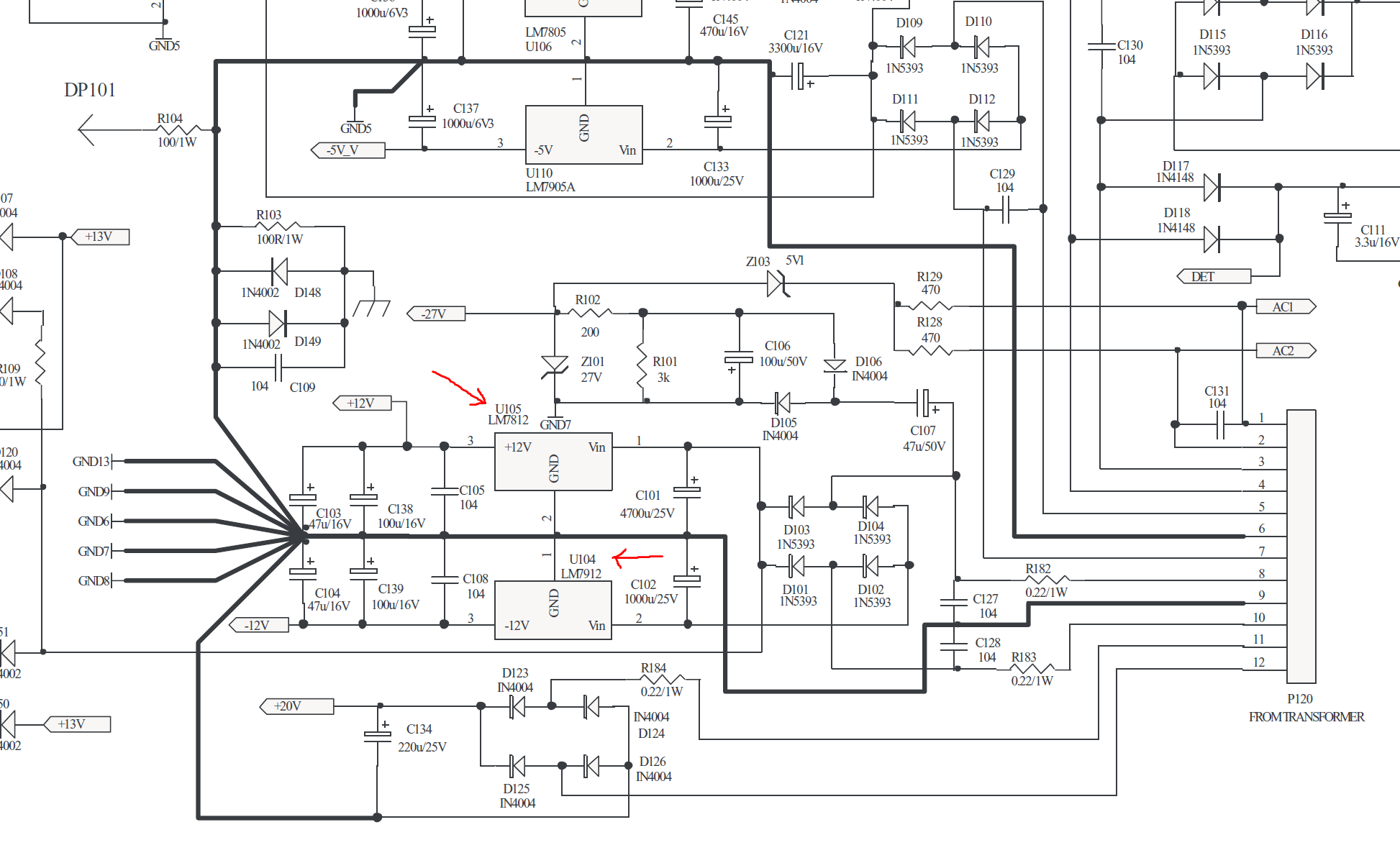

Its far more likely to be a power supply issue on the main motherboard. Unfortunately, you just have to get in there and take everything out to be able to work on it. You can check all the regulator voltages beforehand, but you're still going to need to pull it all apart because there can be lots of bad solder joints on the motherboard.

I've been casting my (untrained) eye over the schematics, and it does appear that there's a pair of regulators on the main board that supply -12V and +12V to the MULTI and AUDIO board (U104 and U105 in the schematic below). Most of the other boards take different voltages from other regulators.

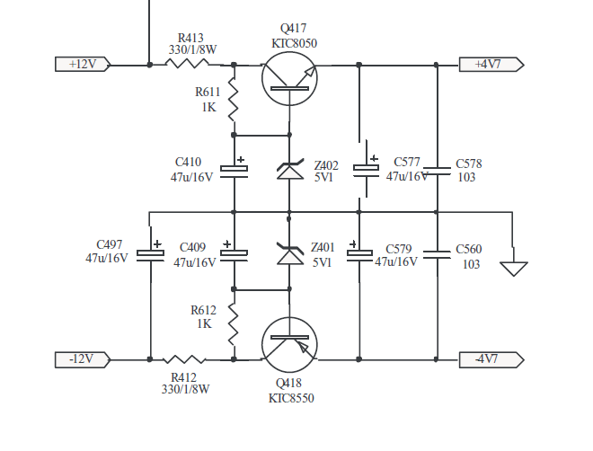

On the MULTI board it looks as though there are several analog multiplexers; I assume for switching the various source options (from DSP, direct from analog stereo, direct from analog multichannel) to the line level amplifiers for each preout connector. They appear to be powered by a -4V7 / +4V7 signal; but they're generated using some discrete components on the MULTI board from the incoming +/-12V signal. Whether that's the problem (or the incoming 12V supply) I don't know.

The regulators on the main board aren't expensive to replace; but is the noise problem a realistic symptom of a bad regulator, or more likely a bad solder joint (or dodgy ground connection)?
