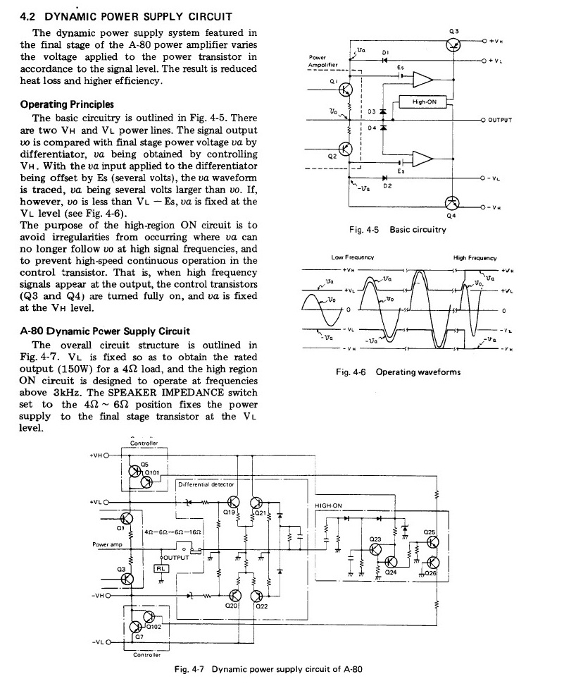

P.S. Here's the service manual which includes the amp schematic on page 13 and here's also some technical info on how the Class G voltage switching works for those interested:

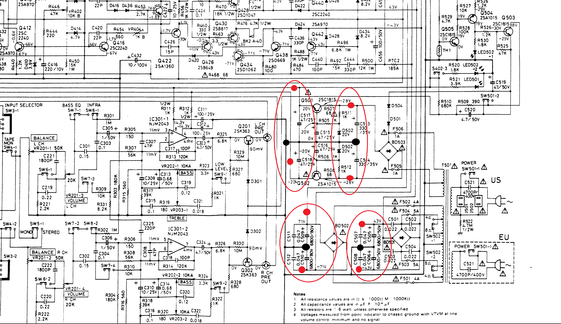

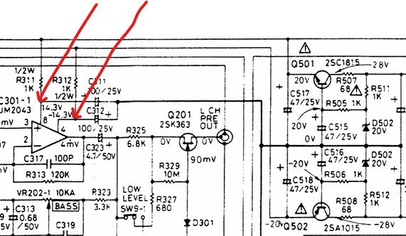

Regarding checking the power supply voltages, just to be sure, does this involve measuring the voltage of the marked points in the schematic screenshot below with the amp turned on and checking if the measured voltage matches the voltage indicated on the schematic? If so, is there anything I should watch out for to avoid accidentally ruining the amp with the multimeter leads - besides just not shorting anything? Lastly, how do I check the ripple levels? Is that related to the main amp alignment procedure on page 5 in the service manual?
Yes you've got the right idea for measurement points. You measure ripple level with the oscilloscope. You have to be extremely careful with multimeter probes, it's so easy to slip and short something out.

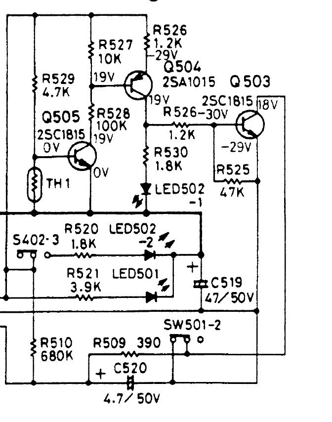

Voltage over C520 controls Q201,Q302 which i beleive is the main cause of your warmup problem but i might be wrong.

@Jakobsson, I just switched out C515-C520 and the the startup ground-like noise is way quieter now and only goes for 1/3 as long as before so replacing them definitely seems to have had a positive effect even though it's still present. I appreciate the help nonetheless, thank you.
