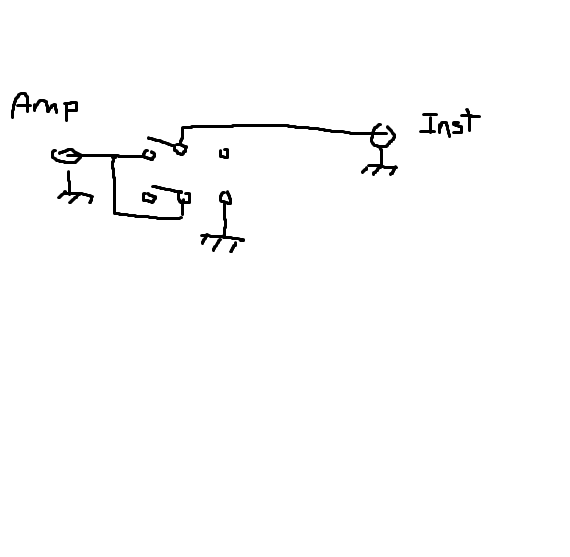

why sereis-shunt is better
In the examples, 1C-series-shunt method-is better because of the inherent self-capacitance of the series switch, which could be several pico farads. Remember a capacitor is two conductors separated by an insulator- in this case, air. The resistance of the series open switch-it's not infinity- and the capacitance of the switch form a high-pass filter and some signal gets through- the pop. The second switch-shunt-routs the pop to ground. Use a DPDT and use one NO and one NC contact. It's the easiest and cheapest option. You can try other options if this doesn't satisfy your guitar player. You might want to inform him being a purist- true bypass mechanical switching only- has its consequences.

I'll bet this is the source of the pops, try it with a 100k resistor load across the shorting switch.
Well I had a 100K ohm resister in my parts box so this is the method I used for the first attempt at fixing the issue. In my tests the switch was quieter than without the resister so I returned it to its owner for evaluation. I am waiting to hear from him on whether it is fixed...
