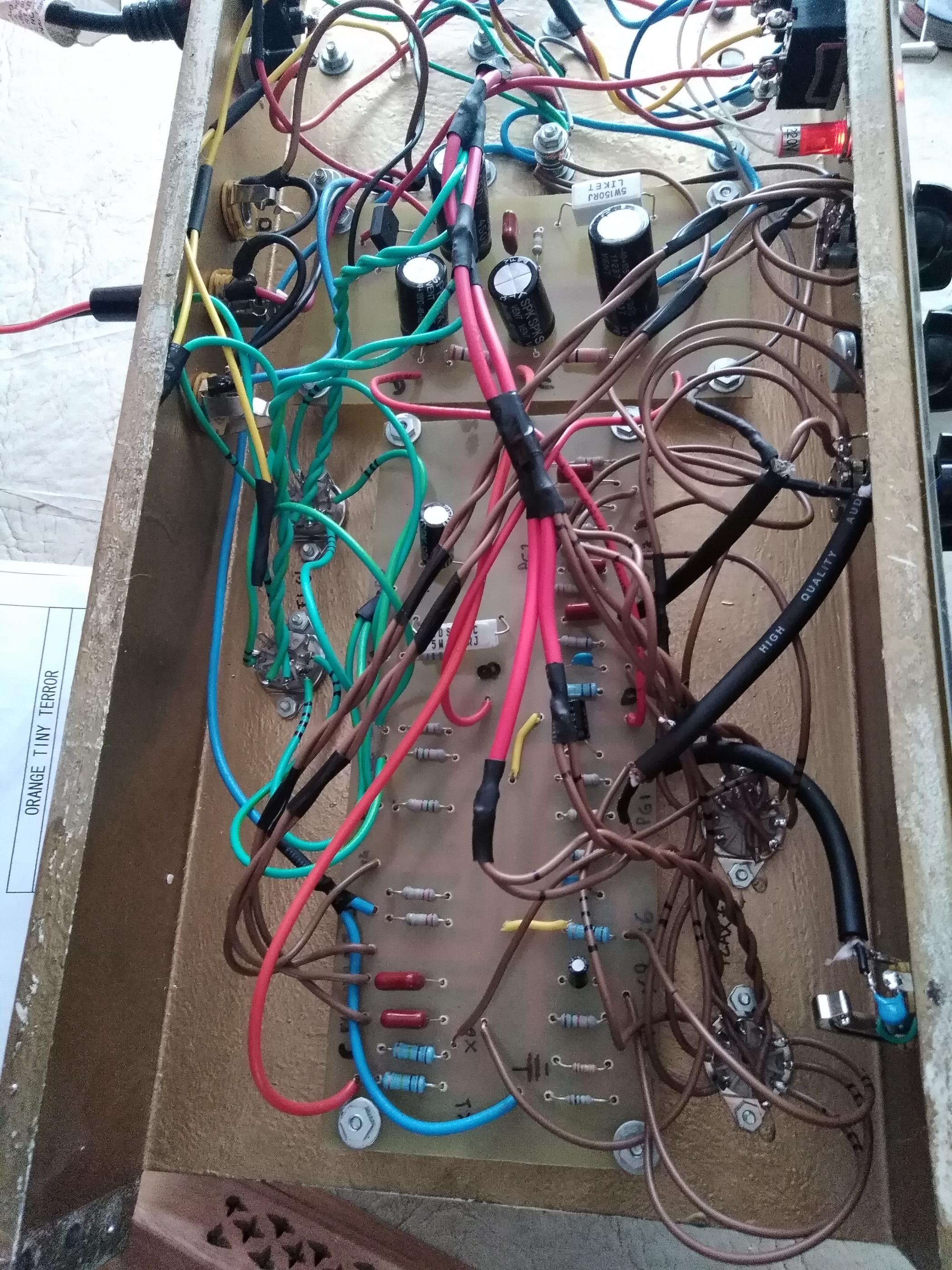

I have build a Tiny Terror (Valve Guitar Amp) clone. And Iam having some problems with it.
The amp works, and do what is supossed to do, but when you rise GAIN over than 4 the sound breaks and your ear something like a 'whistle' and you can't play nothing. (Sorry about the term, English is not my mother language).
This is my very first Tube Amp, so dissmiss the mess that you would see in the pic.
There are 3 shielded cables, the lowest one is the guitar input, the middle and upper ones are the GAIN pot conections to the first 12AX7 tube (PreAmp Stage). I had done this trying to minimize interference, but without success.
I hope anyone could give some hints where to start looking for this noise source.
There is an audio in the zip file so you can listen what the amp is doing. I believe this is a kind of oscillation, but Iam not sure.

Just a few ideas, I an no expert but I have built a few guitar amps.
Its more than likely a lead dress issue. You can try moving some of the wires around with the amp running. Set the gain control so you just start to hear the oscillation, use a NONE conductive object to move the wires around.
Check the wiring around v1 (Input valve).
The wiring around the phase inverter looks a little bunched up.
Try removing V1, If you still hear the oscillation the issue is after the input stages.
Are the coupling caps the correct size? A higher value can cause instability in some high gain amps.
Just as a side note your heater wiring looks very strange to me, normally with AC heaters one would tightly wind the wires and run them around the edge of the chassis away from the main board.

No, the mess is probably part of the problem.
Amplify a small signal big. Let some of that big signal sneak back to the input. It is amplified again, and again, and again.... scream.
I can't work out your layout. But I bet later signals are sneaking into earlier stages. Remember that high frequencies couple through air. Not well, but a guitar amp has a LOT of gain.
I see three too-long wires on the 12AX7 nearest the input jack. Little antennas.
Find pictures of a happy Tiny Terror and try to emulate the wiring.

Dazcwl, could you please explain me"lead dress issue"? I just learn English at University, sometimes I get lost in translation. But you are right, the shielded cables are the reason of what you said. I just twist and 'de-twist' the cables that goes from GAIN pot to grid of V1 & V2 (halves) because when I moved (with mi fingers) the scream changes.

Use a wooden stick to move the wires and see if it changes the squeal. Maybe you can find a position where it works for you.
The real solution would be to rewire the thing. Heater cables twisted and near the chassis. Avoid parallel signal wires. Use shielded wire for long runs, like from the input jack to the first tube. Move the wiring near the chassis, so that the magnetic field is reduced by the grounded chassis.
Wires that are too long, or too close to other wires, can cause unwanted positive feedback (as PRR explained.) Result: howling (oscillation.)
...when I moved (with mi fingers) the scream changes.
That's telling you that you have lead dress problems for sure.
Try to keep wires short, and away from each other. Use coaxial cable (shielded cable) for sensitive wires carrying small signals to grids of triodes.
The heater wiring...well this is my first Amp. That was the last thing I had done in building process, the cables was a little short.
After you fix the squeal, if you find you have too much hum, then you can worry about improving the heater wiring.
Do you think my best shot is wiring it (properly) again?
At the least, you do have to clean up the existing mess of long wires all jumbled together.

Finally I found some time to repair my amp.
I shorten all the wires from PCB to 12AX7 valves.
The Amp sound improves a little. Now I can use Master at 6, before only at 4.
Even this point is not the final station it just show me that this is the correct way.
I have to clean up all the mess.

I built a Tiny Terror Clone as well and had oscillation problems despite being very aware of "lead dress" during the build (it was about my 10th Guitar Amp build and I've done twice that many HiFi Amps).
I found I needed 10K grid stop resistors on both phase splitter triodes (V2) and also on the 2nd half of V1 on the triode input feed from the 1st gang of the gain control pot.
The bodies of the grid stop resistors need to be right against the tube socket pin, that is, not on the wiring board but right at the tube socket.
The 68K on the input triode should be mounted that way too.
Also check the final filter capacitor (the one providing the B+ to V1) for dry solder joins at either end. Bad connection would cause "motorboating" form of oscillation rather than the "parasitic" form of oscillation we have discussed above.
