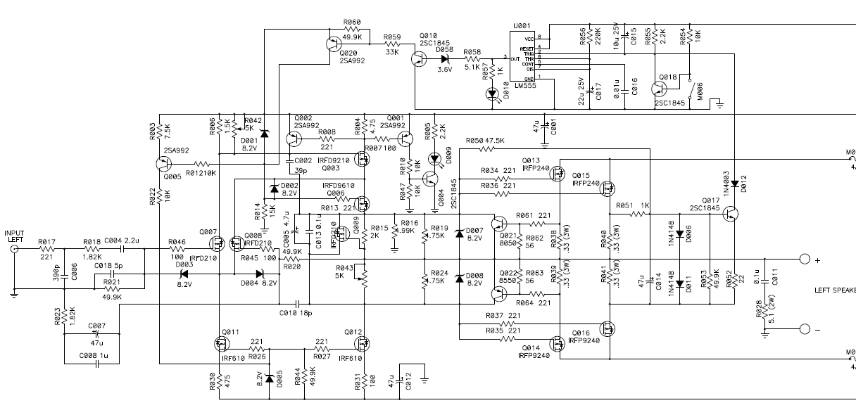

Noise is not form power (50 Hz and harmonics) but high frequency hum from about 1 kHz and up. Very annoying for good sounding amp if using sensitive speakers.
Can be that input FETs IRFD210 are noisy and only way to get noise down is to replace this with better ones. What can be better?
Attached is GFA5300 schematic, GFA5200 is basically same only power and protection is different and it has only one pair output FETs.

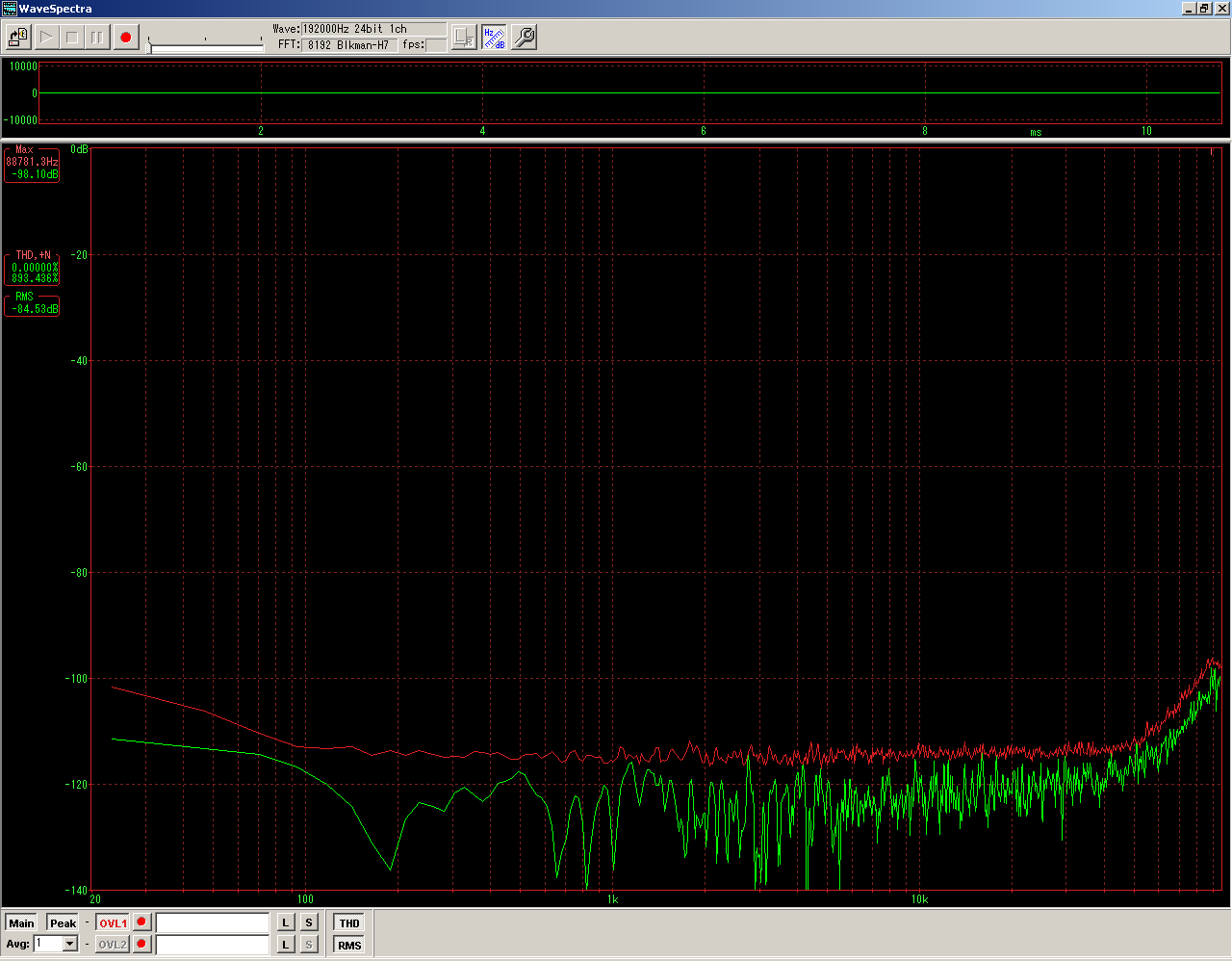

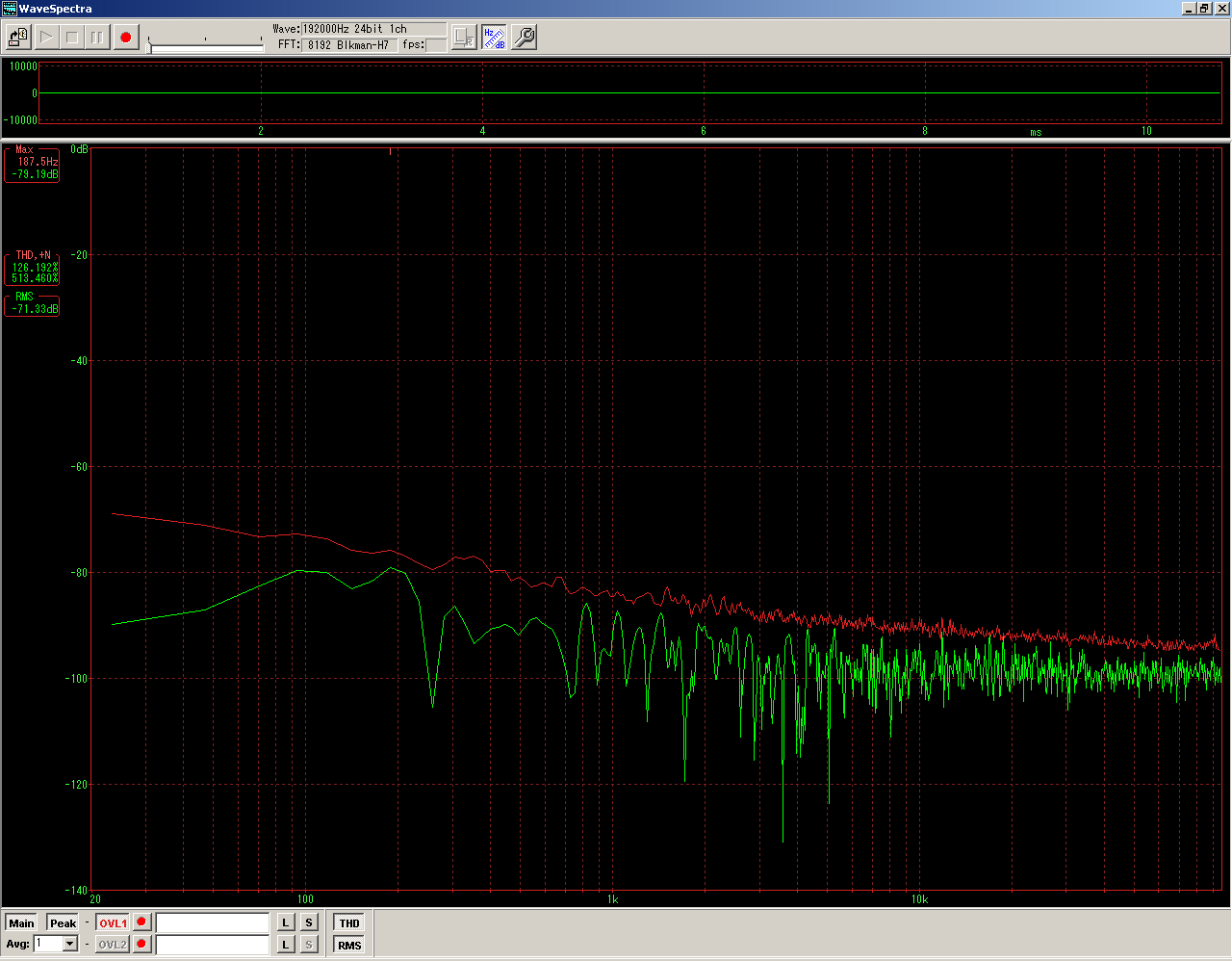

I made some measurements with sound card, amp load is 7 ohms, sound card input sensitivity is adjusted so that -3 dB level is 1 V RMS on amp output, amp input is grounded. I not find any difference in noise, is input grounded or open.
First image is base noise level of sound card and load, all connected but amp tuned off, second is amp tuned on.
Actually it seems quite pink noise, but from speakers it will heard/feel like high frequency noise.

The spectra are good to see but as you say the noise is the same from either channel, it is most likely to have a common source. In other words, it is less likely to come from the amplifiers themselves. The noise levels and content would show some inconsistencies between channels if that were the case.
Since noise it is not entering via the signal inputs, it must be entering via the power supply if you remove the speakers when using a dummy load. This still does not eliminate external noise sources. Noise on the mains supply, nearby RFI generating equipment etc? As Rayma suggested, take another look at the noise in quiet periods when people are not using PCs, appliances, Low voltage lighting etc.
The alternative is simply take the amplifier to another location such as friend's place where there is already a sound system, different player, preamp, speakers etc and retest for consistent measurements there.
If noise is from external source or power supply it must have some dominant frequencies seen in FFT analysis, but FFT is very even, noise is distributed equally on all bandwidth.
I partly find reason of noise, it is zener D005 in the input pair current source.
When I connected 20uF capacitor parallel to zener, I get 5-10dB lower noise in high frequencies.
Type of installed zener can not be identified, also is not any clear type given in specifications, just note "DZ 1/2 W 8.03-8.34V ROHM"
Now question what zener had lowest noises?

You could use a low noise adjustable voltage reference at 1mA current, instead of an 8.2V Zener.
http://www.ti.com/lit/ds/symlink/tl431.pdf
You could buy a bunch of 8.2V Zeners, and select one for low noise at the 1mA bias current.
1N5237BTR Fairchild Semiconductor | Discrete Semiconductor Products | DigiKey
Now the Zener is running with about 1mA of bias current. It should have less noise
if operated with more current, up to the 60mA maximum rating. I'd try around 25mA
bias current for the best DC stability, if the amp can be modified to do this.

I replaced zener with OnSemi TL431ACLPG, what had theoretically 100 or 1000 times less noise than average zener but get exactly same noise on output.
As capacitor paralleled zener give less noise, seems noise is still from voltage source but I not understand why with TL431 noise is same as with zener.
I made new measurements when zener had parallel capacitor and I was not able to reproduce lower noise on amp output. Also made test with 100 ohm resistor series with zener as in Simple Voltage Regulators Part 1: Noise, but still not get lower noise on output.
Tested RC filter on Q011 input with gate resistor 221 ohm and capacitor 22 uF, also no lower noise.
Seems some other transistors (input?) are defining noise level of amp.
