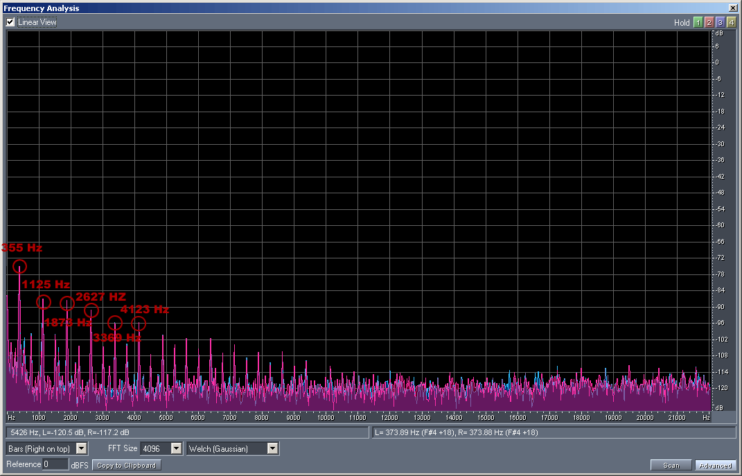

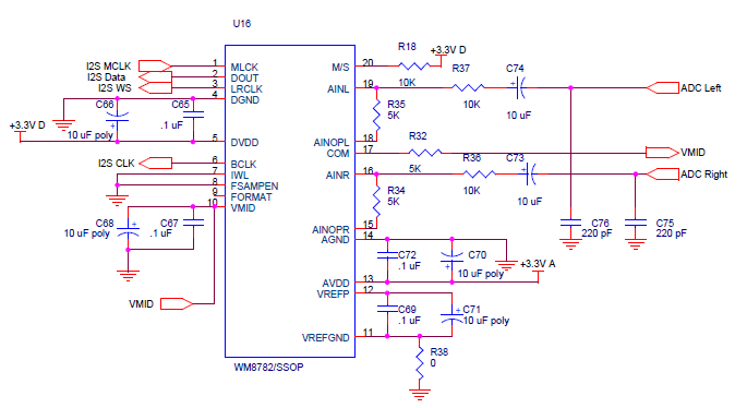

I have built a 16-bit ADC around the Wolfson WM8782 and am getting a buzzing noise which I believe is RF noise coming from a 2.4 GHz TX on the same board. They share the same regulator with star routing to a separate 0 ohm resistor on a 2 layer PCB. The ADC is built per the datasheet in terms of layout and components but has a nice -74 dB buzz starting at around 360 Hz and going up to around 4.1K at -95 dB. Is there anything I can do to shunt the noise to ground aside from the bypass caps I've already employed?
I have a companion DAC on another board which does not exhibit this noise despite also having a 2.4 GHz radio on board as well.

I don't know if this is directly-related to your problem, but why are those bypass caps "10 uF Poly"? It seems like you would want to use electrolytics, there, so that they have a rather-high ESR, to damp things out. Or maybe add some Ohms in series with your poly caps. Likewise, the 0.1 uF should not be low-ESR, like film or C0G/NPO ceramic. I think you would want to use the cheaper ceramics, there, if you're not already.
You should probably also try a small resistance (say less than 100 Ohms), or a ferrite bead, upstream of the 10uF/0.1uF caps, to create better low-pass filters for the power. And are the caps connected right at the power pins, as they should be?
What is upstream of those 220 pF caps to ground? Can you add a small resistance ahead of them, to ensure that they filter RF?
It's hard to say much, without seeing the layout and maybe a full schematic. But you also don't want the ground returns for your ADC inputs to share any part of a ground returning any RF (or anything else, for that matter).
If it turns out to be in the power rails, you could probably just put an RF choke (inductor) in each of them, just upstream from the 10uF/0.1uF.

The caps are poly because the manufacturer calls for very low ESR caps and suggested poly aluminum caps. The .1 uF caps are X7R ceramic.
I will see about adding a 100 resistor there. If I go with a bead, is the frequency critical? Should I select one as close as possible to 2.4 GHz?
I guess I could try adding 100-200 ohms there although it will throw off my gain a little bit I think. I can always adjust the other resistor if needed.
In this case they are. I've heard as many bad things about split grounds as good. The TX and ADC are separated by about an inch of PCB though.you also don't want the ground returns for your ADC inputs to share any part of a ground returning any RF (or anything else, for that matter).
Again, is the frequency critical? None I've seen even go close to 2.4 GHz. Do I want to select one that is close to the interference frequencies (300 Hz to 4 KHz)? I've not seen any that go that low either.

I don't know how much current your ADC chip needs, or how much lower the voltage is allowed to go. 100 Ohms might not be too much. You might have to experiment (see farther below). 33 Ohms might be good. Not sure about the bead specs. Sorry
f(-3dB) = 1/(2*Pi*R*C). If R = 100 Ohms, with 220 pF, you'd get f(-0.1dB) at about 1.1 MHz, f(-1dB) at about 3.7 Mhz, and f(-3dB) at about 7.2 MHz. With 200 Ohms, those frequencies would be cut in half, and so on. If it turns out that filtering is needed, there, maybe you could see if the capacitance could be increased. If you're converting audio, go as low as you can without cutting into the bandwidth you need, by too much.
I don't know what could be bad about splitting grounds, whether they're analog and digital, high and low frequency, or large and small signals/currents. I've never heard anything good about running them together, and plenty of bad things about that. One major problem is that the currents in a ground conductor induce voltages across the conductor's distributed inductance and resistance, V=L(di/dt) and V=IR. The di/dt is the rate-of-change of the current. So if you have any fast current edges or other fast changes in current (which you probably do, with 2.4 GHz signals, as well as with digital edges), the induced voltages can be relatively large. Those voltages are presented back toward the "non ground" end of the ground conductor. If one of those points is, for example, the ground reference side of an input resistor, then those induced voltages add, arithmetically, to that input's voltage!
If it comes down to it, you could try cutting the ground returns from the ADC inputs ground references, and running separate wires. [Another idea, in case nothing else works: Make a PCB that's all ground plane, maybe with a slot between the 2.4 GHz and ADC ground areas, and bolt it on under the existing board, with spacers, and solder ground wires between the two, and cut most of the ground traces on the main board. You could make the ground-plane PCB yourself, easily and quickly, with a Dremel-type tool and a drill.]
Having the ADC and the 2.4 GHz transmitter so close together might be a problem, too, depending on the layout. I would probably be ready to try RF filters at every ADC pin, if possible, including inputs, power, outputs, etc. Any pin that doesn't like pure capacitance on it could have an RCR "T" filter, with the C to gnd between two resistors. The filters should be as close as possible to the chip's pins, e.g. within a millimeter if possible, for the C to gnd. That goes for the power supply bypass caps, as well. Note: Filter ground returns should run separately from input ground references' ground-return traces. Traces should be kept short, and not run in parallel with nearby 2.4 GHz traces. You might also have to consider a grounded metal shield or box covering the RF portion, or maybe if you're lucky just a "wall" between the two sections.
The inductor in the power traces would be forming an LC low-pass filter with the bypass caps. So you would want the cutoff frequency as low as you can get it, without causing other problems. Unless you need more than about 73dB of filtering, beyond 1 MHz, a 220 Ohm resistor would be about as good as a 220 Ohm R plus a 1000 uH inductor. 220 Ohms would give f(-3dB) of about 71.5 Hz, and would be 10 dB down by around 215 Hz. 100 Ohms would give you -3dB at about 157 Hz and -10dB by around 472 Hz. 33 Ohms would give -3dB around 477 Hz and -10dB around 1.43 kHz. I would probably try to use the minimum resistance that worked.
If you need to also use an inductor (i.e. if you need it more than 73 dB down after 1 MHz), then you would also need a resistor in series with the inductor, to damp the resonant peak that it would form with the caps. With your 10 uF film and 0.1 uF X7R caps, it looks like a 100 uH inductor and a resistor of 4.7 Ohms or higher should work. With 22 Ohms, you'd get f(-3dB), i.e. half power, at about 888 Hz, and would be 10 dB down (1/10th power) by around 2.17 kHz. With 100 Ohms, the f(-3dB) would be about 157 Hz, and f(-10dB) would be around 472 Hz. Filtering would increase by about 20 dB per decade of frequency, giving about -82 dB at 1 Mhz, about -122 dB at 100 Mhz, and about -150 dB at 2.4 GHz (for the 100 Ohm case).
Again, I don't know how much current would be drawn by your ADC, or how much voltage drop your ADC could tolerate. But if you knew the average current then you could calculate the voltage lost across a resistor and might have to limit the value of the resistor.
I would try to test one type of change at a time, probably starting with the easiest or cheapest or least destructive.

No I definitely have it configured properly. I know what sort of noises incorrectly configured interface settings make and this isn't it. BUT, it does seem to be power-related. I've tamed the noise to an acceptable -94 dBFS by connecting the PA to a separate onboard LDO that I piggy packed onto the single on that was there.
I would guess I could achieve closer to spec if I separated the grounds as you suggest, provided I don't make things worse. The rub here is that the audio input jack is a combination mini-optical jack which by design carries both analog and digital signals. To read the state of the jack so the device is aware of what is plugged in, the digital and analog grounds must connect through the jack to each other. So if I had a split ground that meets under the ADC, there would be a second path at the jack which could then lead to stray currents and noise. There must be a way to use these with split grounds but I have not seen such an implimentation. Any ideas?
