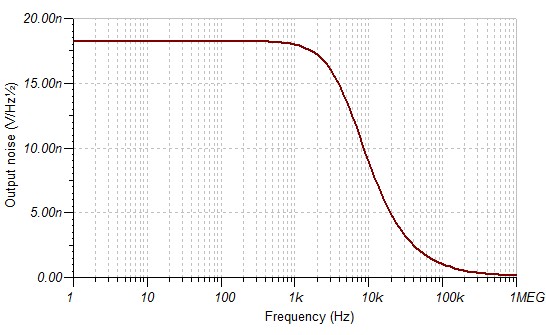

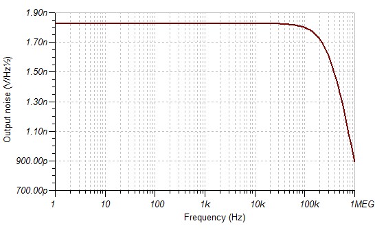

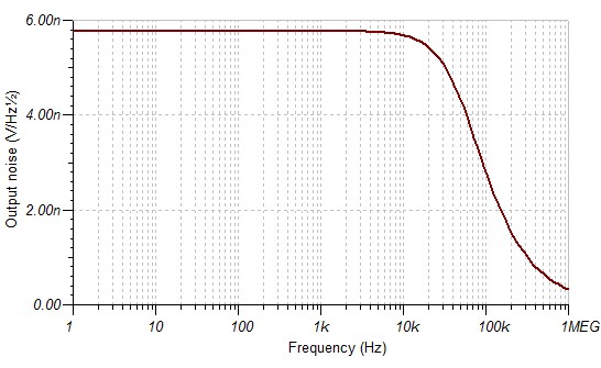

U U130421 Disabled Account Joined 2015 2020-12-09 3:24 am #3 2020-12-09 3:24 am #3 woody said: Would anyone know the noise figure of a Irf610 operated at about 40ma ? Click to expand... This what Tina simulator gives for 40ma/15V for source impedance 1k,10k,100k
