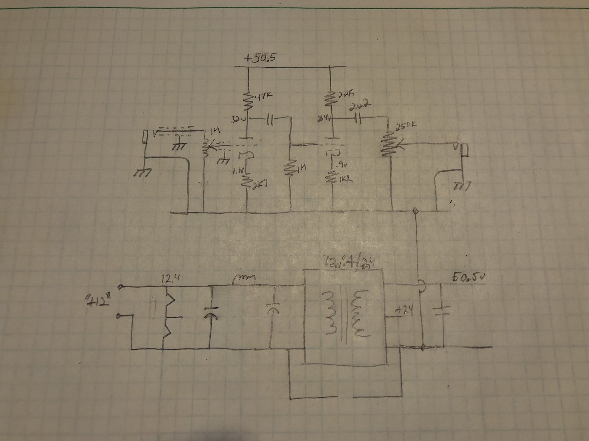

Schematic attached. I’ve now isolated the jacks from chassis just to be safe despite what the schematic shows (no change). The line beneath the converter can be bridged with a header. With the header I have hum, without it I get a little additional sizzle noise but essentially the same. Originally I had a 1nF cap there per the datasheet for ripple reduction.
You show both input and output connected to earth. Is that chassis? How is that physically, is there a distance between those earth points?
Is the 12V input grounded somewhere?
It really depends a lot on the physical layout to judge what ground current are common to what, and how they could generate an input hum signal.
For instance, if the return current from the 50V supply runs through a common ground bus or the chassis, and the input and output are grounded at different points on the chassis, you already can have a difference between the input and output grounds and that gives hum.

If the circuit 0V is connected to PE there should be no problems with leakage current from a 60Hz transformer, but leakage current is the only difference with linear supplies vs. Offlne switchers.
Leakage current though the heater to cathode interface can mean that the unbypassed 2.7kΩ on the first cathode can cause problems, especially if the heater insulation is failing. 5µA across 2.7k gives about 10mV of 60Hz noise - plenty enough for humm
Try 220-470µF across the 1st stage Rk, as an easy check on this.
Connecting the heaters and chassis directly to PE, and the circuit 0V to chassis via 10Ω should give the quietest setup, if you are powering the anode supply's switching supply from the heater DC

Thanks for the help. I figured it out and I was on the wrong track. My power supply is not regulated when set to 12 volts - so silly of me to overlook that assumption. It actually runs pretty hot so I added a 12v low dropout in series with the DC to DC converter to clean it up. That did the trick.
