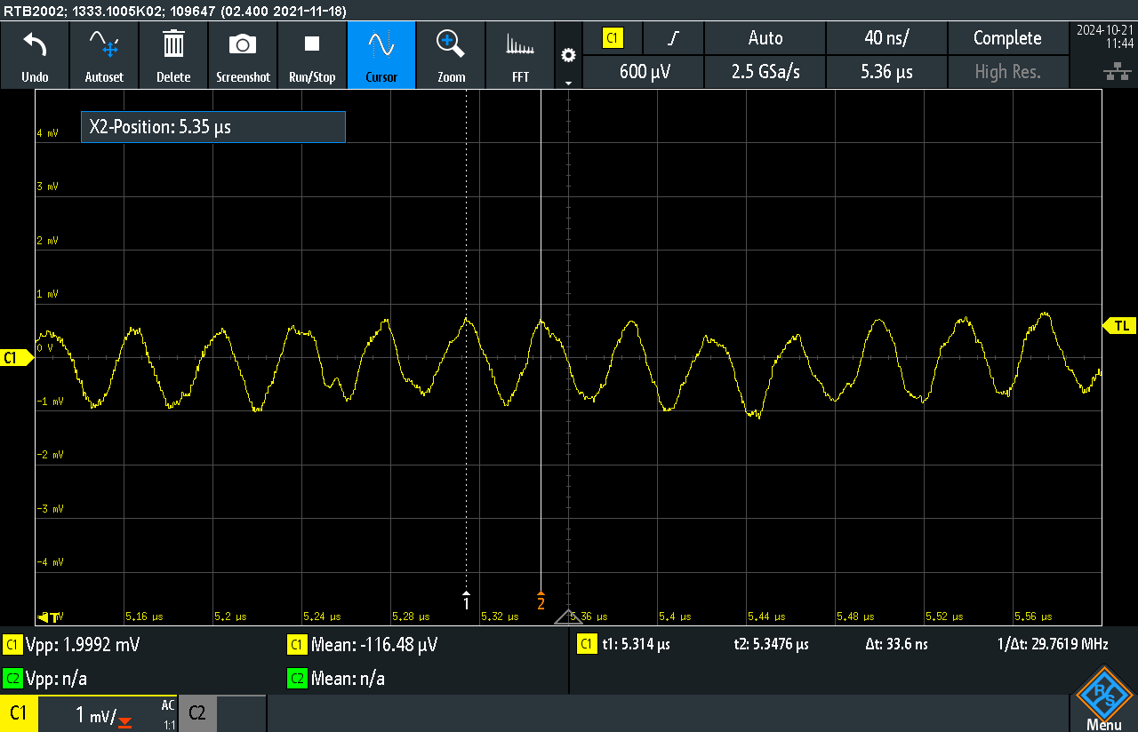

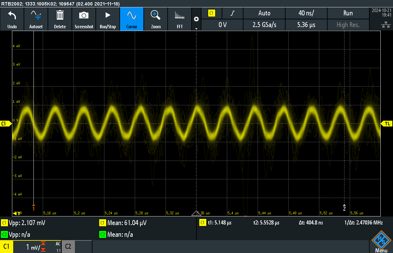

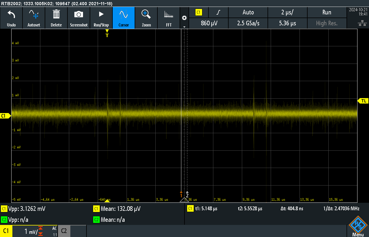

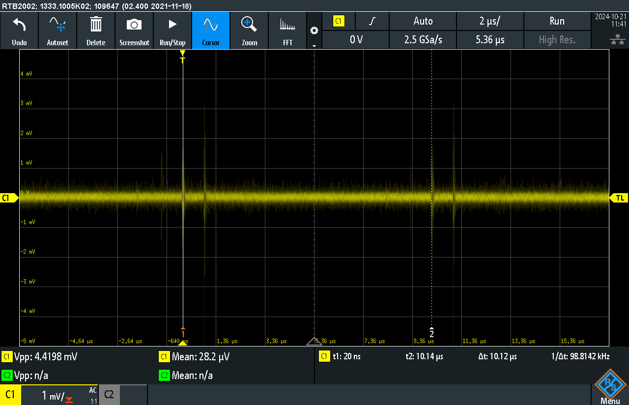

Building a power supply for my audio preamp. The build is based on Rod Elliots ”Power Supply for Preamplifiers” using LM317 and LM337 but get noice/oscillaitons - 100kHz, 4.5mVpp and intermittent ~30Mhz, 2mVpp
How can I remove these 100kHz and 30 MHz oscillations?

It is ceramic caps at the output. I just now removed the ceramic cap and the oscillations remains. There are ceramics at the regulator inputs. On the inputs tried with MKP Polypropylen but noice increased.

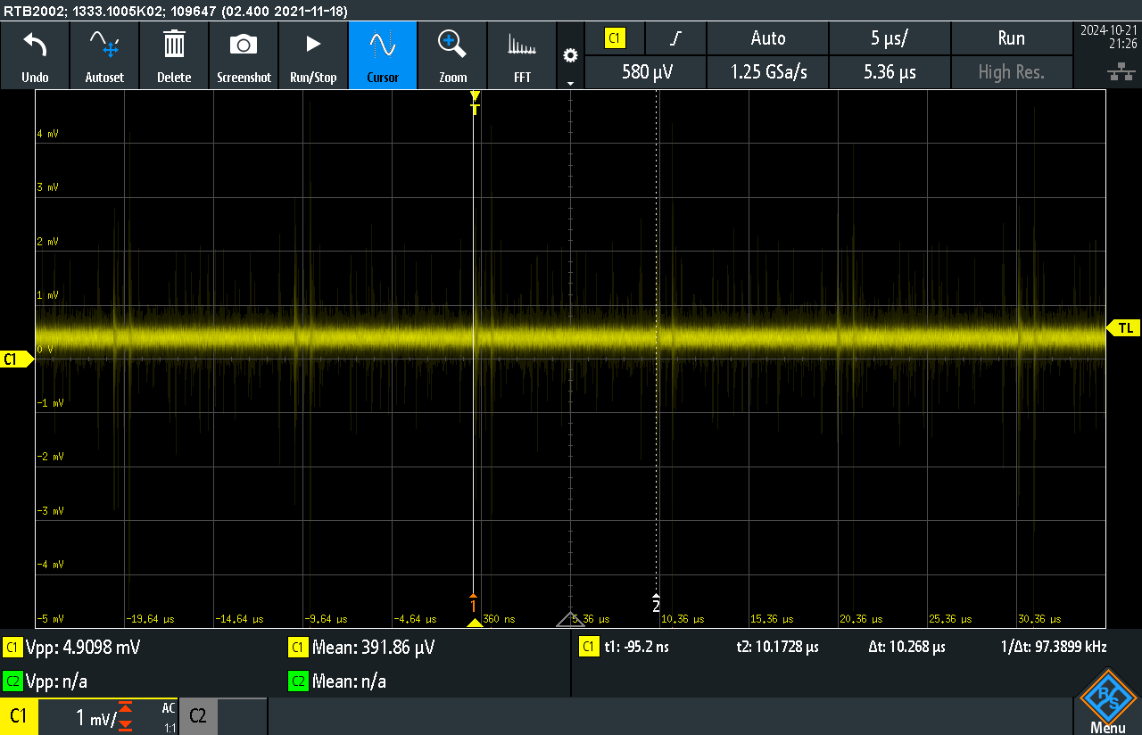

Separated diode bridge and caps (2200u +10R+2200u) from the regulator circuit - measured at the last 2200u cap. 100kHz spikes are there. Please see added screen dump …. Weird.
Have included pictures from my circuit with still separated caps 2200u and regulator circuit.

Just one thing to check, I have a magnifier lamp that contains a round cfl bulb. If I measure anything with that lamp on, I get way more noise than I was expecting, so I have to remember to turn it off for any measurements.
It may be worth checking that you don’t have a noise source close by.
I use Rod’s P5 PSU boards and have had no problems.
Looking at the data sheet, output noise is rated at 0.003%/V, so output noise of a few mV is expected.
A few mV on the opamp rails shouldn’t cause noise on the preamp output as the opamp PSRR is usually high enough to eliminate it.
Check that your preamp isn’t oscillating at 100khz, as that would probably modulate the psu rails.
Those are some causes I have experienced. Hope that helps.
