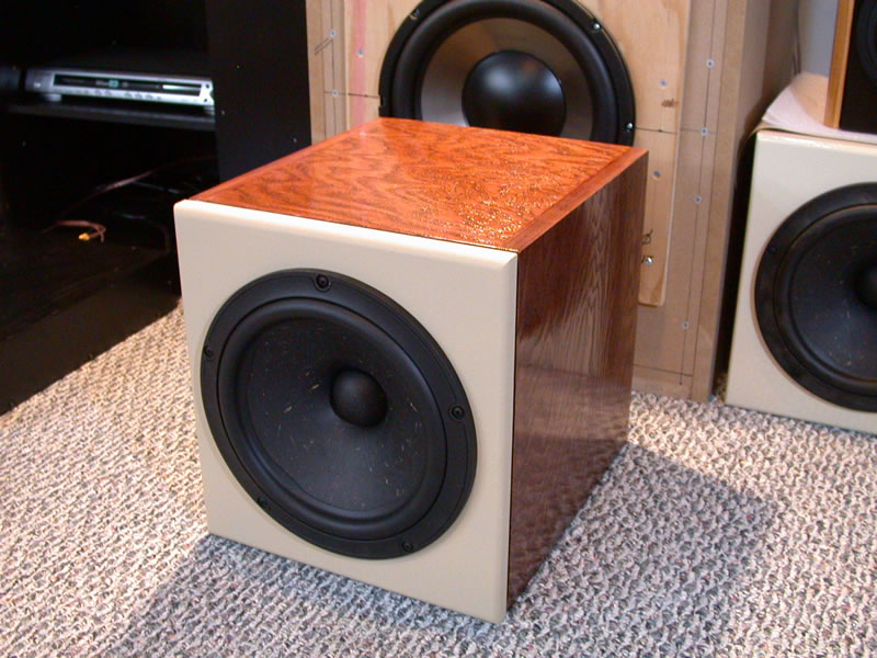

If you are interested in building your own I will share plans for a project I had planed before I became unable to build.

If you don't like what's available in stores you can consider DIY. If so inclined, you will be building all sorts of speaker projects (some more satisfying than others) for years like many on this forum. Then you can serve up your bass any way you like 🙂

I highly recommend this kit from madisound, no need for sub

Those are probably a great speaker, but with an f3 of 37 cycles, I'm not sure "no need" is what I'd say on the subwoofer issue, but that's just me.

All speakers reproduce bass frequencies. It's a matter of how far down those frequencies have rolled off relative to the rest of the frequency range.
But if you want high levels of low frequency information to come out matching similarly high levels of mid frequency and high frequency information then you need big speakers.
Big speakers cost lot's of money.
There is a limited market for big expensive speakers. That makes them even more expensive.
The buyer (us, you and me) determines what becomes available to them/ourselves. If we don't buy the big expensive speakers then fewer manufacturers will bother to design and retail them.
If you have the space and the budget then bass from floor standers is available.
