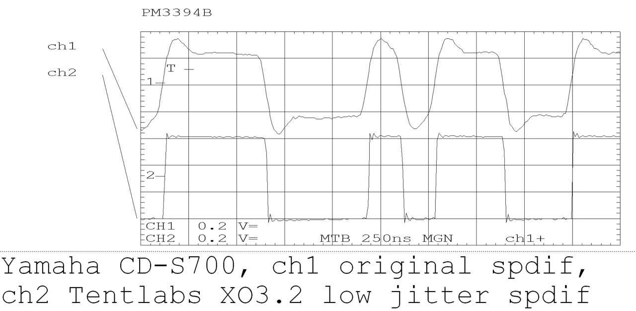

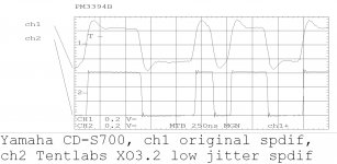

That is seriously a non-answer from Yamaha. Complete nonsense. I'd be willing to bet that if you looked at the spdif output waveform from the Yamaha on a scope, we'd find something very anomalous.
I did measure and modified the CD-S700 for a customer, using my XO3.2 low jitter clock / recheck module. Will return the machine soon, curious to see if the operation is successful. See attachment for results and bear in mind sampling scopes have limitations (may post picture from analog scope screen too).
best,
