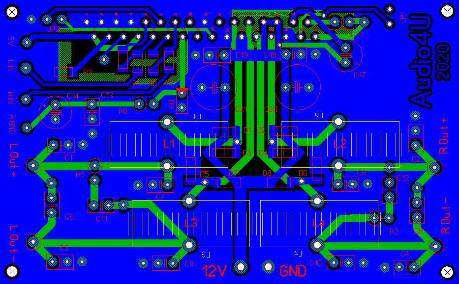

Thanks guys,
Why do you think so? Is it brave to run the amp like that?
Leo sold a few of those amps and they seem to work fine.
I really would like to implement the mod on my bords for the TA2020.
I also want to run the chip with a clean external 5V supply. Do you think the sound would benefit enough to do it.
I would really appreciate it if you guys could take a look at my bord. Please tell me what you would do different.
Thanks, Klaus

Hi
I read somewhere to remove input caps you must connect the source ground to biascap pin.
The bias cap itself connect to GND.
Do I have to remove the bias cap or simply solder the ground source to the cap ?
thanks b4
thanks b4
Hi Surya, you just need to connect the source ground to the pin or if that's too fiddly then the pin side of the bias cap.
DO NOT REMOVE THE BIAS CAP.
Also, you need to ensure that the source and the amp are running on seperate (isolated) power sources.
Generally this means that you must run one or the other off a battery.

Hi Radian,
thank you for the informative "How to".
I have used it to go capless on a Hifimediy T1 amp (TK2050 chip).
This is my experience:
1) The amp is dead silent, in the standard configuration with input cap.
2) I had some quite noticeable hum when I just connected audio ground to the bias pin without adding any cap (just the original ceramic cap). The hum went away if I disconnected the USB cable from my USB dac or the Ethernet cable from the PC driving it.
2) Paralleling, as you suggested, a 22uF cap with the original bias cap, reduced the hum level to barely (but still) audible. Would it go down further if I were to increase the cap to let's say 47uF?
3) I have not installed RF beads yet. Are they likely to reduce hum? If so what values do you suggest? Should they be in series with the various power and audio lines or should the relevant cables just go through them?
TIA
Giulio
