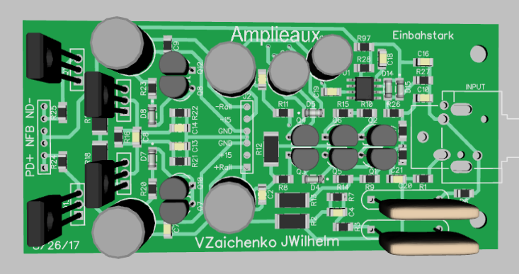

Hi All,
A Simpelstark amplifier has been prototyped, tested, measured, auditioned.
See the links below:
1) Version 1.1 schematic and PCB views;
2) Spectrum measurements;
3) Assembled board view.
I will most likely try to update the layout, designed by Alex MM, and test it later on.

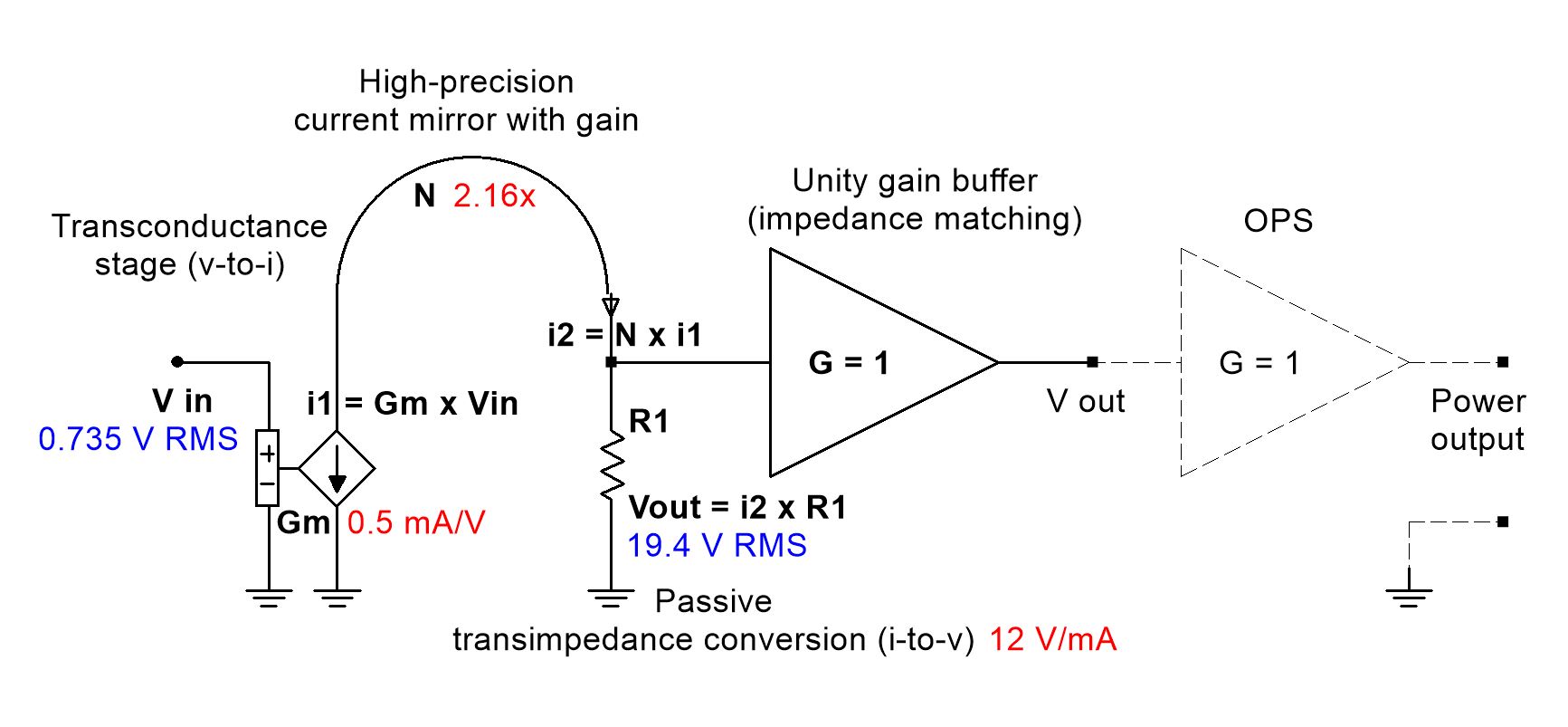

In this thread, I’d like to share my experience in designing an important part of any amplifier – the front-end, providing all the voltage gain – utilizing only local feedback loops.
Picture 1 illustrates possible arrangement in principle.
Input stage (transconductance, Gm = 0.5 mA/V) is a heavily degenerated CE circuit – that’s where the most of distortion is born, however at the volume of degeneration used, it’s low enough for the purpose.
Emitter degeneration provides a series-series feedback, providing the desired transconductance ratio and linearizing the transfer function.
2-nd stage is a high-precision cascaded current mirror with current gain of around 2x – highly linear mirroring with a little bit of gain.
Finally – passive transimpedance conversion – resistor load – also very linear, assuming both the output impedance of the current mirror and input impedance of the next stage are high enough.
To satisfy the latter assumption, we have to use a high-quality unity-gain buffer between this resistor and the OPS, as OPS’s input impedance, although it can be rather high, is normally more (especially in case of MOSFET drivers) or less capacitive and rather modulated (especially in case of BJT arrangement).
Small value capacitor provides minimal correction, eliminating possible frequency response artifacts above 1MHz.
It's easy to arrange a balanced input or a fully balanced architecture here - no global loops make it beautiful (just servo needs a bit of redesign).

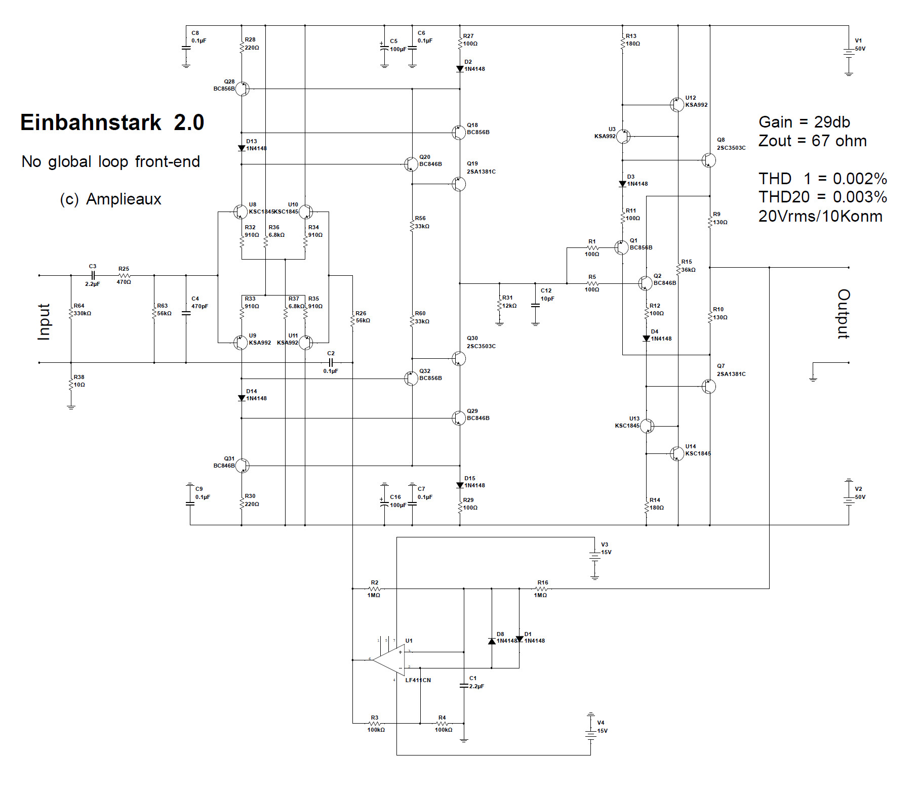

Picture 2 illustrates practical implementation of the above ideas.
The circuit demonstrates pretty good performance – although, I’m presenting simulated results here, I have measured and listened a rather close (a bit less sophisticated) design, showing similar results and sounding just great.

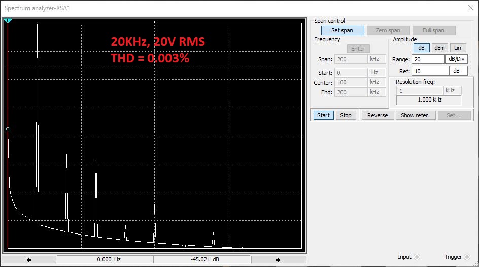

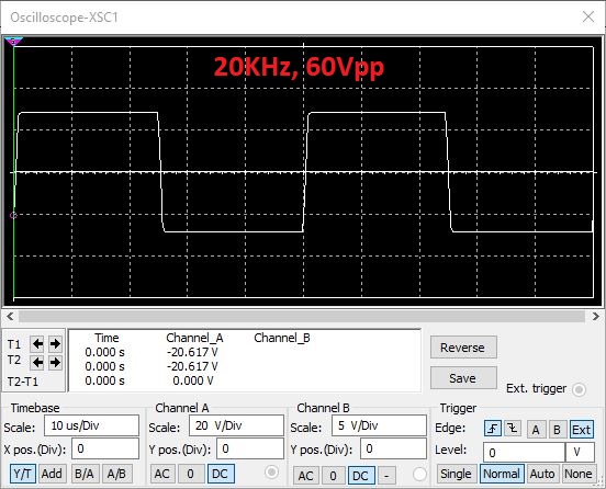

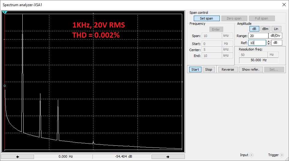

Pictures 3, 4, 5 and 6 illustrate:

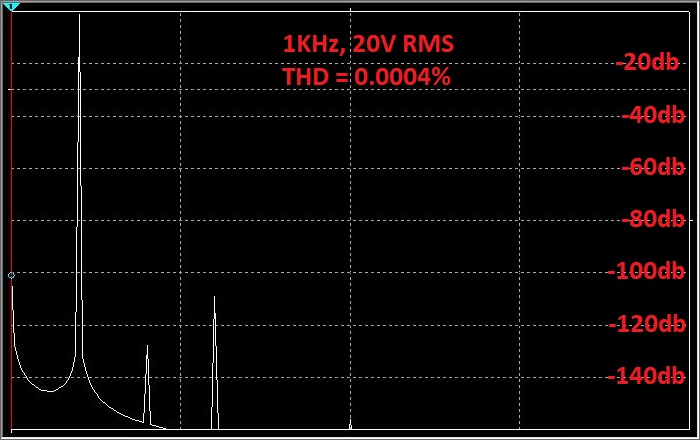

- Spectrum at 1 KHz (20V RMS0;

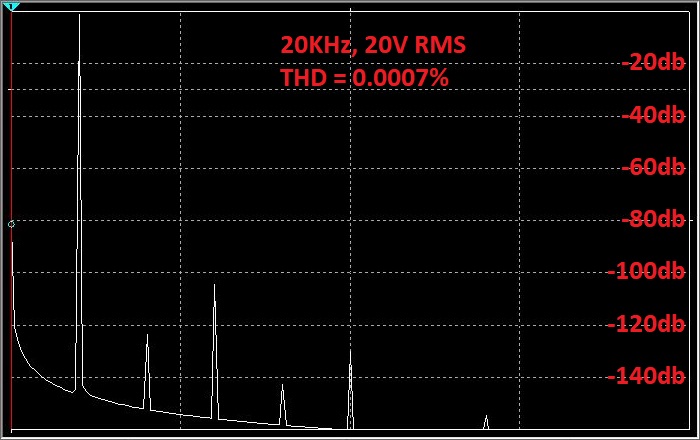

- Spectrum at 20 KHz (20V RMS);

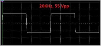

- Square wave response at 20KHz (60Vpp);

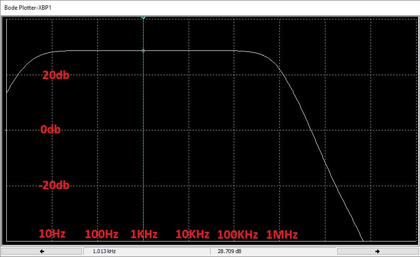

- Frequency response.
Harmonics 2, 3 and very little bit of 5. Looks like a spectrum profile from the vacuum pentode 😊
There may be many different implementations of the stages, including jFETs at the input, folded cascode instead of current mirror, simpler unity gain buffer, etc.
In terms of OPS selection – it must be a low-distortion one. Class A / AB (well-designed CFP, properly biased EF, MOSFET outputs, some error-correction options, non-switching arrangements, etc.).
I used NS-OPS, showing THD < 0.05% open loop throughout the whole audio bandwidth.
What do you think?

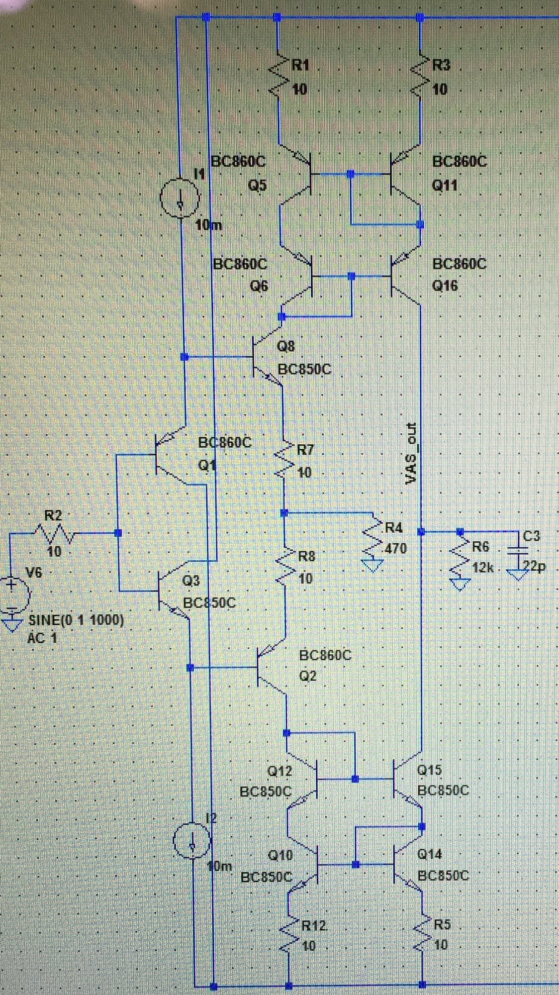

Hi, Valery!
Nice approach and good linearity.
It also could be done slightly simpler, without highly degenerated diferential stages, which in turn adds noise.
Something like this:
R4 define load of the input diamond buffer and also current consumed from rails.
Full Wilson mirrors reflects consumed current to I/V load.

Yep - diamond is a good one, I'm going to play with it :yes:
Using dfferential pairs makes it easy to arrange a balanced input.
On the other hand, we can try a dual-diamond configuration, for example.
Thanks for inspiration 😉

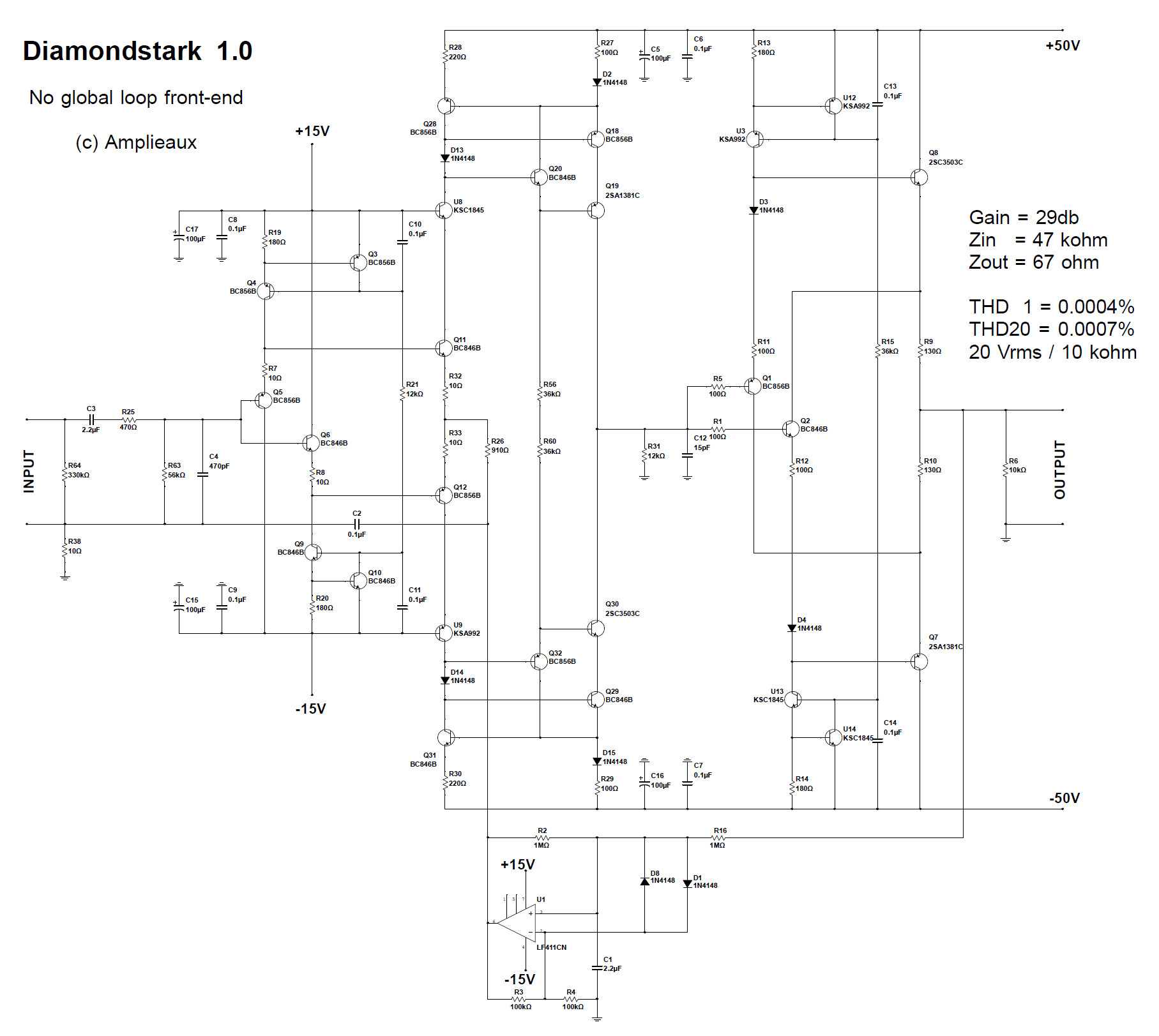

Hi Damir,
Good to see you here 😎
Part of the circuit, shown on the schematic, does not include OPS - diamond on the right is the unity gain buffer. Connecting the OPS right to the transimpedance stage results in significantly higher level of distortion because of OPS's input impedance modulation. Buffer does the job perfectly.
So, distortion figures shown on the pictures are true for the front-end only.
NS-OPS dictates overall level of distortion at around 0.05%, running open loop.
Valery

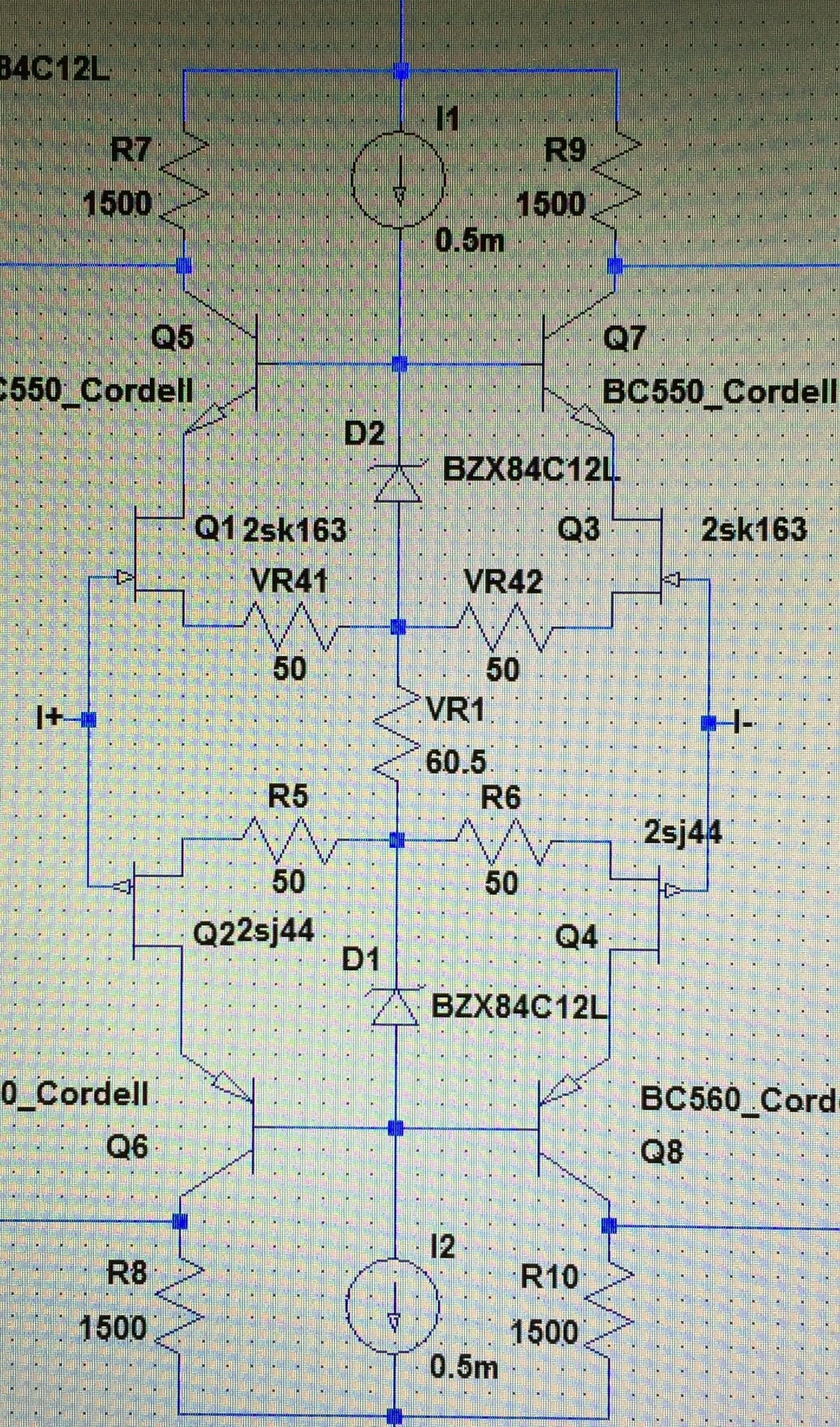

Valery, are you ever tried even simpler four-quadrant self-biased cascoded IPS like this?
Or matched arrays like THAT340/ALD1103? Last one have dedicated substrate connection.
THAT1206 seem to have 7 kOhm at input in-series and could degrade noise performance in low-level applications.
Hi Pavel,
Yes, I have used this kind of self-biased IPS arrangement, based on 2sk246/j103 pairs in one of X4 front-end options.
Noise - at low levels yes, but at line levels - no problem 😉

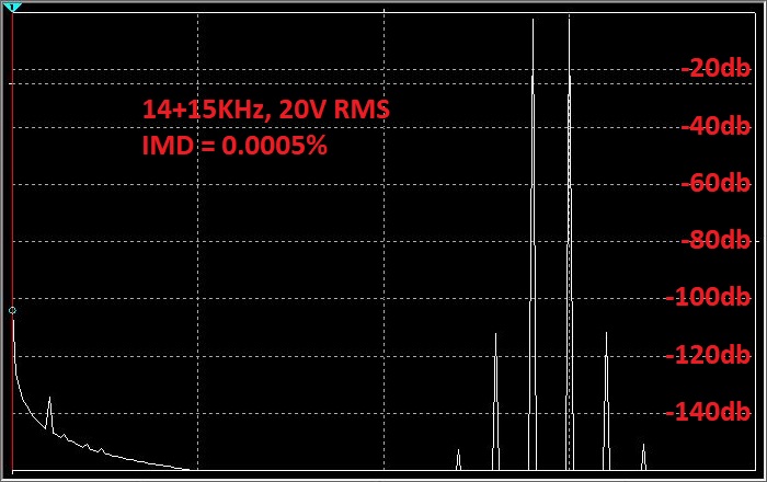

Diamondstark
Following Pavel's post, I have tested the concept with diamond IPS.
Initial setup did not include common base cascodes U8, U9 - overall distortion level was roughly 1/2 from what we've seen with differential pairs in place, still copying that initial profile.
The cascodes noticeably reduce 2-nd harmonic, improving overall performance, with 3-rd harmonic dominance. This configuration also shows rather good result in terms of IMD.
It's also cool to be able to use +/-15V regulated rails for IPS, allowing low-voltage complementary transistors.
Live performance is going to be slightly lower, strongly depending on components selection, as a number of important parts are either out of any NFB loop, or form the local loop itself.
