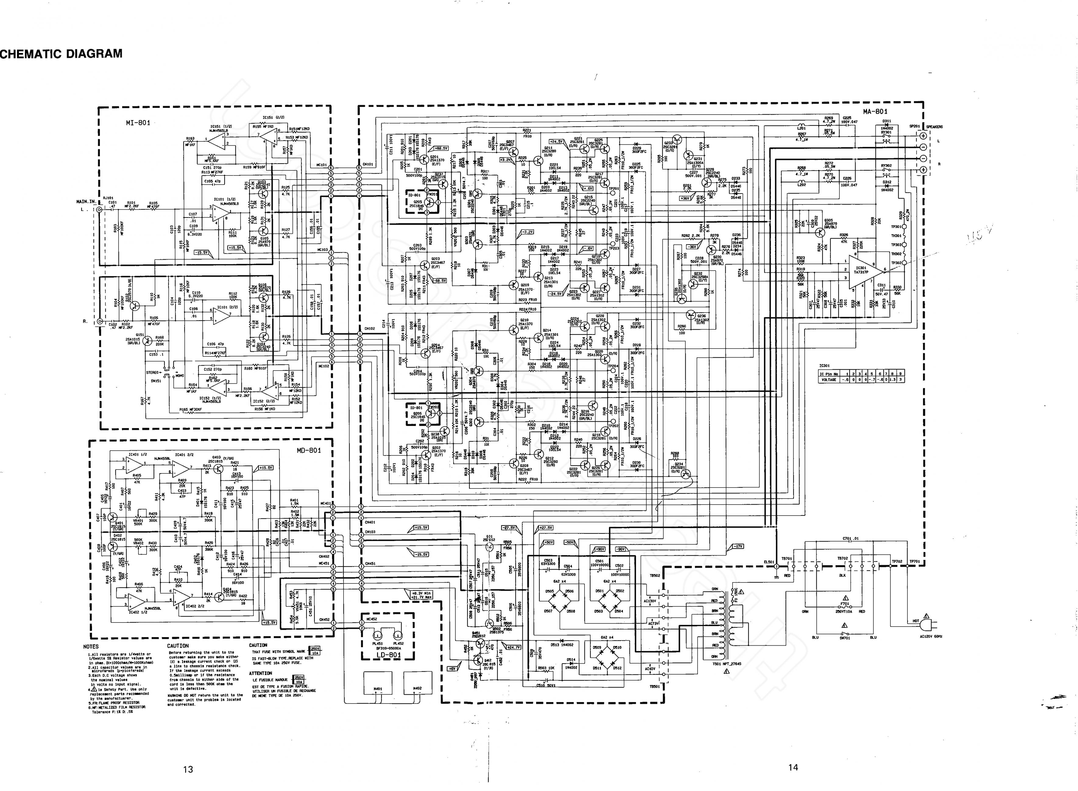

This is a very unusual circuit with the upper opamps being used to sense the actual load current to the speaker, and it seems that this varying quantity is then used to modulate the input stage... perhaps an attempt at a halfway house of voltage vs current drive.

The protection relay trips when a signal is applied to the left channel.

That is obviously a definite service bulletin to address a known issue so I guess you have to follow it. Sounds like the protection circuit is detecting the 1.5 volts as excessive (which it is... but "hard" faults usually give rail to rail offset). It might be instructive to look at the output on a scope and make sure that it is not oscillating.
