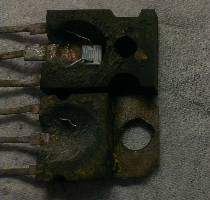

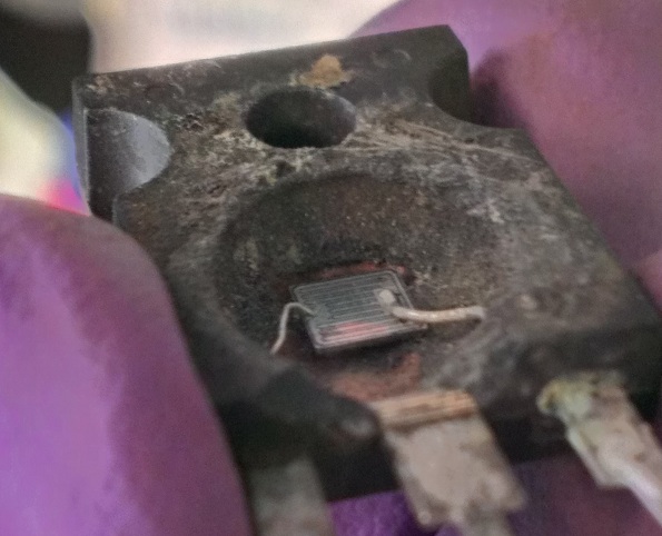

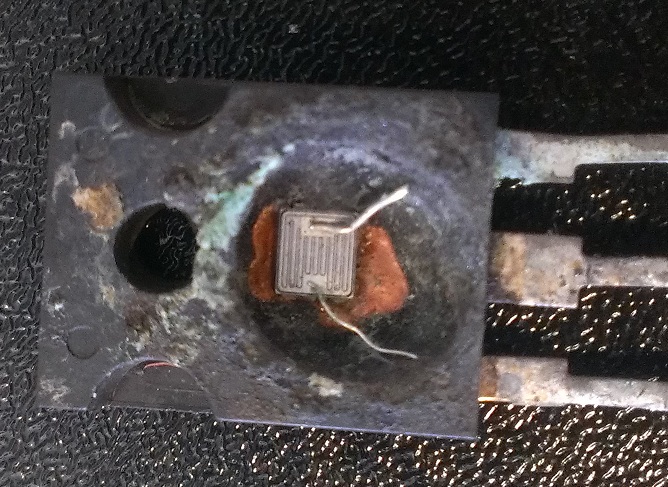

Sy is going to love this one! So I was reading around on the internet about how to detect fake transistors. It seemed like in general the fake transistors use an impossibly small die; usually around 3 mm2 where the authentic is around 25mm2. It seemed like the common way to open the transistor up was to use mechanical force and take a look at the pad for the transitor. Sometimes the die would stick to the metal side but usually it would either fracture or all you would see was the bonding material.
I came across a site that mentioned using 70% Nitric Acid and heat. Interesting...*taps fingers together like an evil villain*. I have 70% Nitric Acid, I have a couple transistors that are dead, I have a chemical hot-plate and I have a fume hood to do this in. 😀
Before we go ANY further, I am a trained inorganic/nanotech chemist. I know what I'm doing. If you don't this stuff could easily injure you or worse. The nitric acid off-gases poisonous nitric oxides as it reacts. It sputters mixtures of acid and epoxy. Let alone the acid itself, which is highly concentrated and a huge risk to use. I did this in a chemical fume hood, with the glass down to protect my face. I also had on lab coat, gloves, safety glasses etc. If you don't have the proper training to do this, DON'T!
So I get set up, turn the hot plate on, let the transistors sit on the hot-plate for about 10 min (turns out to be way excessive). Put a few drops of concentrated HNO3 and it starts bubbling and sputtering but not much change. I keep trying and after about 20 drops I can see some changes.
As I worked on them I realized a few things:
All being said, it took a while to do (maybe 20-30 min) and around 20mL of HNO3 to eat through the epoxy on the transistor.

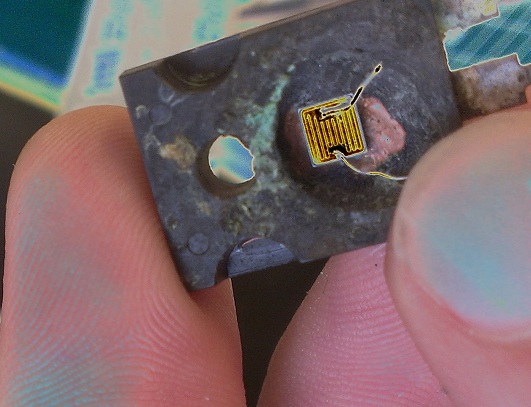

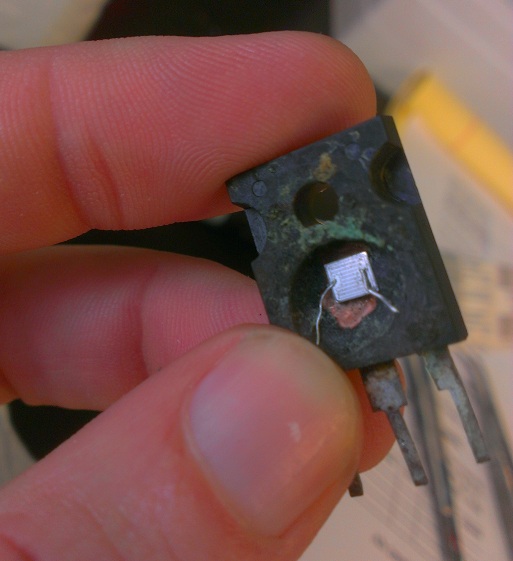

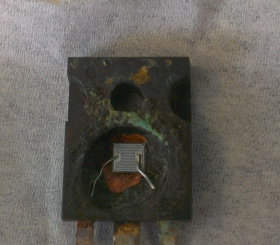

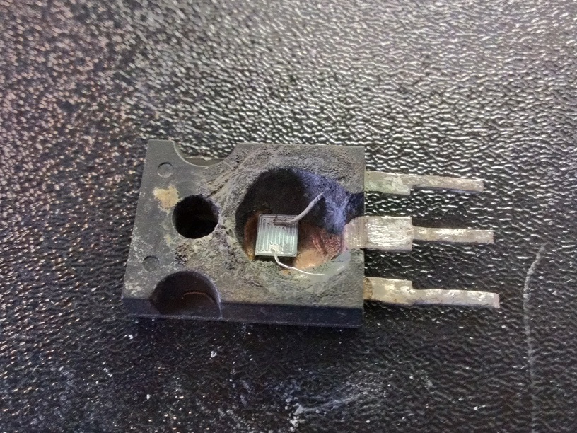

The end result? The die appears to be exactly 25mm2 so its not likely a fake. It also shares a lot of other traits with some of the pics I have seen of TIP35C and TIP36C broken open. Unfortunately, I didn't get all the way through the second one before I ran out of acid.
Anyways I think it made for some cool pics.
You can clearly see the structure of the die and the bond wires. I eventually mechanically broke off some of the epoxy to show that the metal base and the middle pin are all one continuous piece. In the third from last picture how it was preferentially eating the copper at this point (even eating it out from underneath the transistor die. Also, you can see the one which wasn't finished. The lead wires are just starting to show. Lastly, you can see how harsh the reaction was because the metal parts all used to be shiny.

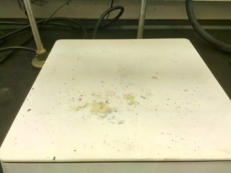

- Cover your hot plate in aluminum foil, it gets messy.
- If it is bubbling rapidly you are just wasting acid, it should bubble lightly.
- Add a couple drops, allow it to bubble up and reduce then add another for about 5 total drops.
- After 5 drops let it bubble almost until evaporated you will see the liquid get dark brown and thicker.
- Wipe it off with a paper towel at this point.
- Repeat

Nice; It made for some great pics. I guess since you said to cover the hot plate with Al foil that HNO3 doesn't attack aluminum as quickly as other materials? The bond wires are also probably aluminum with a but of Si so I guess that's why they'd survive for a while.

Aluminum is relatively resilient to strong oxidizing acids because they form a protective oxide layer. Though mixing sulfuric and nitric together will dissolve aluminum quite nicely. Yeah the bond wires are likely aluminum, the die itself of course is likely doped Si which will NOT dissolve in nitric acid.
