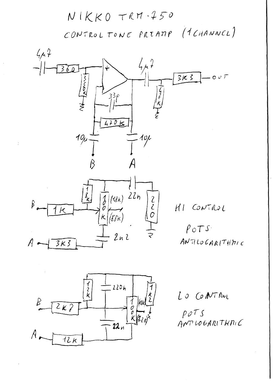

I'm putting my hands on an old Nikko trm-750 amplifier. I like the sound of the power stage, but the preamp is a disaster. I upgraded some components (IC, capacitors and so on), stabilized the power supply, and now all run really better.
The problem is that the line stage has a too high gain, and it is putted after the Volume-Balance control. The result is an useless very high sensitivity, with an avoidable background noise and an uneasy volume regulation (you can't arrive to the half position, it's too loud).
I didn't manage to find any schematics, so I taken the time to put on paper the control tone board. The result is in the attachment. I think that this kind of circuit was preferred to both baxandall negative feedback and passive circuits just to save an additional IC: with the adopted solution you don't have impedance problems, both in the input and in the output, but... changing gain is an hell! (for me, of course...😱)
Which kind of circuit is this? Giving an eye, it seems it can permit a + or - 20 dB tone control, that is waaaaaay toooo much. In this configuration, if I'm not wrong, the gain can't run below 1, so, considering this condition as the maximum tone attenuation, I'd like to transform this stage in a 6÷9 dB gain one, with the same amount of tone control (+ or - 6÷8 dB).
Sincerely, I have no skill to calculate new value, and the potentiometers must remain the same (100k, -logarithmic) for mechanical reason, so... any good soul out there that can help me??

Hi Max, to use a Baxandal tone control with a non-inverting amplifier is not optimal since the non-inverting amplifier gain is not simply the ratio setting on the pot. This is the reason why there are so many components in the tone control in that they are trying to compensate for the non symmetrical manner that the controls behave.
Changing any resistor value to change the boost/cut would also require a change in the capacitance to retain the turn-over frequency.

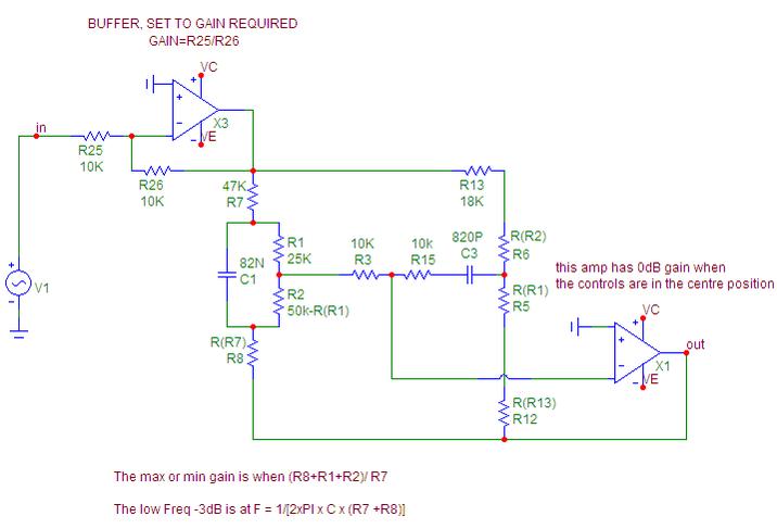

I would suggest that you by-pass the tone control of the amp and build the inverted tone control found in the AKSA headphone amplifier thread on a piece of vero board and then patch it into your amp.

Hi Nico, thanks a million for the replay. I suspected something similar, but sincerely I'd like to use this kind of topology. Is there a page to learn which are the interaction between components, and how to calculate values?
Just right now I discovered that the mechanical reason for the use of the pots are not so strictly, probably I can change them, so at least I can use the schematic suggested by Hugo in the Aspen headphone amp thread, post #732.
The optimum should be the same schematic with an overall gain of 10÷12 dB, but I'm not able to calculate it.

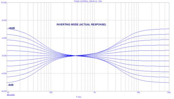

THE ATTACHED CIRCUIT WORKS WITH BOOST AND CUT = 6.02dB. THE SECOND AMP IS ABUFFER AND GAIN IS THE SAME SETTINGS AS THE POTS, IN OTHER WORDS IT HAS 0dB GAIN IF POTS ARE CENTRED.
THE FRONT END BUFFER IS SET TO THE GAIN NUMBER YOU NEED FOR THE AMP TO BE LOUD ENOUGH.

yes Nico, thanks a lot, a very useful reply to investigate in the inverting - inverting = non inverting 2 stage tone control. But I'd be very curios to know more about the non-inverting, single stage tone control.
From your answer, I understand you aren't too much involved with this configuration, so I'll not ask you any additional effort but some information (internet pages, books and so on) where I can learn more about this kind of topology (if this information are available, of course...)

Here is an extract from an e-mail to the AKSA thread, I hope this sheds more light.
Hi Nico,
Thanks for the email.
Nico Ras wrote:
> Tone controls should be seen as a simple single pole filters and it can be set to anything you desire. The calculations is equally simple and you can try it on your simulator. If you were just playing with values then you are in the bush because nothing will seem logical.
> Firstly decide on the boost and cut (usually the same to retain a simmetricl range around 0dB. This is the most usual.
Plus and minus 8dB seems about right to me, 16dB from full boost to full cut.
> The amount of boost/cut is the ratio between the fixed resistor and the pot value. lets us say a fixed resistor value is 1k and the pot value is 10k. The boost/cut will be 20 Log 1k/(10k+1k) = 20.8 dB. One selects a pot value that would have an easily selectable resistor value to get to your objective.
> Another example the resistor value is 10K and the pot value is 10k then the ratio is 20 log 10k/(10k+10K) = 6.02dB
> The turn over frequency is just as simple, on the bass side you figure where the -3dB point should be and in the simple configuration as you had it all along with a single cap that shunts the pot, it is simply F = 1/(2pi x C x 2 R).
> lets take the last example F = 1/(2pi x 100n x 2 x 10k) = 79Hz. This is the point where boost/cut would be about 3dB. Pretty straight forward, no need to be a buff.
> The treble is slightly different, because here you have a series element which you want to resonate with the centre value of the pot and the fixed resistor. It can be reduced to F=1/((pot/2 + series resistor) x 2pi x C). From this it is obvious that Xc forms part of both boost/cut and turn over frequency. F = 1/((5k + 10k) x 2pi x 1nF) = 10k. Here you may use the simulator to run a few values, much faster than to calculate them.
