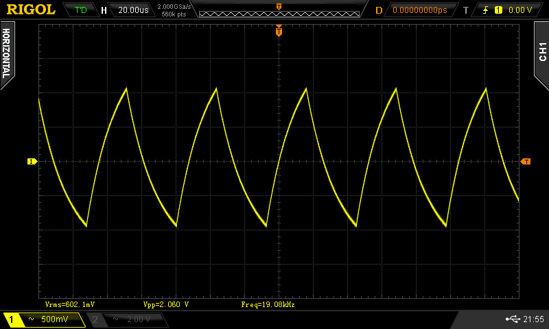

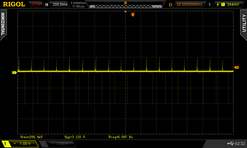

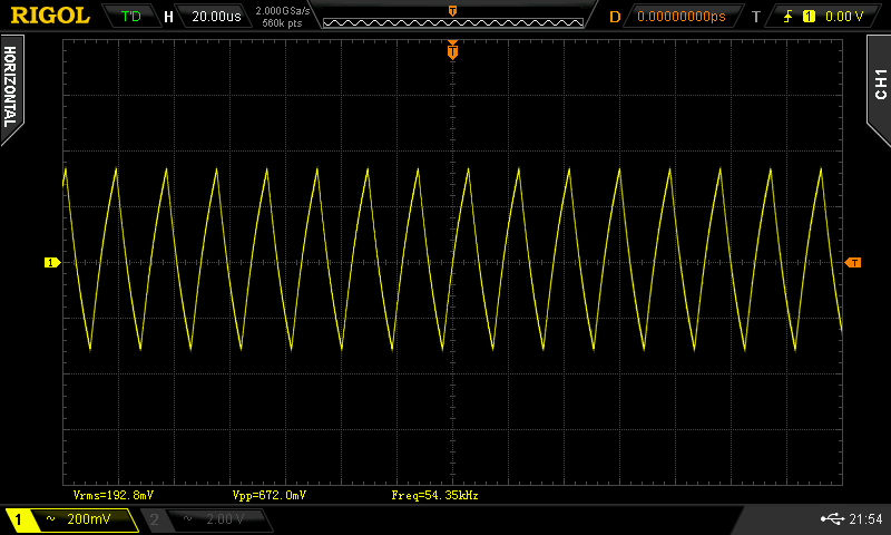

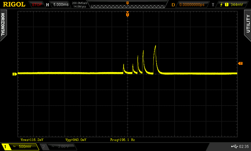

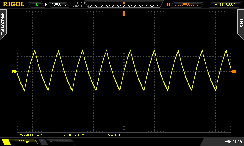

Here are oscilloscope captures of four DMM models capacitance mode output signals I took. Connected at their test leads with a coax that has crock ends and a male BNC on its other end. They send out a similar sawtooth style periodic signal of very different frequency each. The Fluke 87V differs by sending mainly negative going very short lasting pulses.I have an impedance bridge that measures capacitors very accurately at 1kHz. It's been professionally calibrated. I also have a Fluke DMM with a capacitance-check feature. Electrolytic capacitors always tend to measure lower on my bridge than on the Fluke. I've never been able to find out what test the Fluke uses. When I put a frequency counter on the Fluke on capacitance check, I couldn't get a reading, and I can't find a description of the test in the meter manual.
*All the above meters delay the more to dispaly a reading the larger the value a capacitor, thus they derive an answer through some charging time calculation.
