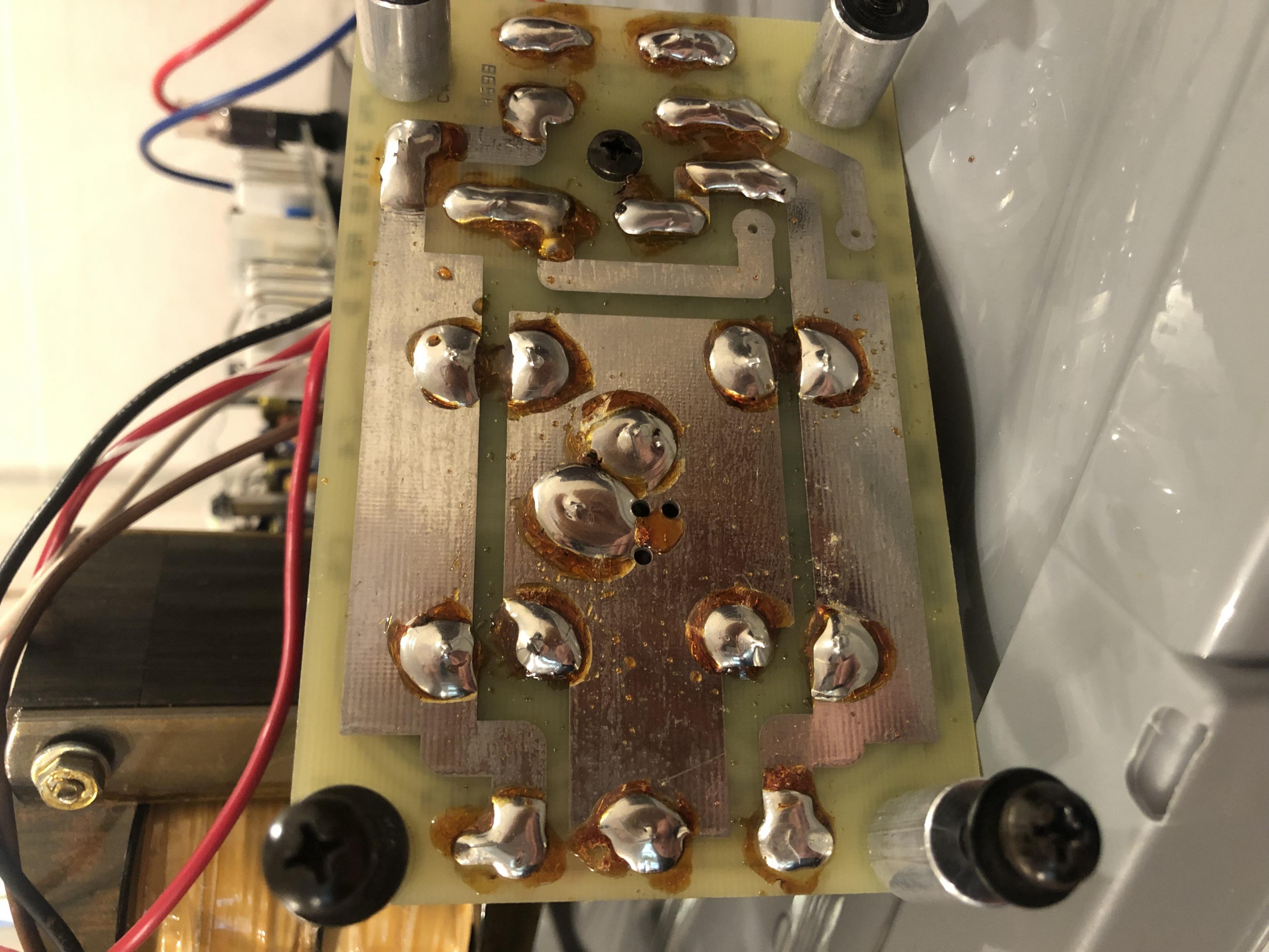

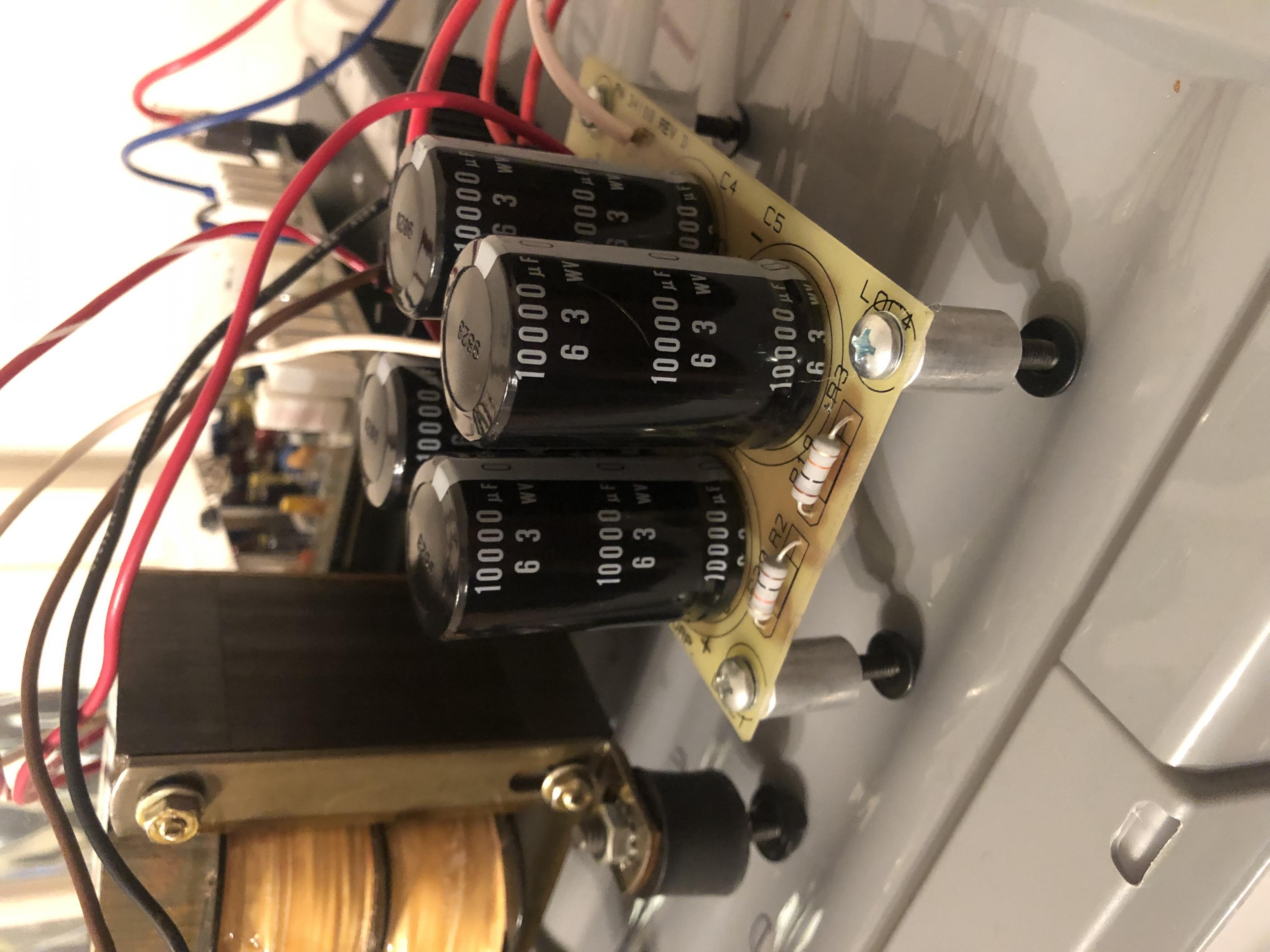

Just for reference, I've attached an image of the original caps + an image of the underside of the board... is that 'mess' from rosin solder flux or signs of another issue?

The caps don't look they are bulging to me. The tops have black plastic insulating discs which are slightly convex, probably due to the heat-shrink capacitor packaging squishing them - it is extremely common for that. Do the tops press down with a little finger pressure?
The amber stuff on the underside of the circuit board is the flux that was in the rosin cored solder used when the boards were manufactured. It is not evidence of deterioration, nor will it do any harm.

Tops are rock solid with no deflection at all - I took a guess at it being the caps as the sub was ok at moderate volume but lost control and hammered/knocked as the volume was increased.
