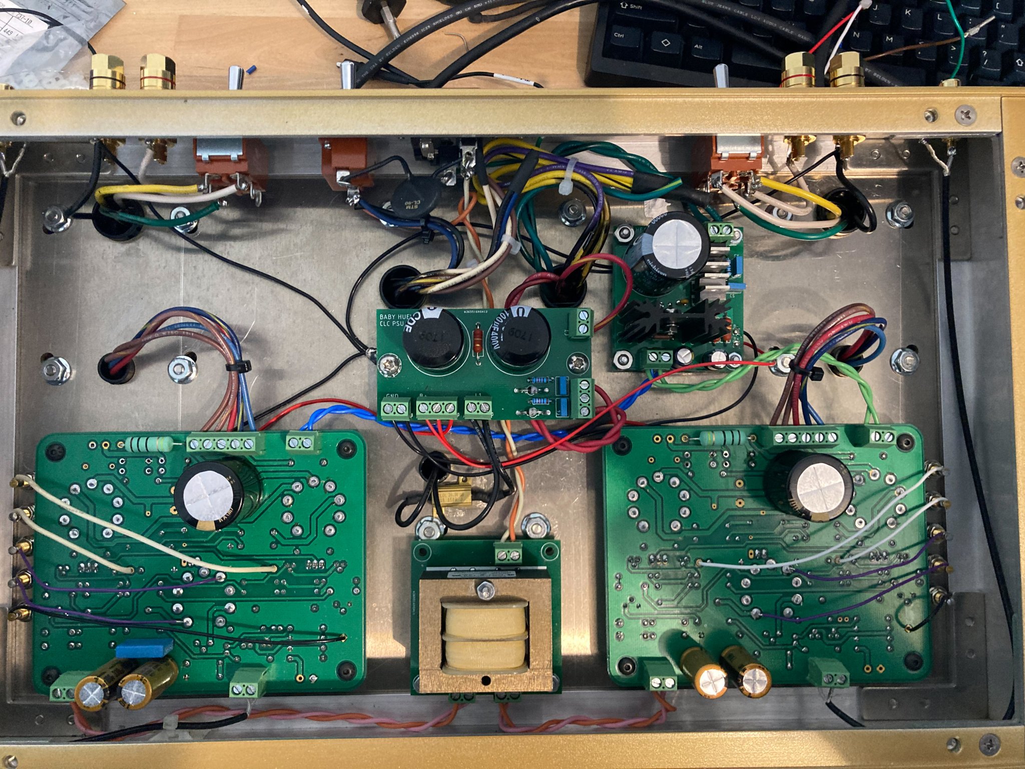

I started this project over a year ago and got sidetracked multiple times. Recently finished it, the amp was working fine but I was probing around and may have shorted something which resulted in one channel not working properly. Initial trouble-shooting shows incorrect plate voltage for the ECC83, I believe this shouldn't be too hard to fix.
Due to that, I am asking $450 shipped for this amp !
Cost of parts was between $850-$900.
Very high quality build, Hammond transformers, CNC milled chassis, powder-coated in gold (resembling some of the older Leak amps), Azuma tube sockets ($7/ea), Vampire binding posts, NKK switches etc. Toggle for 4/8 ohms, either of which can be swapped out for the 16ohm tap, regulated DC heater module.
Feel free to reach out with any questions

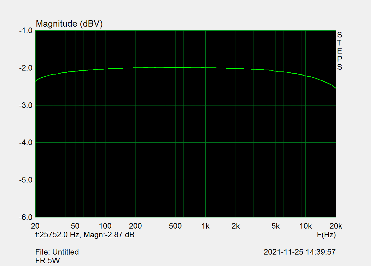

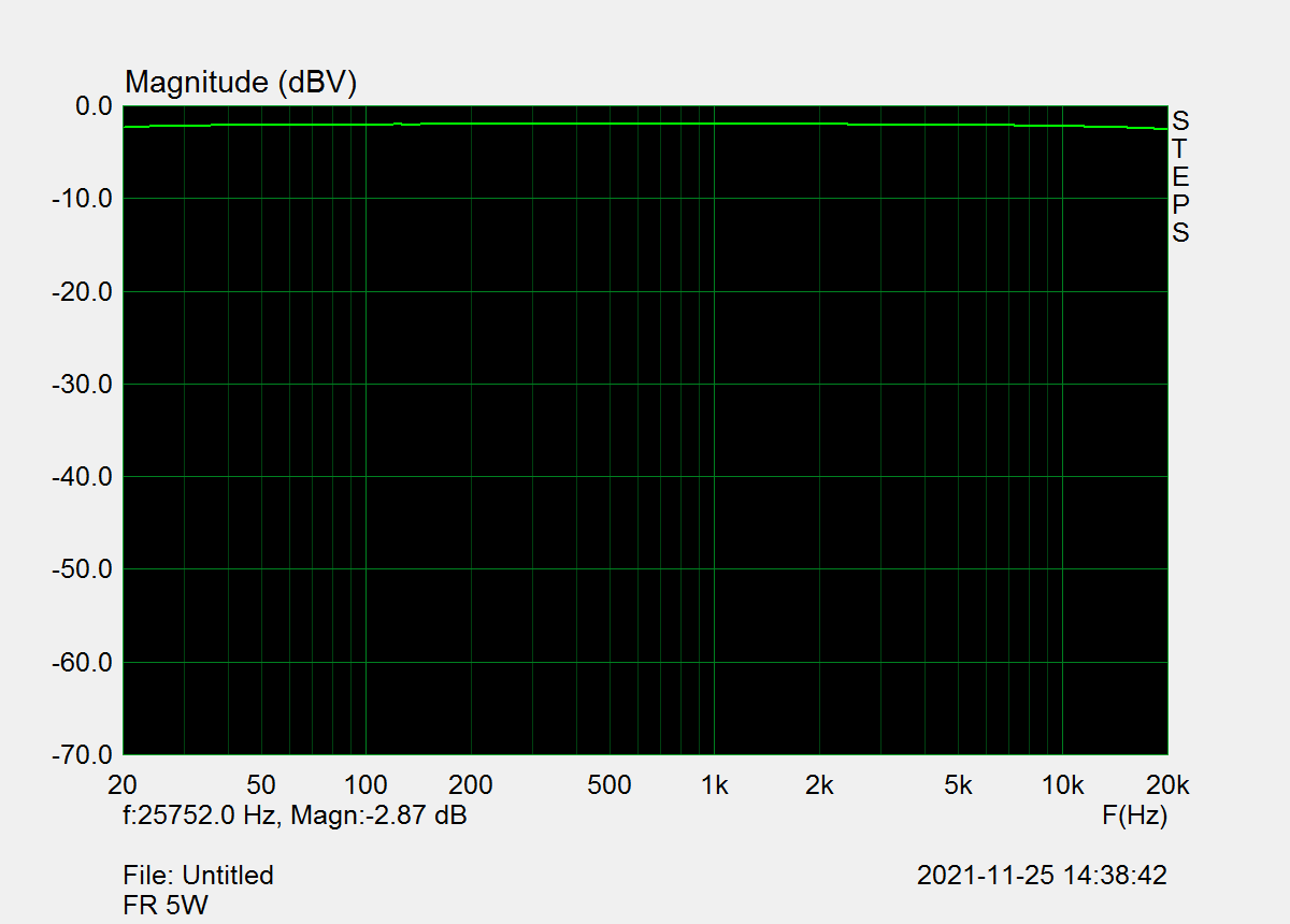

Here are some frequency plots I ran, one is zoomed to a 5dB window. As measured, 20hz - 20kHz is within a 0.5dB window so overall very nice IMO
Very nice build! You price is a steal - someone is getting a great deal. Good luck with your sale.
Looking at your photos it appears that you are using an AC heater supply. If this is correct, a DC supply will likely stop any noise.
Correct, I used AC as I read comments of this working fine for most folks. Generally AC should be OK for EL84's, I've had success using AC with the RH84's and the Tubelab SPP.
The hum I experienced was due to a ground loop (as it was cleaned up with the Jensen input transformer), but I do agree that using DC won't hurt and may even make things quieter. There should be sufficient room in the underneath to install one if someone wants to experiment

The hum was actually fairly low and my speakers are fairly efficient so maybe not really a problem, but I ended up trying a few things, such as adding a regulated DC heater and moving around some wiring and I may have shorted something on one of the boards as now I can't balance the input tube on it.
I don't have much time to deal with it so will knock off another $200 from the price, and will ask for $450 + shipping (excluding the tubes).
That is less than the transformers and chassis, but it is sold as-is.
If I have time in the short term I will fix it myself but then will go back to the previous price.
This is the latest state of the amp with the regulated DC module.
