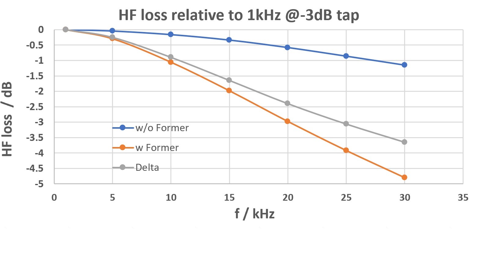

Of course I have made a measurement. The load is a 6 Ohms power resistor that has some inductance so I substracted its influence in the graph. I also built a filter with higher impedance and simulated equal response to see how much loss comes from the cables etc.

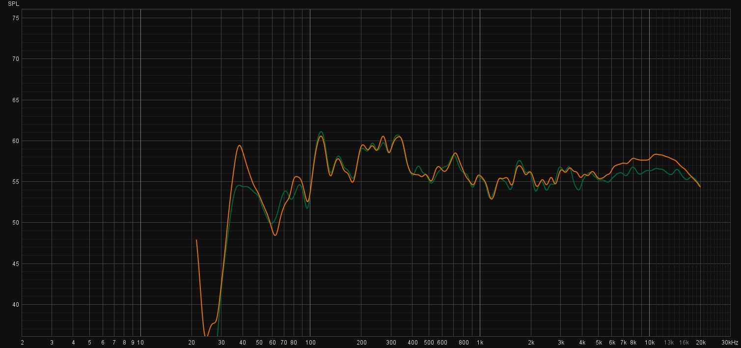

At 20 kHz the autoformer has an additional loss of about -2.3 dB and my cables add another -1dB. Compared to the resistive filter the on axis response has a big bump now yet it sounds smoother, which baffles me a bit. Glad I did not see those graphs beforehand and just tried them out.

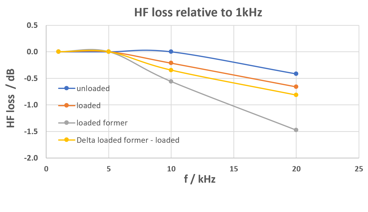

I tried another tap to inject the voltage (inductance is still above 30mH) and measured again with a different amp, which improved the corrected response quite a bit to -0,8dB at 20kHz. With a notch filter I managed to flatten the response up to 19kHz, which sounded flat and lifeless. The former definitely makes it harder to compensate for my Twetters´natural HF roll off and I decided to live with -3db @20 kHz. So do they sound so sweet because or despite of the HF roll off issues? I don´t know....yet
