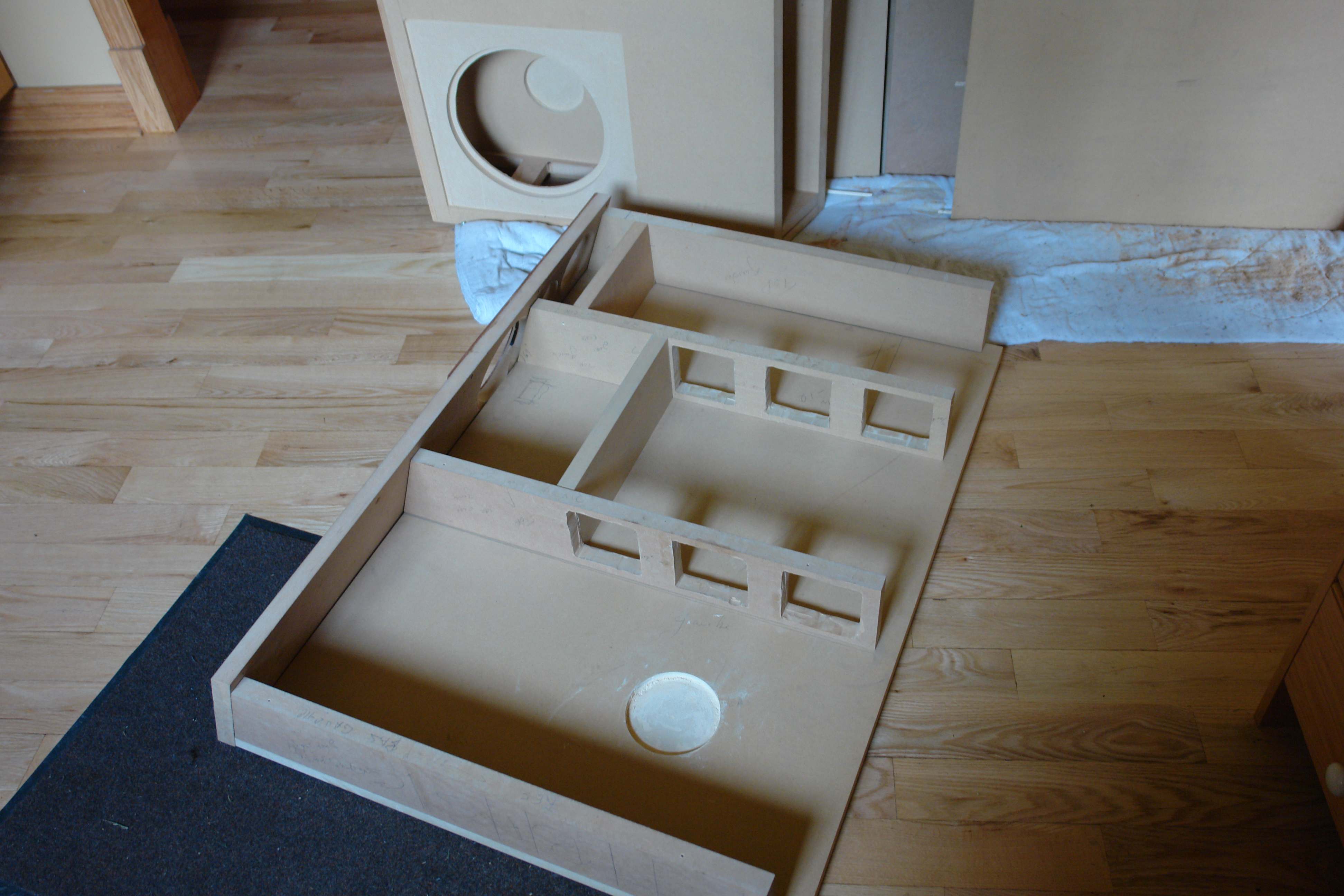

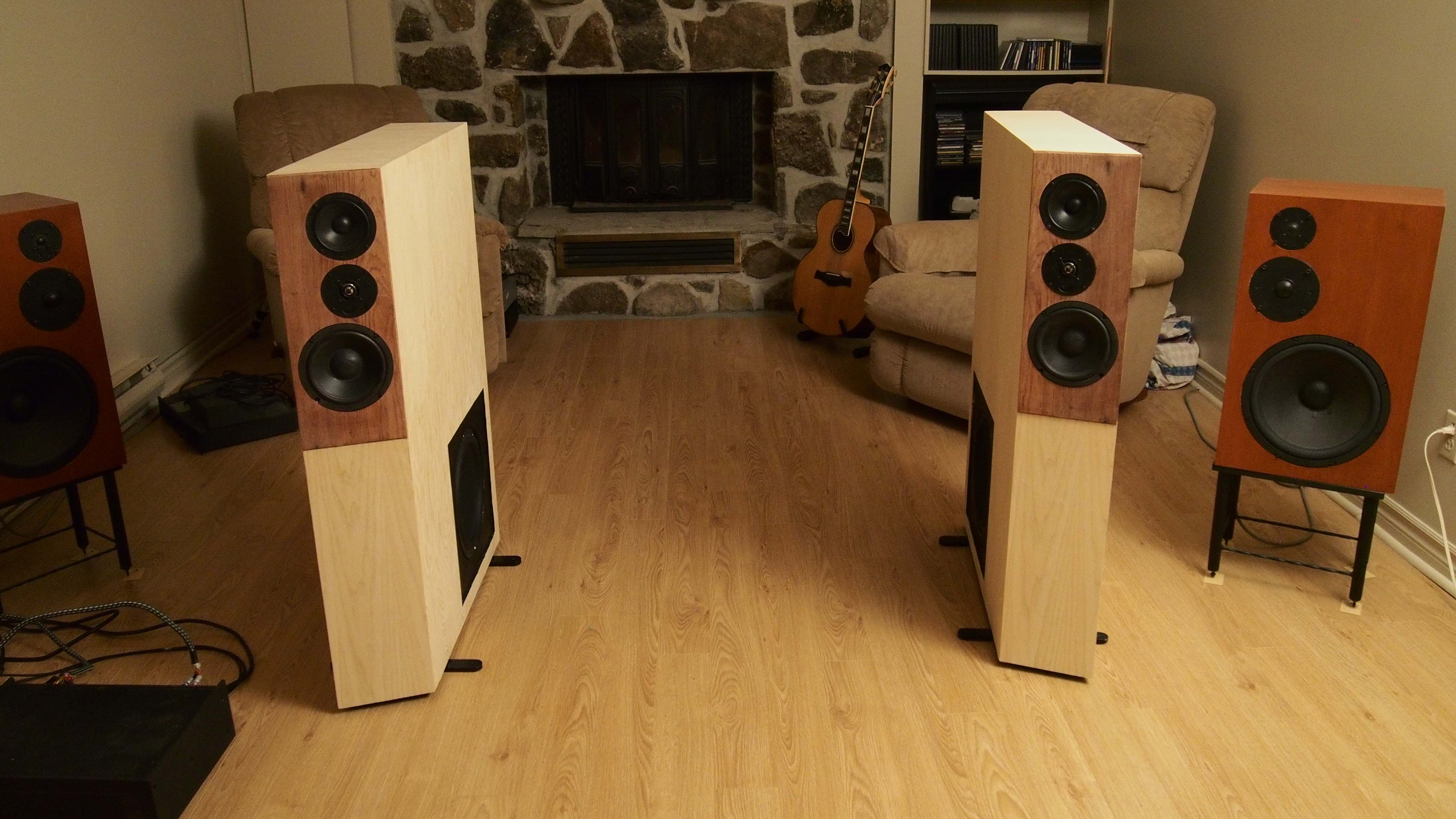

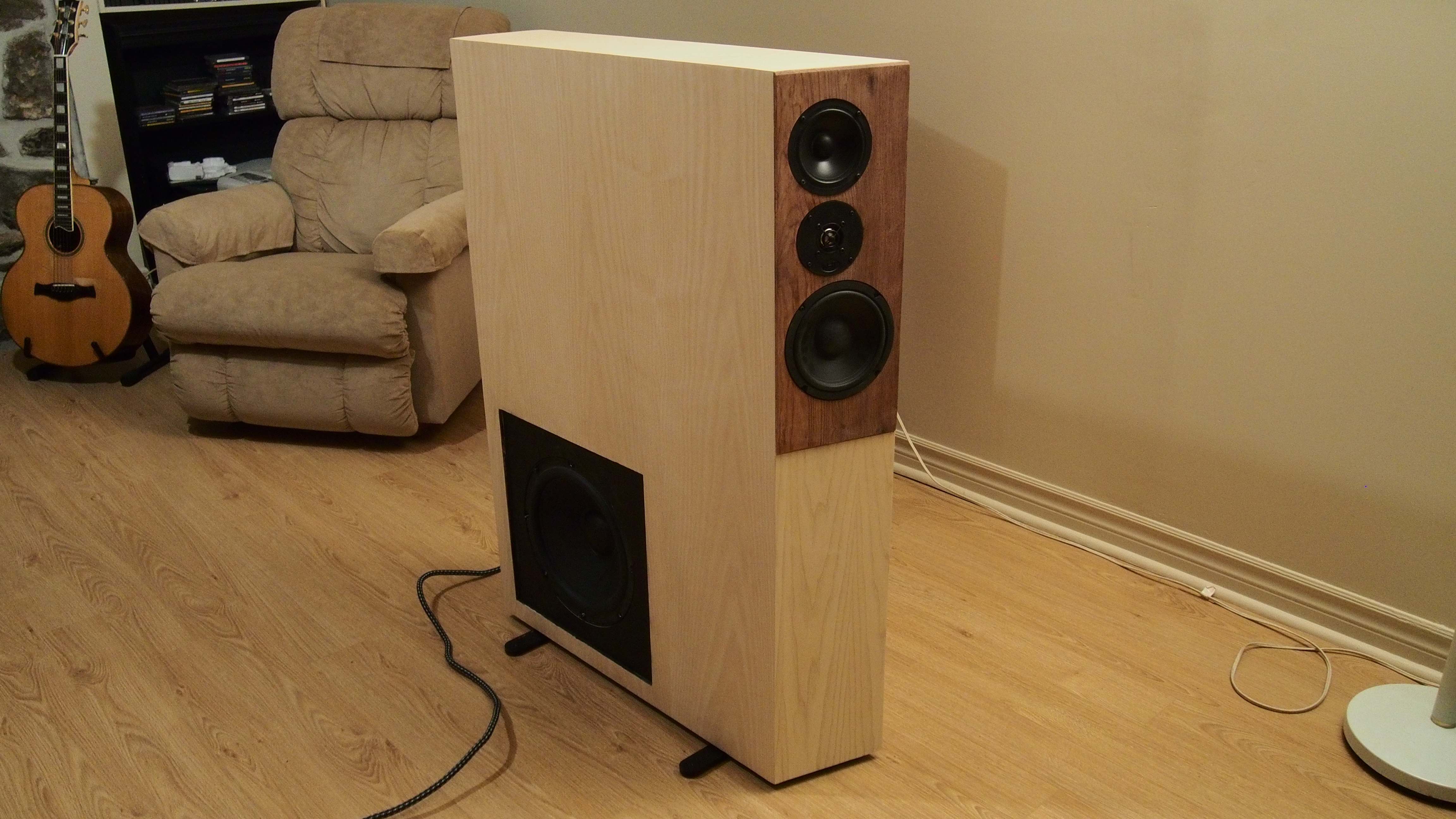

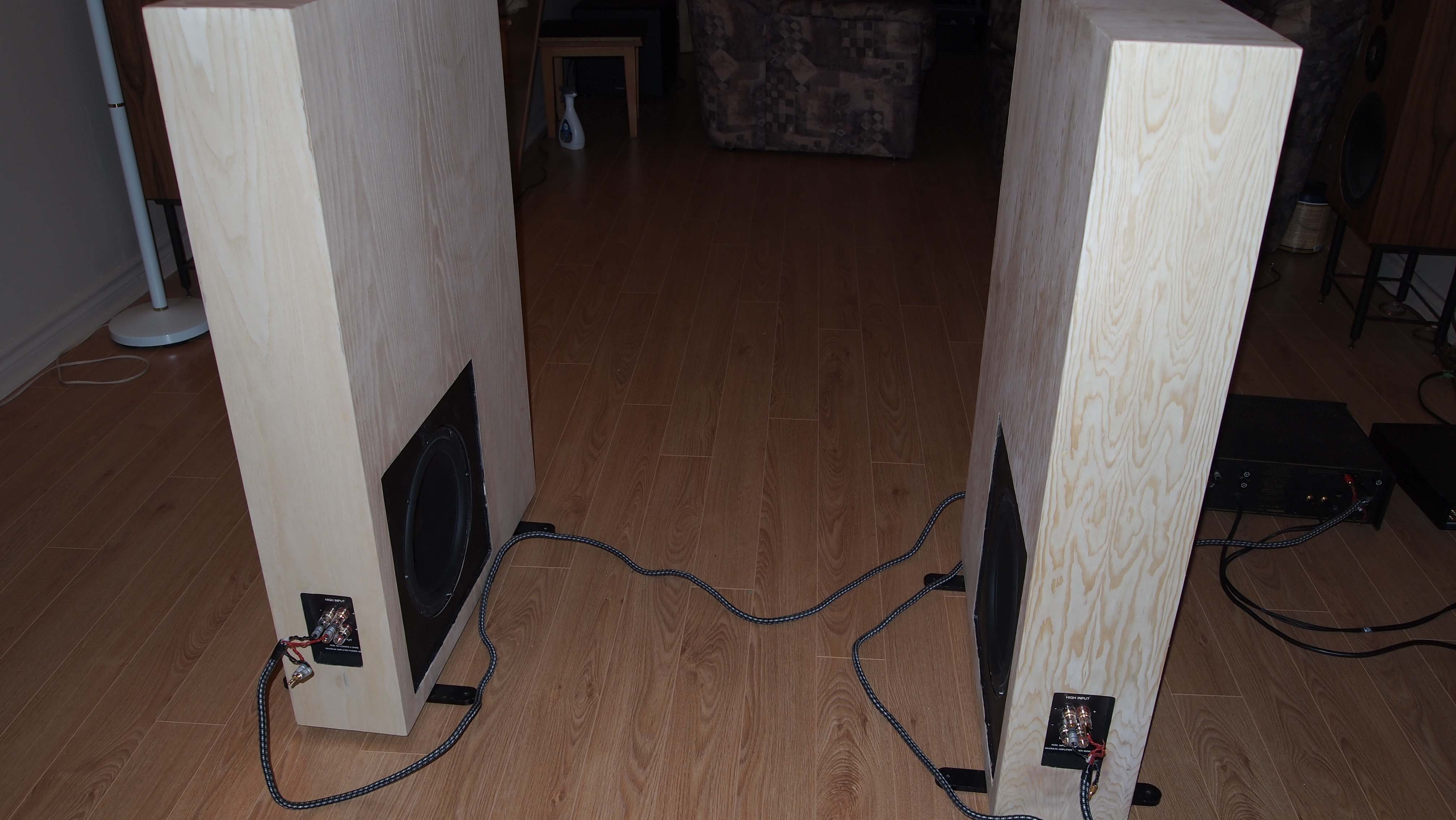

Thanks Pete. I'm finally done with the 3.3. I did replace all the electrolytic capacitors since the crossover was dated 1995. I took a reading of these '' old caps '' and I was quite surprised that they were still within 5 to 10% their nominal values so that I could not really hear a difference in sound... (maybe it's only me ). Then for the sake of clarifying doubts on how '' better film caps '' would make an improvement, I swapped them for Clarity caps ( ESA ). To me, Ken Kantor, Jack Hidley (and others forumers ) were so right !! Even though so called high end film caps, I believe it's a waste of money and time. Then, I decided I would push the experience further. I copied the original crossovers from the scratch. I used my Clarity caps, had all the steel laminated core customized to their original values ( so that I would get the same DCR ). Same for resistors and electrolytic caps. To summarize, in all three cases, I found no difference in sound quality of the speakers. ( again maybe it's only me...) They are now hooked up as front speakers in my HT with 2.9 ( also copied ) as rear and AC-2 as center. These speakers really sing, the 3.3 being favorite though. Special thanks to Ken Kantor, Jack Hidley and Peter ( PB2 ) for their precious help. P.S. : I'm not an engeneer nor a technician, only a passionate. I've only copied these great speakers. So, be indulgent if I can't answer questions that are too technical.

Nice work by the way! VERY NICE!
I'd enjoy hearing more about your construction project, or anything more about them.
How did you stuff them?
