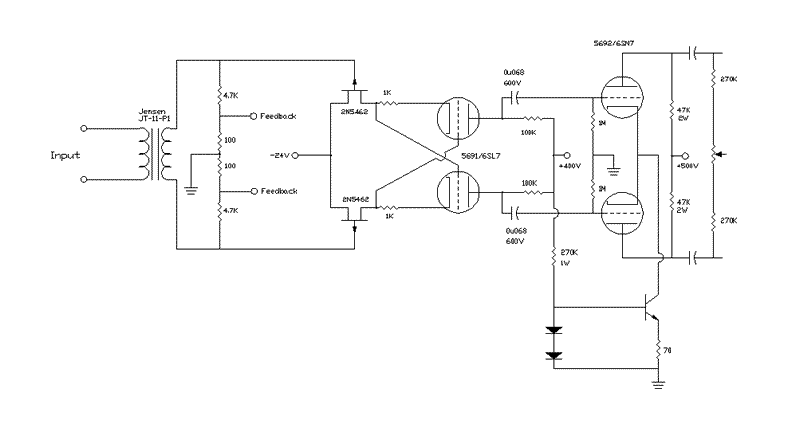

Want an exotic input circuit? Here's what I'm using at the moment in my Eico HF87 (also with 6.6K o/p trannies). Input transformers are, IMO, a better choice than interstage. You can get fancier with the current source, but I haven't gone in and measured the effect yet; the simple one seems to work and sound fine. The feedback is taken from the 16 and zero ohm secondary taps, with the 4 ohm tap being grounded. As you can tell, I like balance!

SY said:With a 6.6K p-p primary. the EL34 is an obvious choice. EL37 would be even better, but good luck finding those. I'm experimenting at the moment with some 6BG6s that I picked up on the cheap. These versions seem to be pretty much identical to the fabulous 7027As, other than the pin-out.
Thanks, .. how do you like the 6BG6 (sound character???), .. are you running them in pentode / triode and at what operating point / voltage?
The 6BG6 project is still a work-in-process, in the proto stage I demonstrated in the "Ugly Prototypes Contest" thread. I'm actually using EL37s in the Eico right now for listening; I think they're fantastic for this app, but they're my last set and finding/paying for replacements is well past my margin of pain. That's why getting the 6BG6s to work in this application is a high priority😉 When I'm done (I still have to check it out with some 4300 ohm trannies), I'll post the results. These tubes are really cheap, but might turn out to be something really special.

would they work? perhaps, but how well? if not as an IT, it might be possible to use it as a phase splitter on the input itself.
also, why might input stage iron be a better choice than IT iron (SY) ?
http://www.edcorusa.com/magnetics/audio/wsm/wsm10k-10k.htm
mentioned here
http://boozhoundlabs.com/edcor/
Why input xfrmers?
I prefer keeping voltage swings and currents through the iron as low as possible. So, 1V (more or less) is more appealing than 50V (more or less).
And a well-chosen input transformer gives you really good common-mode noise rejection. I'm using the Jensen JT-11-P1 (thanks to Steve Eddy for talking me into trying them), and it works as advertised, does a fine job producing a balanced signal, has good bandwidth and very low distortion, and is relatively inexpensive. So doing it this way kills two birds with one stone. The disadvantage is that it works best with a 10K load, which is a bit low for most tube preamps to drive. OTOH, Jensen claims that an RC snubber will allow higher load resistances; haven't tried that yet, but it makes sense.
