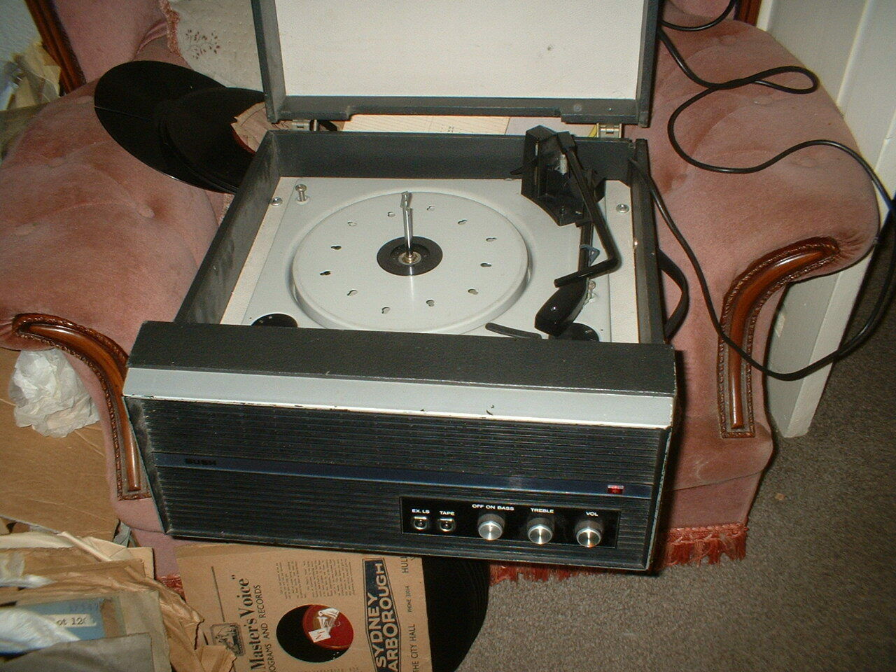

So, next project will be a small valve amp in a 60's record player. I am getting a broken Bush valve record player (rather like the popular UK brand Dansette, but cheaper to buy). It will need some modifications to sound good.
Look away now if you are of a nervous disposition.
I plan to remove the autochanger deck and all inner woodwork, cut the lid and fit a 10 inch Celestion and re-use the original controls for volume and tone.
You carry the amp by the side handle on stage like you brought your old record player, but you stand it up with the controls at the top and the lid/speaker facing forwards.
The existing chassis has two B9A sockets so it could be 12AX7 and EL84 perhaps. This thing dates back to the "live chassis" era - so I can't re-use the mains transformer 'cos there ain't one.

Let's not 'Beat about the Bush' - this project sounds like fun! 🙂
He he..
There's a sneaky trick I have planned. You remove the horrible elliptical speaker and the hole acts as a cabinet port.
Then you reverse the way the lid opens by moving the hinges from the back to the front. Now you can partly open the "record player" to increase the inner volume and also point the speaker slightly upwards. Some woodwork issues to consider but I think that is worth trying.
Maybe you don´t even need to cut much woodwork, if at all.
Start by removing the record changer and show what´s inside.
Will you keep the original 1 to 2W power level (meaning you can use the original OT) or add full PT and OT complement?
A single EL84 + 12AX7 let you make a tasty VOX AC4 clone ; or if using a couple ECL82 you have 2 pentodes, 2 triodes which can provide up to twice the power with the same number of bottles.
Not much power in any case so choose a nasty biting speaker to cut through the stage mud, such as a Celestion G 10 25 or whatever they call it now (whatever the old Marshall Lead 12 used) or Jensen MOD10-35 or similar.
A heavier bassier speaker like Celestion Tube 10 or similar needs more power than you´ll have available and in any case you already forfeited powerful Bass by choice of enclosure, something chimey will use it better.
But please show what´s inside 🙂

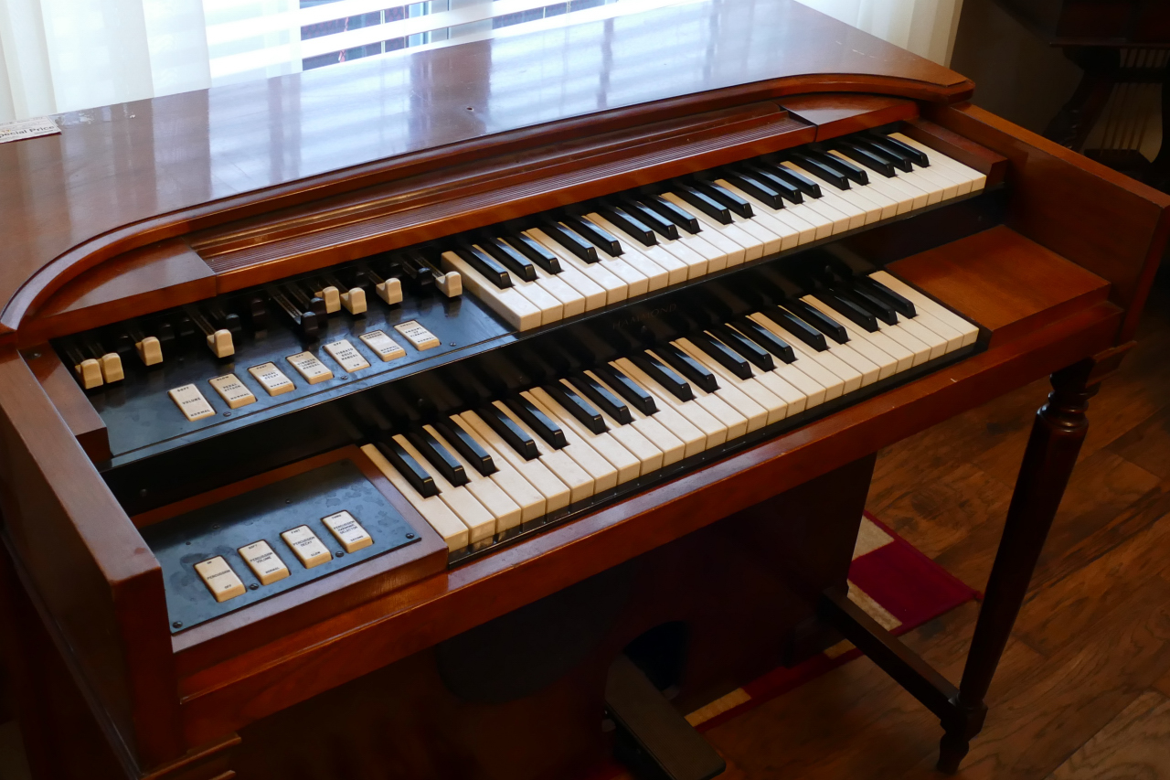

Fast forward about 50 years. My wife are shopping in a Goodwill store and I find THIS (see picture).
Yes, this is an original Hammond M3 drawbar organ made in 1958 in perfect working condition for $39.99. After playing with it for a few days, my first thought was "paint can" but now I'm rethinking this a bit.
The paint can did pretty good for a kid who played his guitar at one setting, full heavy metal racket. It's dimensions matched the frequency range of the guitar amp and speaker. The organ would like something bigger. Someday......

Probably a re-upholstered Bush RP40.
Shame no PT. The circuit is a fine low-gain 3 Watt practice amp. Send about 170V 60mA *isolated* DC toward the OT. Find some 50V power for the heater. Put a booster pedal in front. The Ten will make a big difference.

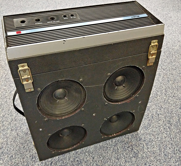

Here 's the progress so far. I have an old Bush record player which I have stripped ready for it's new life. The woodwork is pretty flimsy so I have put in some reinforcing to improve the acoustics of the box.
I cut the lid for four 6 inch guitar speakers and moved the hinge and clips so the lid opens the other way. It will sit with the controls at the top and I plan to cover it in red and cream vinyl eventually, so it has that Dansette look.
I test fired the speakers, and they sound better than expected. However they are new so will need some playing in. Hopefully it will be a bit more mellow.
Next I have to build the amp using the stripped chassis plates. This time it will be a three valve design. I'm using two 12AX7s and a 6V6GT. (That configuration is set by having a pair of B9A sockets in the chassis and a hole for an octal socket). So that's a gain stage + cathode follower. Then a driver stage and cathode follower, then the single output valve. So it's a bit like a Champ on steroids..
