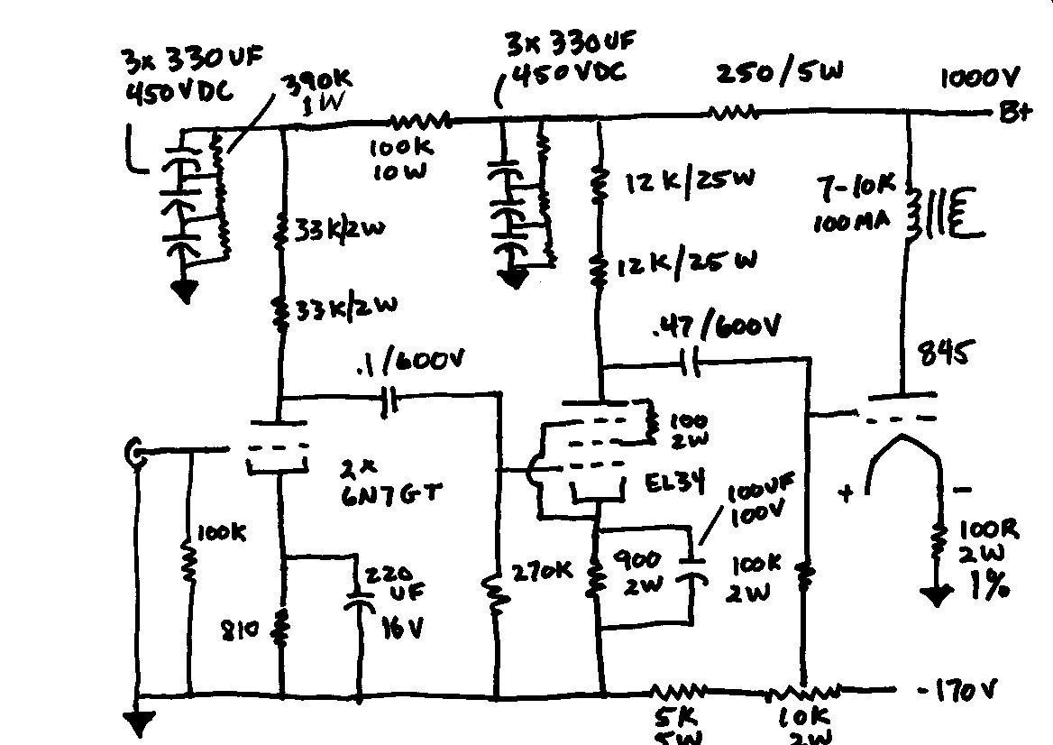

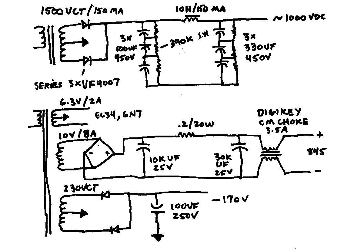

First of all, sorry to hear about the theft! What a pain. But to your question:
I built a pair of SE 845 monoblocks over twenty years ago, for a friend. He is still using them today. The circuit is quite simple, I've attached the schematic. Another friend built a pair and used them for 20 years until they got too heavy for him to deal with and he sold them.
That said, I'll never build an 845 amp again. The voltages are too high, the components difficult to obtain, and the weight is too much. Willsenton is able to make them affordable and reasonably portable because they can source OEM components and crunch a lot of stuff onto PCBs. But if I HAD to do it again, Hammond makes just about everything you need, including output, plate, filament transformers and chokes. It would probably be a pretty decent-sounding amp. I used Magnequest output transformers but those are no longer available. Today I use homebrew copies of 1950 Williamson amplifiers, good for 20 wpc, and to my ears they offer everything an SE 845 offers and more, in terms of bandwidth, control, affordable tubes and relative ease of construction. But I understand the allure of the 845--it's quite a sound.
However, it's a very big risk.

Reactions: Lynn Olson
