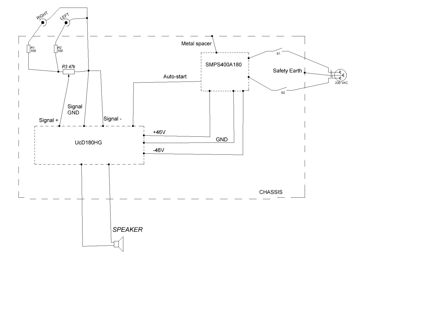

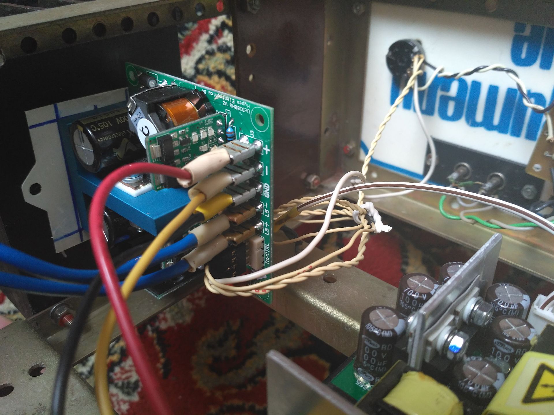

I bought a UcD180HG module and SMPS400A180 PSU and connected them mostly according to the Hypex recommended wiring for unbalanced input:
1) the "safety earth" from the mains is connected to the chassis
2) the PSU has a contact to the chassis through a metallic spacer
3) the "signal +" and "signal -" from the UcD module go with a twisted pair to a potentiometer ("signal +" to POT output, "signal -" to POT common pin)
4) the "signal GND" from the UcD module goes to the POT common
5) the POT input is connected to a CHINCH (positive pin)
6) the POT common pin is connected to the negative pin of the CHINCH
When running the amplifier with the input shorted (by the POT) - it is completely quiet. However, if I turn the POT to hear the sound - it is distorted. The kind of distortion is difficult to explain - sounds like the input audio modulates some high frequency carrier; it sounds metallic.
I am surprised by this and could not explain it to myself. I do not know how to troubleshoot the situation. The most trivial idea is to build a classic transformer PSU instead of the SMPS.
As most of you are more experienced than me, what would you advice me?

I have built a few Hypex amps and would doubt if your problem is due to the SMPS.
The amp is designed to take a balanced input.
Are you using an unbalanced input ?
Its difficult to follow your wiring description without a diagram but Hypex do have a technical information sheet on how to wire their amps for unbalanced operation showing in detail the cable wiring from a phono to XLR

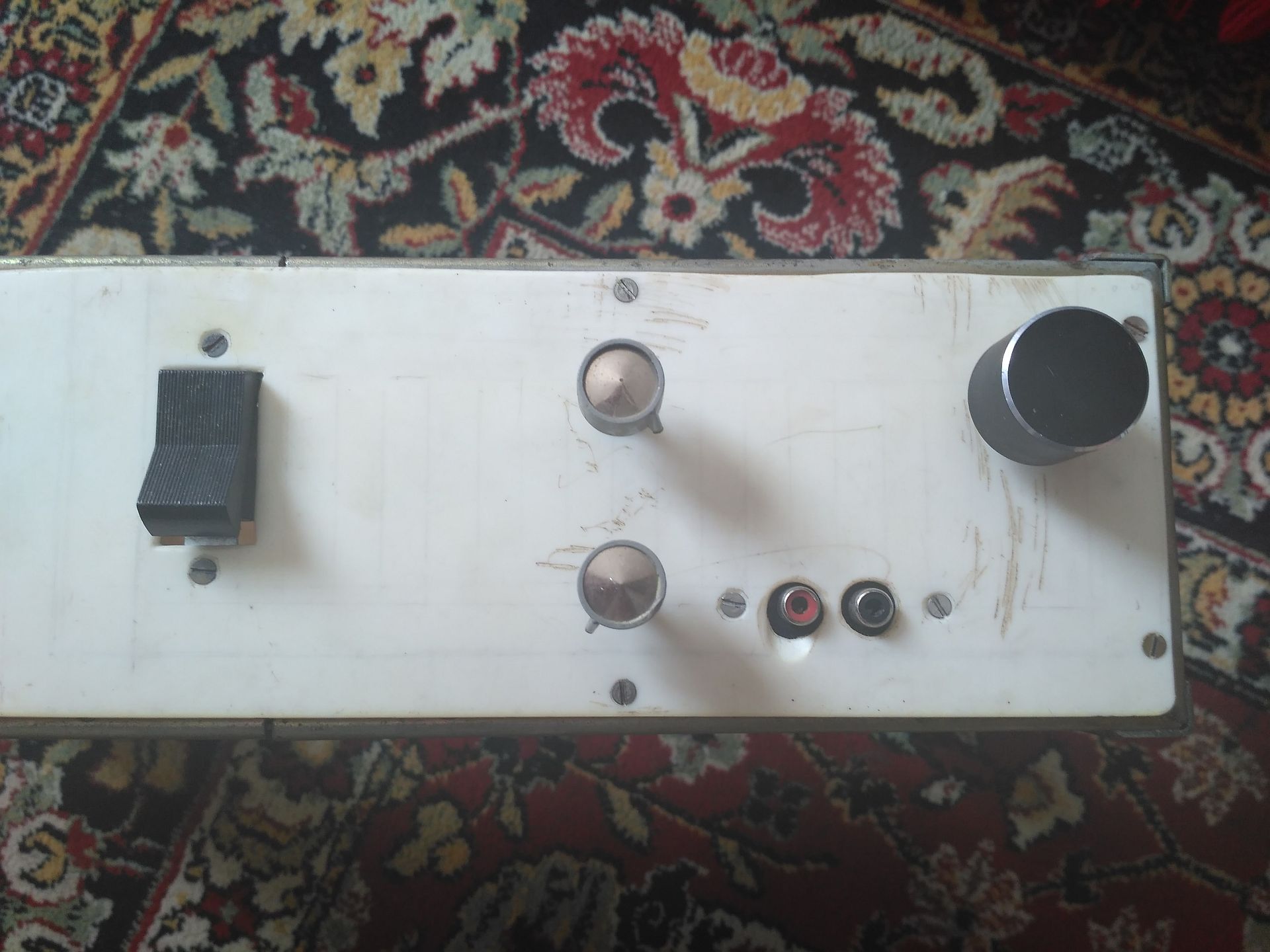

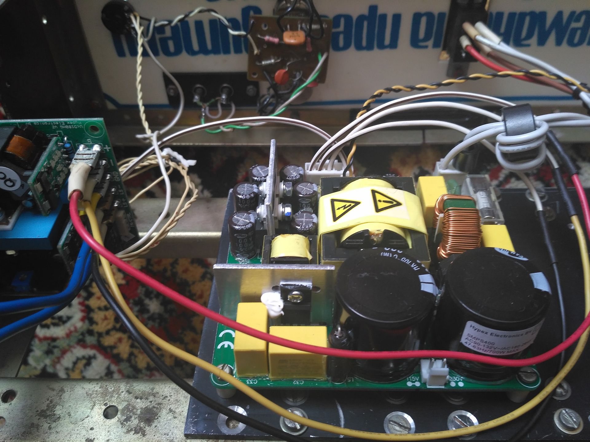

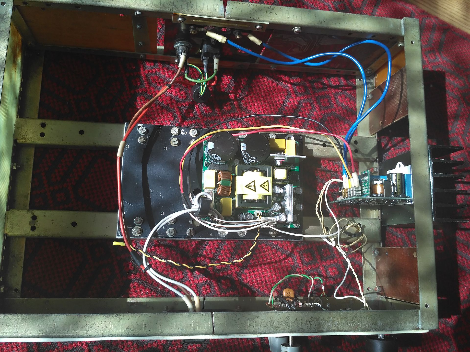

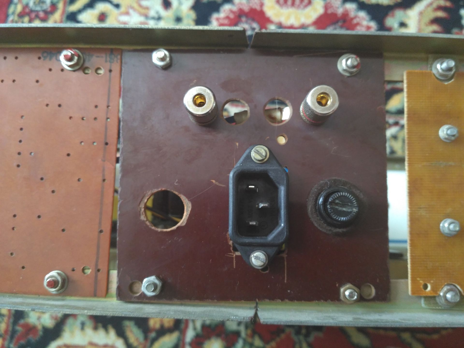

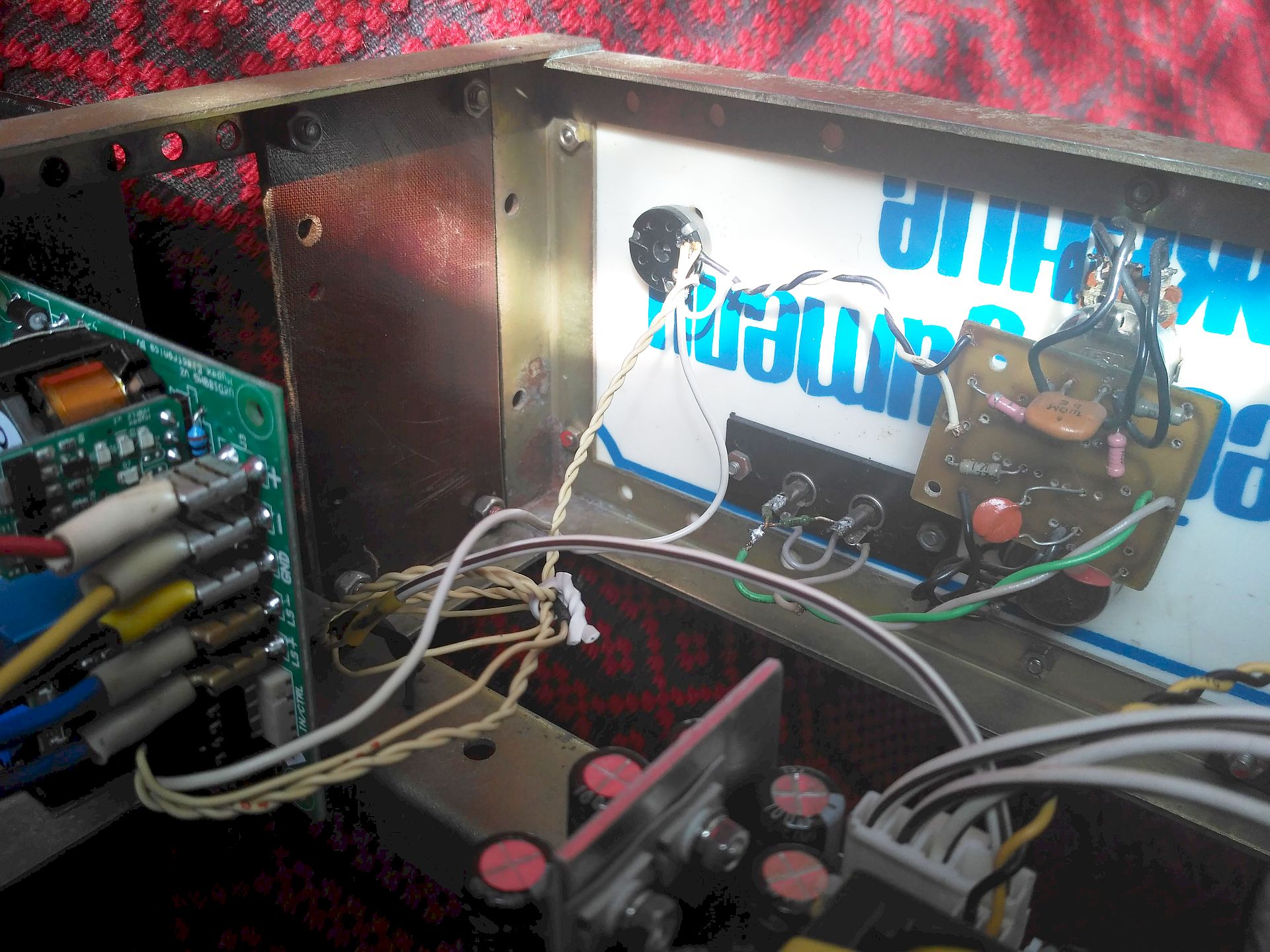

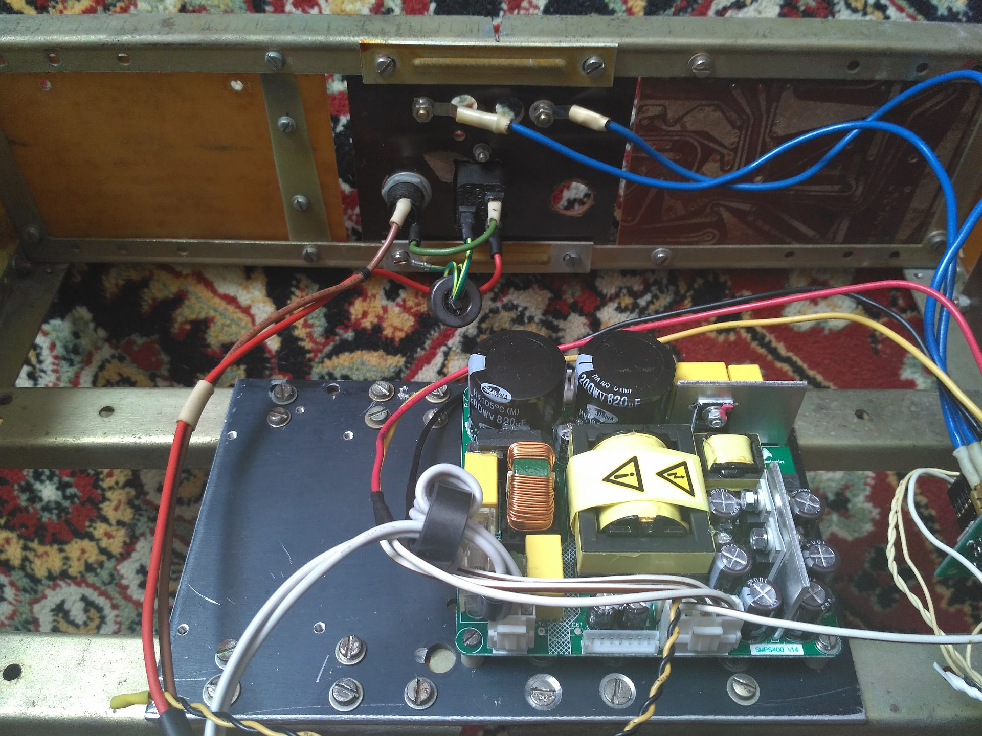

Here is my ugly attempt to draw a schematic of my setup, plus some pictures of my build. I know you will be laughing as it is very primitive, I am okay with that.
(3) "Signal ground should be referenced to the chassis"
I assume this means "connect 'safety earth' from the mains to 'signal GND'", right ?
Because I already have connected "signal GND" from UcD to the "negative pin" from the CHINCH (and to the common pin of potentiometer).

That's only possible if you can competently design and construct a Class 2 double insulated enclosure.
https://www.diyclassd.com/img/upload/doc/an_wp/AN_Amplifier_signal_wiring.pdf
This is the data sheet on the Hypex website that shows how one should connect unbalanced inputs.
Note the mention of how one should Not connect safety earth to chassis and that when this is not connected the amp should be built to double insulation standards
Remember you fitted a conductive stand off to the SMPS. This is decoupling any unwanted signals from the SMPS to chassis. I would make this an insulated stand off and connect the SMPS board tab via a short wire link directly to input power earth keeping any decoupled "rubish" away from chassis.

Connecting signal gnd, which is PSU 0V to safety earth would mean the mains fuse would be more likely to blow if the circuit developed a fault.What if the chassis was all plastic instead of metal - would the above still hold true?
I'm interested to hear how this pans out.
I wouldn't attempt a Class 2 double insulated enclosure.
The OP complains of hiss, not hum - can this be caused through ground loops?
Or perhaps the open frame enclosure is allowing entry to some other source of interference.
We do not know the signal source - if it is battery powered or double insulated then it will not contribute to a ground loop.
Why are a Left & Right input both connected to same channel? Mix down to mono for a sub perhaps?

"That pdf confirms signal ground should be connected to the chassis"
Actually the first PDF which I looked at was https://www.diyclassd.com/img/upload/doc/ucd/ucd180hg/Documentation/UcD180 + SMPS400.pdf
The link from my first message (https://www.diyclassd.com/img/upload/doc/an_wp/AN_Amplifier_signal_wiring.pdf) I actually opened and read about 20 hours later - the moment when I realized my mistake with the "safety earth".
So, if my enclosure was (as it will be after a while) entirely plastic - where should I connect the signal GND ?
"The OP complains of hiss, not hum"
In the beginning, "signal GND" from the UcD was left floating - then there was a hum, really loud. But it disappears when "signal GND" is connected to "signal -" (and both - to the negative pin of the audio source)
After I disconnected the mains "safety eartch" from the enclosure - there is no hiss, so it appears the openness does not contribute to additional interference (even though it is next to the computer on my desk).

The pdf mentions not connecting safety earth to avoid ground loops, that's true but not good advice, it is possible and advisable to use safety earth and avoid ground loops
...but now I am listening from my PC.
Your PC is most probably already connected to "safety earth" so when you introduced a "safety earth" connection to the UCD module you've got a hum caused by a ground loop.
Stick strictly to the Hypex instructions and you will be rewarded for that.
Unbalanced connection - no connection to the safety earth.
Ballanced connection - it depends on the rest of the system. Can be tested either way IMHO.
