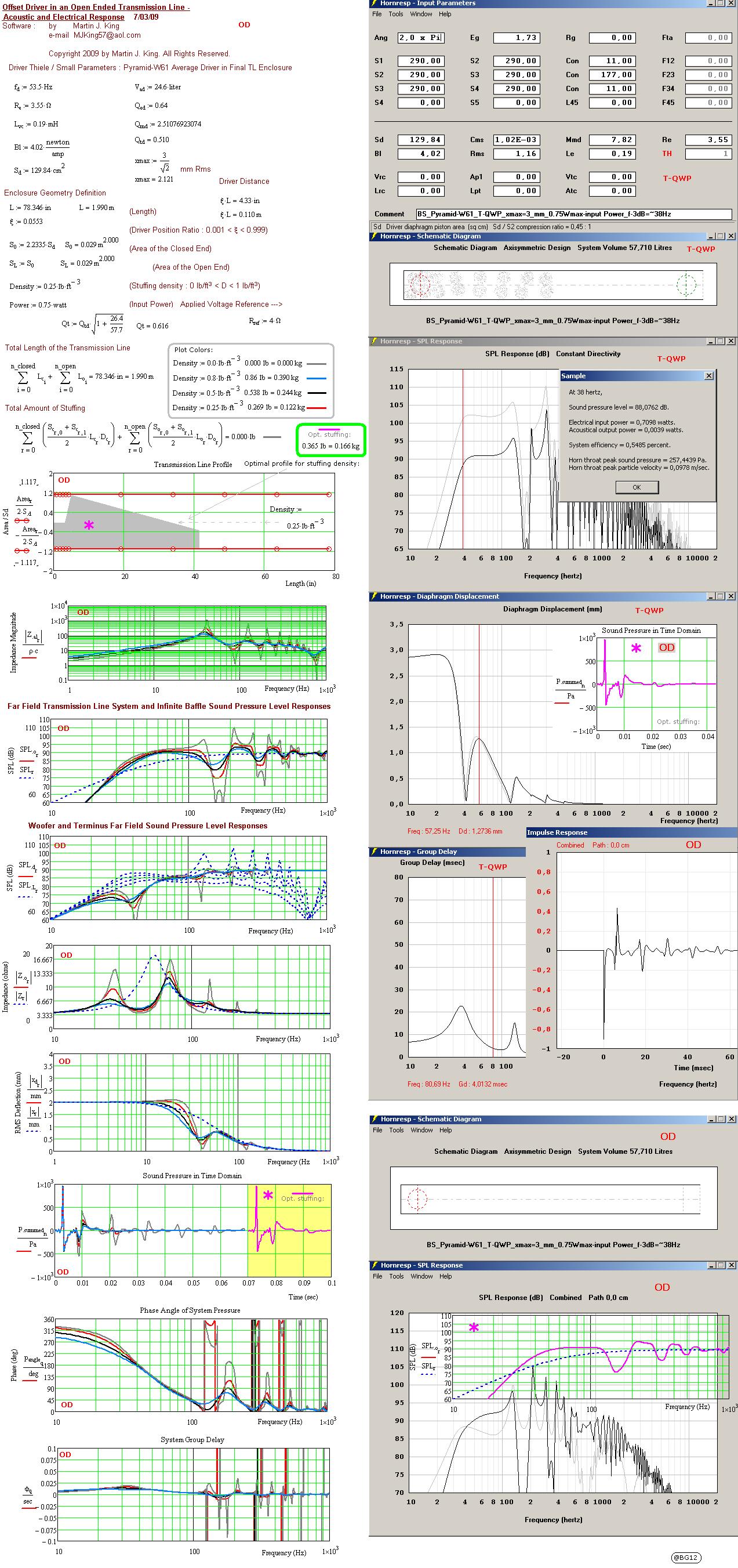

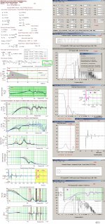

Hi Brian,All
Here is a simulation showing your design of a T-QWP is very sensitive for to much stuffing:
b🙂
