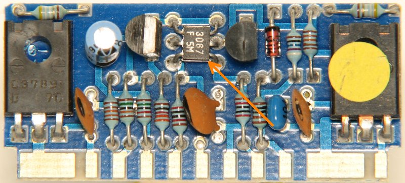

The differential transistors are the 6 or 7 legged devices on the audio driver boards (near the output transistors). The arrow in the attached photo points to the differential transistor. If yours uses the 7-legged transistor, it will be slightly different.

Is there a way to check these with the multimeter?
It's unlikely that the differential transistor is causing the output to be low.

The diff transistor is a source of that 20 milli-volt DC output you got in that one channel < Most likely > Thx Perry for the pic ....
