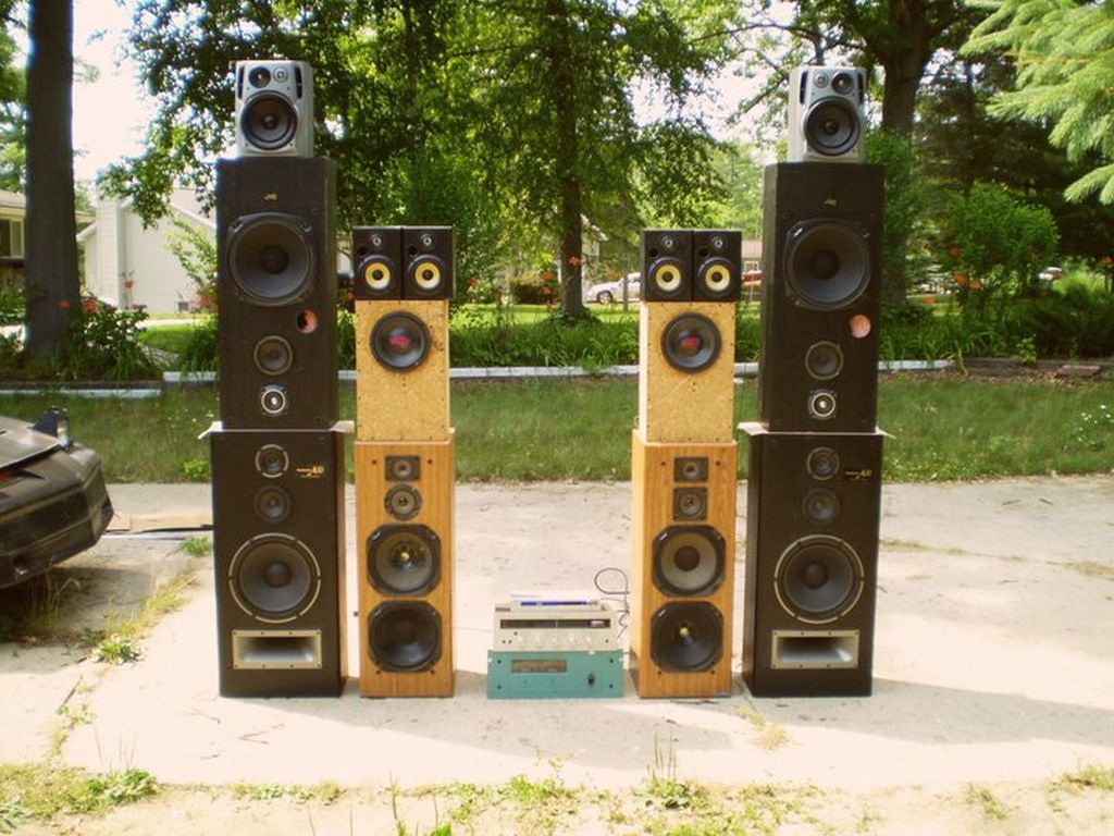

Typically when my big system was working it was fairly flat as it was and it had a great sound with no boomyness what so ever.
But there was just something about when I tweaked them with the EQ's from my Mixing board (Mackie 32-8).
It didn't do a whole lot to make them any flatter as I have tested this with some frequency response sweep tests!!
But the stereo imaging would just hit you in the face in the EQ's were on!!
I suspect that filter settings were doing some thing to correct the group delays of the drivers as I was just using simple 6db crossovers for the tweeter's and midrange's in the system.
I have shown pictures of the system and response charts of it before in these threads as it had 4x10's and 4x12's and 2x8's.
It was nothing special but but a bunch of cabinets that I rebuilt with what I had to move some air.
But the did sound really good until I burned 3 of the 12's one night of rockin' out. He,he,he,he 😕
I had the power to back them as well via Crown DC300a II or a Ashley FTX2000.
The Ashley was to much for them and what took them out eventually.
But, I will get them running again soon with some 12's that are better than the stock ones that I was using.
Just waiting on a good deal from PE to come up. 😉
My point is, I didn't get the chance to find out what it was exactly why the EQ was doing what it did when it change very little to the response of the system as a whole since it was just very small tweaks of 1to2db or so.
It was more about what frequency the sweepable filters were set at more than anything.
If remember correctly it was right around in the range that my crossover frequency's were (I think).
