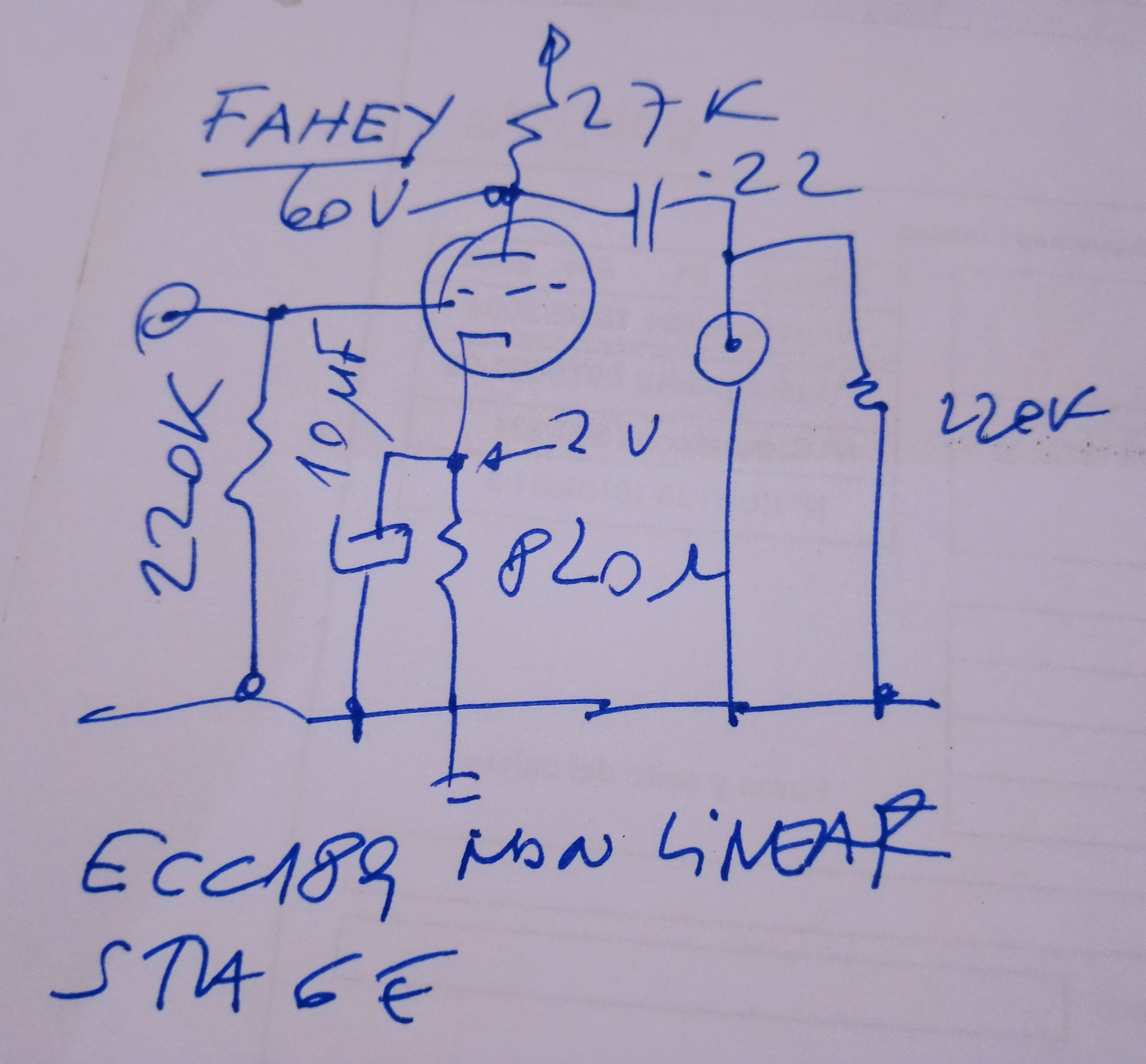

@JMFahey very easy to explain.
The cheapest and fastest way to experiment on adding harmonics in my usual listening systems is a tube preamp.
Then do add a tube stage which actually does something visible (on scope screen), audible, measurable, not just expectation bias fueled "do nothing" ones.
I design and make Guitar amps, and different to generic Audiophiles, Musicians, although also showing some expectation bias, a very Human trait, definitely have well tuned ears , overblown stuff disappears from the Market if not meeting expectations.
This is a gain stage I add to "clean" SS amps, think for Acoustic Guitars, organ, piano, etc.
Even Harmonics by the truckload he he.
Use only ECC189 (or PCC189 with a 7.5V filament supply, DC strongly recommended) and 120-150V +V supply.
Or design your own, all you need is:
For a roughly unity gain, VERY flavoured stage, drive it straight from your DAC and then attenuate output by 10-20X, say 100k-10k attenuator.
If too much of a good thing, remove cathode capacitor and adjust attenuator to get near unity gain.
You will be surprised.
