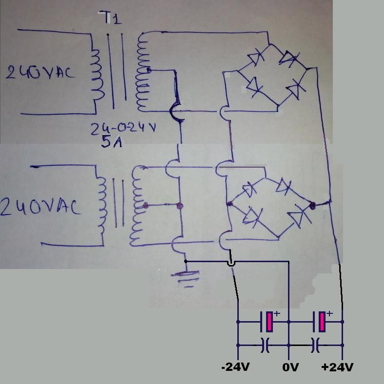

It has come up more times if a dual rail supply can be made with two transformers or if you need more current, can transformers be connected in parallel?
For those interested:
Appended are three figures on how to use two transformers for a single amplifier:
The straight forward parallel connection of primary and secondary windings is not advised. You risk both cross-currents and poor load sharing. In particular if the transformers are not identical, the cross-currents can be a big problem.
The parallel connection of the primary windings and the secondary windings through separate rectifier bridges is acceptable for identical transformers. Cross-currents are avoided by the two rectifier bridges but the load sharing may not be perfect.
Parallel connection of the primary windings and series connection of the secondary windings is “clean” in that each transformer and corresponding secondary winding is concerned with feeding a different supply rail momentarily so they never act in parallel and cannot source one another. This two transformer arrangement mainly has mechanical layout advantages. Electrically, it performs as a single transformer with two secondary windings and double the power (VA) compared to each of the two (identical) transformers.

This arrangement will work properly if, and only if the loads on the + and - supplies are identical: if it is not the case, the transformers will see a DC component, which can lead to a number of problems.
Note that even in the case where the loads look balanced, as in an audio amplifier, this will no more be the case if the amplifier has to handle frequencies < 2*Fmains.
