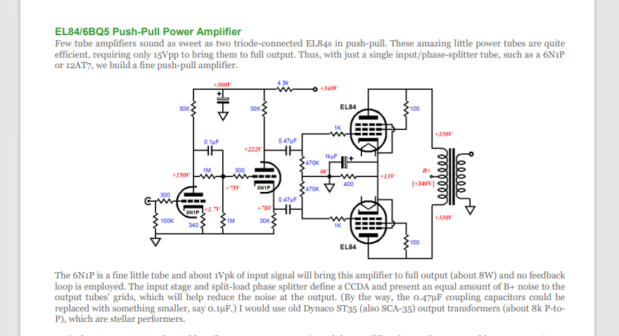

I want to do this experiment on the breadboard to see what happens by modifying the Broski EL84 schematic below, I have this running as is on the bench but want to try things out for fun...
Replace the simple cathodyne Splitter with a high quality Jensen input Transformer to get the split phase. Then follow up each side of the phase with two CF's. The Cathode followers will then drive the output tubes.
So basically use CF's to buffer between a transformer Phase Splitter and the output tubes 6BQ5's. Imagine circuit below with a transformer Splitter instead of a tube and feeding two CF's into each side. The 470k divider would become the secondary load of the transformer. The transformer is 1 : 1.414. I tested this transformer into a virtual ground voltage divider load on the scope and it works nice, so I want to see if it can perform as a splitter basically. No NFB is planned. The 470k will be reduced greatly following nearer the test Circuits loading on the PDF last page.

You won't need much of a CF for this. A 12BH7 will be more than adequate.

The first tube in that circuit has a u of 33. Even if it only has half that much gain, you'll need a transformer with a pretty steep ratio (per side) to replace the tube stage. I don't see how you're going to replace the gain with a 1:1.4 transformer. Are you talking about keeping the first stage and replacing only the splitter half of the tube with a single secondary transformer? That seems like adding one tube and one transformer to accomplish the same thing the circuit already accomplishes. What's the point of that?
My purpose here is to experiment and learn about using a transformer as a Splitter, loading it, maybe using a shunt volume control across the secondary, a no capacitor Amp, etc. Yes and to learn how much gain I really need for my DAC, and if I need to keep the first stage too, etc. I'm not necessarily heading towards an end like an experienced designer would just having fun learning without a simulator. I could just put what I have on the breadboard in a chassis now, but I want to start making my own mistakes!
