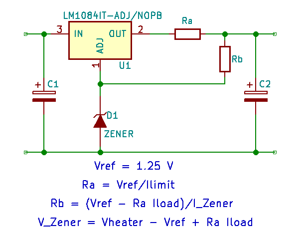

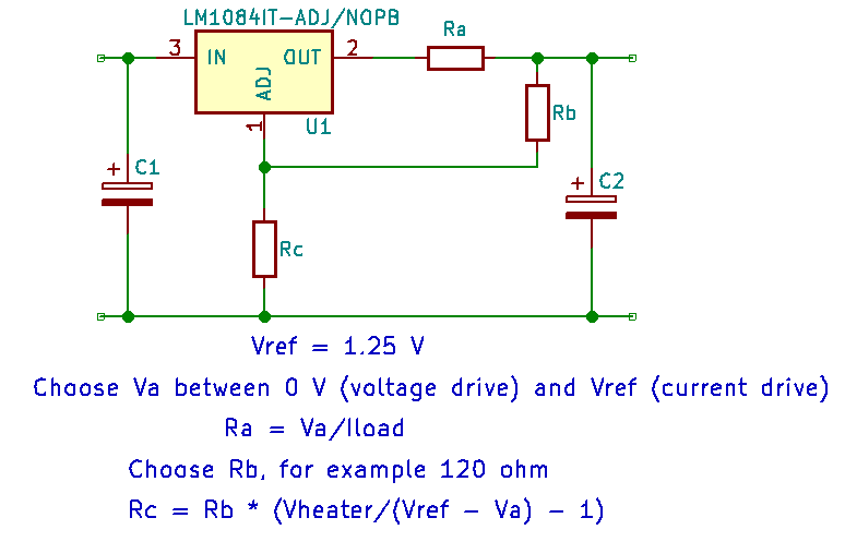

How do I make a voltage regulator with a current limit?
Or is it as simple as using voltage regulator that outputs something over 6.3 volts, then I use a resistor to bring it back down to 6.3 to get a kind of current limiting? Can someone point me to a schematics of how to set up an IC voltage regulator with a current limit? Would that be in the application notes for lets say an LM1084 (1.2-15V / 5A adjustable regulator)?
How do I set the upper current limit with one of these regulators to both stop the inrush and get the other benefit of a predictable temperature through voltage regulation?

Some regulators have an adjustable current limit, but the LM1084 not. There are several workarounds, see the attachments. The one without Zener diode uses a combination of series and shunt feedback to make something in between a voltage and a current source - essentially the same as a series resistor after the regulator, but with less power dissipation.
The one with a Zener should work better than the one without Zener. It makes the voltage between the ADJ pin and ground less dependent on the load current, until the load gets very close to the limit.
