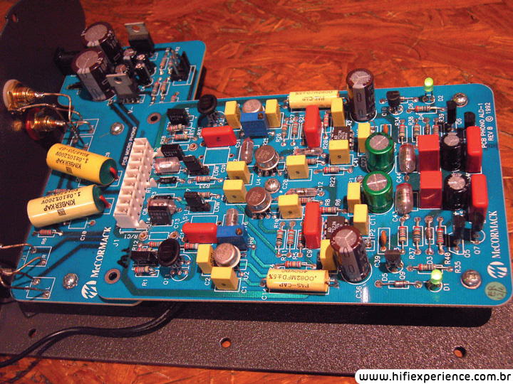

Some images and stuff.
"a hissing noise" is not the transformer, or even the power supply capacitors.
There's always some hiss, universal law of Nature. I am hoping you are not over-reporting it.
After that, hiss in a phono preamp "can" be repeated abuse of the input transistors. Replacement is the fix. Sadly the selection of good LOW hiss parts is in decline.
I personally do not like the look of that 9-pin connector. I would gently lift that board a couple mm and slide it back a few times to work off tarnish on the pins. (Looks like you have to loosen some Phillips head screws.)
