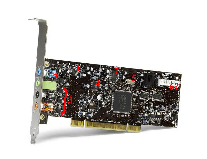

Changing the Op-Amps
This morning I performed a survey of the parts. Of all the op-amps mounted on the PCB...none of them have a slew rate greater than 7V/us! And the headphone output op-amp (JRC4556A) has a slew rate of 3V/us. All other things being equal, (which they are not)...no wonder people complain about the card having a 'sloppy' and or 'lifeless' sound. Am I correct in this assertion? 😕 Compare this to some of the op-amps of choice recommended by Warren Young's 'Notes on Audio Op-Amps', such as the AD8620, with a slew rate
of 50V/us. The recommended Burr-Browns also have similar slew specifications.
I know that surface mount soldering is difficult, but the little pins on these look just-about doable. Assuming I can find one that operates within the 4556A's specs, would it be worth replacing them with better ones? I guess so. Are there any issues I should be aware of?

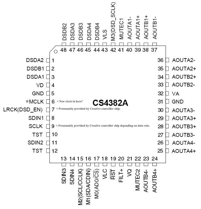

The Cirrus Logic 4382
Apparently this is a fairly decent DAC, though not perfect. The prospect of DAC-stacking this surface mount beastie is certainly beyond my abilities...unless anyone has a technique for such things. The only thing I can think of doing is building a simple clock generator and tapping it into the master clock. Is this the only pin that needs to have the clock fed into it? Or would the creative controller chip need it too? (I know good clocks aren't 'cheap', but anything's probably better than Creative's effort, judging by the choice of op-amps, one can only wonder at the other high-performance components in there! 😉 )
Would I need to desolder the 'master clock' leg? Would this not work happily? Is it feasible?
If it's not, the only thing I can think of is upgrading the crystal itself to a more stable version, though I don't believe that this will result in a lower-jitter signal necessarily because of the oscillator circuit that surrounds it. Am I correct?

The 4556 op-amp is rated for 70mA and is used for driving headphones. If you don't intend to use headphones you could simply bypass it. Replacing the 4558s with AD8620s sounds a good idea, but remember that faster op-amps need better HF decoupling, so you should consider making sure their supply pins are bypassed with small value film caps. Also the DC specs of the 8620s are much better than the stock devices, so you should be able to replace any DC blocking caps with a wire link or solder bridge.
As for the clock, simply remove the crystal and associated resistor/caps and apply the new oscillator.
One thing to keep in mind: simple mods like swapping op-amps are worthwhile, but there comes a point with upgrading sound cards where it becomes more practical to vuild an external DAC. Your decision of course.

With regard to the DAC, they're far less industry-standard than op-amps and so finding a drop-in superior replacement will be very difficult, which is why I thought it best to concentrate on reclocking the beast. We do share the same DAC, though, so at least we can collaborate on this a little, I hope. 🙂
The PCI bus, bog standard, I believe functions on 33Mhz, with various variations. Though I don't think one can seriously 'reclock' the master PCI bus clock!
http://en.wikipedia.org/wiki/PCI
I was hoping to, at some point, simply get a good, clean master clock signal into the DAC...but I don't know if the Creative controller chip will also need to be reclocked.

For the curious, here's the components list of my Live! 24-bit, with a diagram.
ST Microelectronics (ST) 33078 - Low noise op-amp, presumably for microphone input. (#1)
Japan Radio Corp (JRC) 4556A - Headphone (primary) line-out. (#2)
ST Microelectronics (ST) 4558C - Other line-out op-amps. (#3)
Cirrus Logic (CS) 4382 - 24-bit 96kHz DAC. (#4)
Wolfson Microelectronics (WM) 24-bit 96kHz ADC. (#7)
24.576Mhz generic crystal. (#5)
Various regulators, bus buffers, etc.
As for #6...yeah...what is this? 🙂
The question is - does the oscillator only generate the clock for the DAC and ADC, or does it drive the Creative on-board chip as well? Or does it run from the PCI bus clock?
If the former is true, it's going to be hard to find it without a 20+Mhz scope and some time. It's hard to trace a signal on such tiny pins (inside an operating computer, mind).
I presume that the DAC runs on a 24.576Mhz master clock signal, as it's a supported frequency in the data sheet, and the crystal runs at the same speed. Can I simply put a new 24.576Mhz (or other supported speed) master clock signal into the MCLK leg of the DAC (see attatchment) and leave the L/R signalling leg (which presumably comes from the creative controller chip?

demogorgon said:
We do have the option of testing the A V the non A cs4382.
i hear there are differences between pieces with different suffixes on other dac's. worth a shot.
Be careful, see Flecom's post about DAC part numbers. I think that the Cirrus Logic DAC, certainly my CS4382, is rated for SACD decoding (in another mode, it's capable of transforming DSD streams) so I would imagine that the Audigy 2 / Live 24-bit DACs are let down far more by their clocks / output op-amps / power supplies than by their own internal designs.
..but hey, if you have problems getting it done yourselv, postage isn't much over the pond anyways, so perhaps we can work something out. 😉 i have experience with smd soldering, and good equipment.
Lucky! 🙂 Whilst this option is tempting, I have to develop these skills for myself, thanks for the offer.
