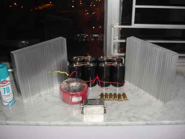

I am a Newbie and planning to build My one Pass amp.
My speaker System as below:
tweeter JBL 075
Mid JBL LE85
Low JBL LE15a
All is 8ohm
I am interesting in SOZ and I have a +-18VAC 1000VA
can use for a 15W SOZ.
But Just 15W can Push the system or not?
my home have about 180sq. ft.
which Pass amp is best choice for me?
Which have Best Low and high freq. Respond?
thanks all!

Build one and find out! You have the transformer anyway.Anthony77 said:But Just 15W can Push the system or not?
Hi Anthony,
Welcome to the forum.😀
Your speakers are pretty efficient. You should get plenty of volume driving them with 15W.
That said here are a few things to think about.
The Zen amp have been accused of being a little light in the bass. You may like to think about bi-ampping using the Zen for the horns.
The transformer you have will work fine for an Aleph 3 as well (a little overkill, but that good). The Aleph will have better PSU ripple rejection then the Zen. This is good particularly if you decide to bi-amp. If you don't bi-amp, the Aleph should provide better bass and 30W of power.

I have 2 Big Heat Sink
350X50X260
How is Max Power i can make My SOZ??
Which Aleph is the Best?
i all so have 2 700VA bi-polar 35VAC Transfromer can make Aleph2
Aleph 3 have 30W, it use 1 pair of IRFP244?
is it enough for my home Area?
some times i like to listen Powerful =)
Aleph 2 is too large power?
I want to Bi-amp to Push.
SOZ to push the tweeter.
I think SOZ is the best for H.freq. in pass amp.
is it right?

Based on your picture, I would recommend an Aleph 3 or 30
with 2 pair of devices a side. The transformer is perfect for
this, and you'll get enough punch for an LE15A

Anthony77
With those things from your picture
at home
I think you need no Christmas Gifts
Happy New Year! 😉

Halofunswe is right! You have toooooo many GREAT transformers.
It seems the opinion around here that a 15 watt SOZ is about as big a size as practical Also around here we tend to do what Nelson tells us to, so I would take his advice, But I suspect he is basing that on the size of your heatsinks, which amazingly are not enough for an Aleph 2. Your drivers are quite efficient, so I agree that you will be OK with smaller amps-even if you listen loud!
Does the SOZ sound the best on high frequencies? I suspect so, what do you others say? It is natural to think of it for use as a high frequency amp.
Check out the X-SOZ thread. It is getting good reviews, and it is easy to convert to "X" either now or later.
Welcome to our wierd world!
