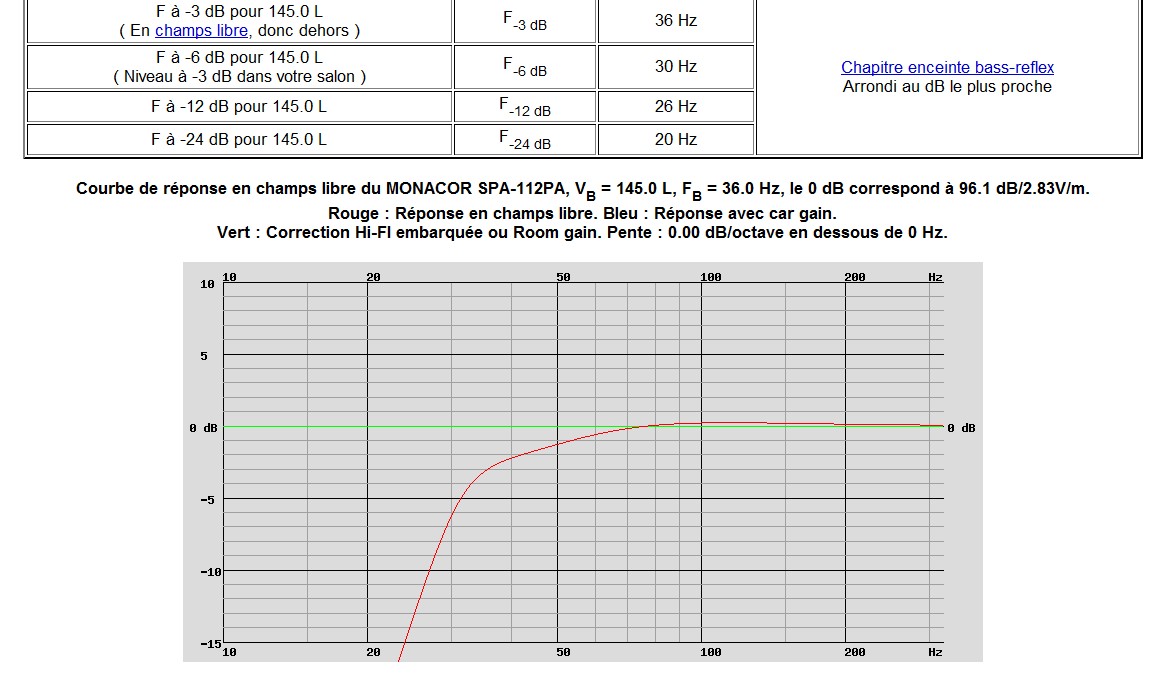

Nice speaker, but not a good performer under 40Hz, in my book... (F-4 dB@40Hz), or a more rounded 145L version with less low freq. extension (F-3 dB@36 Hz) if you look at the roll-off. I know better 10"s doing that LF extension. 😱 Mid looks like is a good performer for that type of pro-sound speaker. Interesting but for me it's back to basics...How about the HiFi-PA speaker from HobbyHiFi? It's a 3-way consisting of Monacor and Celestion drivers...
Monacor Schweiz AG - Lautsprecherchassis: PA-Basslautsprecher (SPA-112PA)
