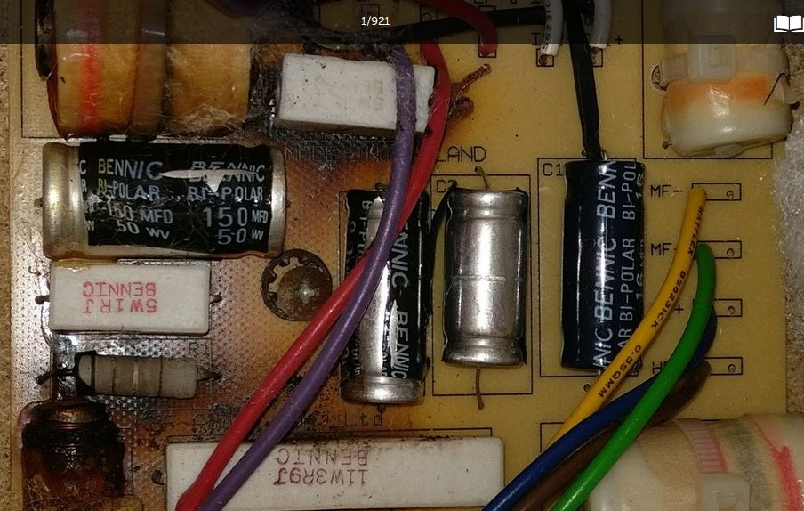

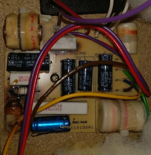

So a bit of an update. I took both speakers apart and got photos of the crossovers and it isn't a pretty sight!
This is the first crossover in which the only thing working is the tweeter. No mid range, and neither LF woofer are working (although both work when driven directly):
This is the crossover of the other speaker. The tweeter AND the LF woofers are working on this, but not mid range at all. This one looks much worse than the other one though which is surprising as the LF is working on this one.
So I'm guessing from looking at these it's gonna be a case of removing and replacing all the resistors, inductors and capacitors?

Probably not. It's well worth it to buy an inexpensive voltmeter to test the resistances and inductors,
since most will be probably ok. If the meter can test capacitors, that's even better.

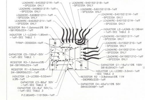

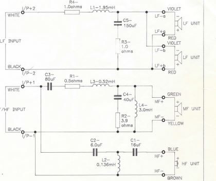

And here is the wiring diagram from KEF themselves...
If possible I'll need some advice on what bits to get to replace. I looked on Farnell today, and struggled to find parts with the same specifications, and I have no idea what I would be able to get away with tolerance wise.

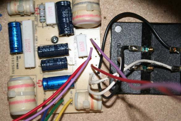

Some progress. This is a pristine crossover:
626687d1500567340-newbie-help-rebuilding-dead-kef-q70-kef-q70-crossover-jpg
I am already quite exhausted. But the pieces of the puzzle are in place. 😎

This doesn't look too bad at all to me. I was expecting the tweeters to have blown if this one has been hammered at parties! 😎
We only have a question mark over one midrange in the Uni-Q drivers. Everything else is doing something so far.
Looks like all the little resistors have cooked, doubtless because they were covered with heat-insulating foam or wadding. It's not the worst thing in the world, because they can act as fuses.
The coils may look terrible, but that should be largely cosmetic. The enamelled wires are likely intact.
This shouldn't be a very expensive repair. Most of these caps and resistors are about a pound a pop. The midrange of the Uni-Q can be tested with a low level music signal direct from the amplifier if you take it out of circuit. As can the basses. But not the tweeter, of course, it needs a filter or will fry.

So stick at it. Eminently repairable. R1 seems to be a 2W metal oxide, and it's become a fuse on the midrange. R4 looks likely to blow as well. And R3 might go too, but will only affect the tonal balance. R2 is a 10W, so I'd be surprised if it went.
626744d1500587470-newbie-help-rebuilding-dead-kef-q70-kef-q70-crossover-schematic-jpg
The caps (and they contain a liquid electrolyte, so don't like high temperatures) seem to have got hot, probably indirectly, but look in poor shape. They age faster when hot. You need to test those mids out of circuit, and I would guess you can figure out which leads go to the mid voicecoil and which to the (fragile) tweeter. You've got enough detail to put it all back together, and that crossover will have to come out anyway.
FWIW, it's often bad to test a crossover and broken drivers which are open circuit. The impedance gets a bit resonant and can stress an amp. But I get the feeling KEF have used those little resistors as fuses anyway. Which is clever.
