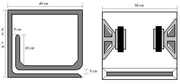

This is my first project, I'm buliding a sub-woofer box to fit my 2 new 10" 175rms watt 8ohm in it. This design is truely simple, space saving. Please give your comment or advice for my first project.

To start with, you need a divider in the box to separate the left and right woofers. Think in terms of two boxes which happen to be attached to each other.
